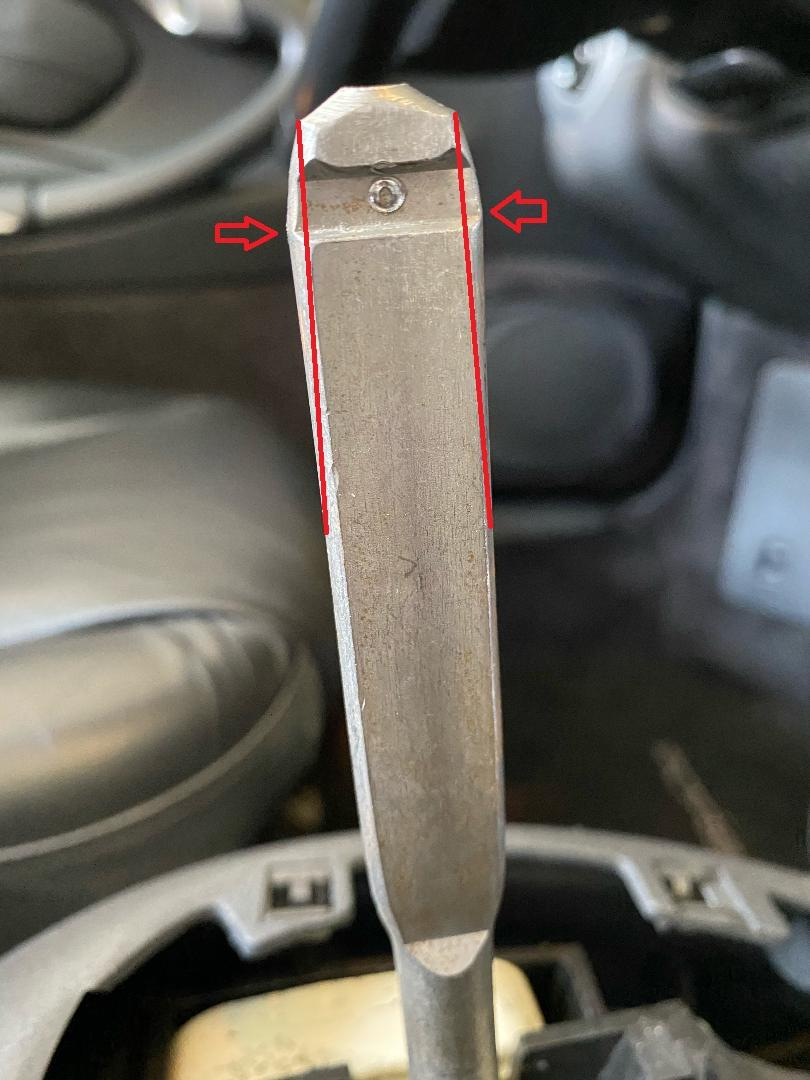

The issue is not the design itself. We can not make the inside portion of the adapter any bigger as it will then be too large for 996s that do not suffer from the extra flashing that Phillip has, or all of the 997 model line. If the adapter was machined to be bigger, it will then be loose and cause excess front and rear play. Unfortunately, for Phillip and d some others, this does happen from time-to-time, and it's not every single 996 that suffers from the extra material from the factory forging. We used our own 996 to design and test fit the ****, and did not have this issue; same with the 997 we used as a test vehicle. It would be unreasonable to test fit every single 996 to know this was going to happen. Generally, with large scale manufacturers like Porsche, there wouldn't be any differences in parts like this, but there are.
The process to make this work, is rather simple. Filing down of the shifter only takes approximately 5-10 mins, and it doesn't take away from the integrity of the lever; and if you want to go back to a stock shift kn-b in the future, you are able to do so. This was all explained to Phillip and I included pictures of what needed to be done. As with aftermarket parts, not everything is a straight bolt-on. Sometimes, you have to massage items to get it to fit perfectly. I have attached the picture so you can see. You don't have to file it all the way straight, but these are the two parts of the extra flashing that need a little filing down. Once again, real simple to do.
