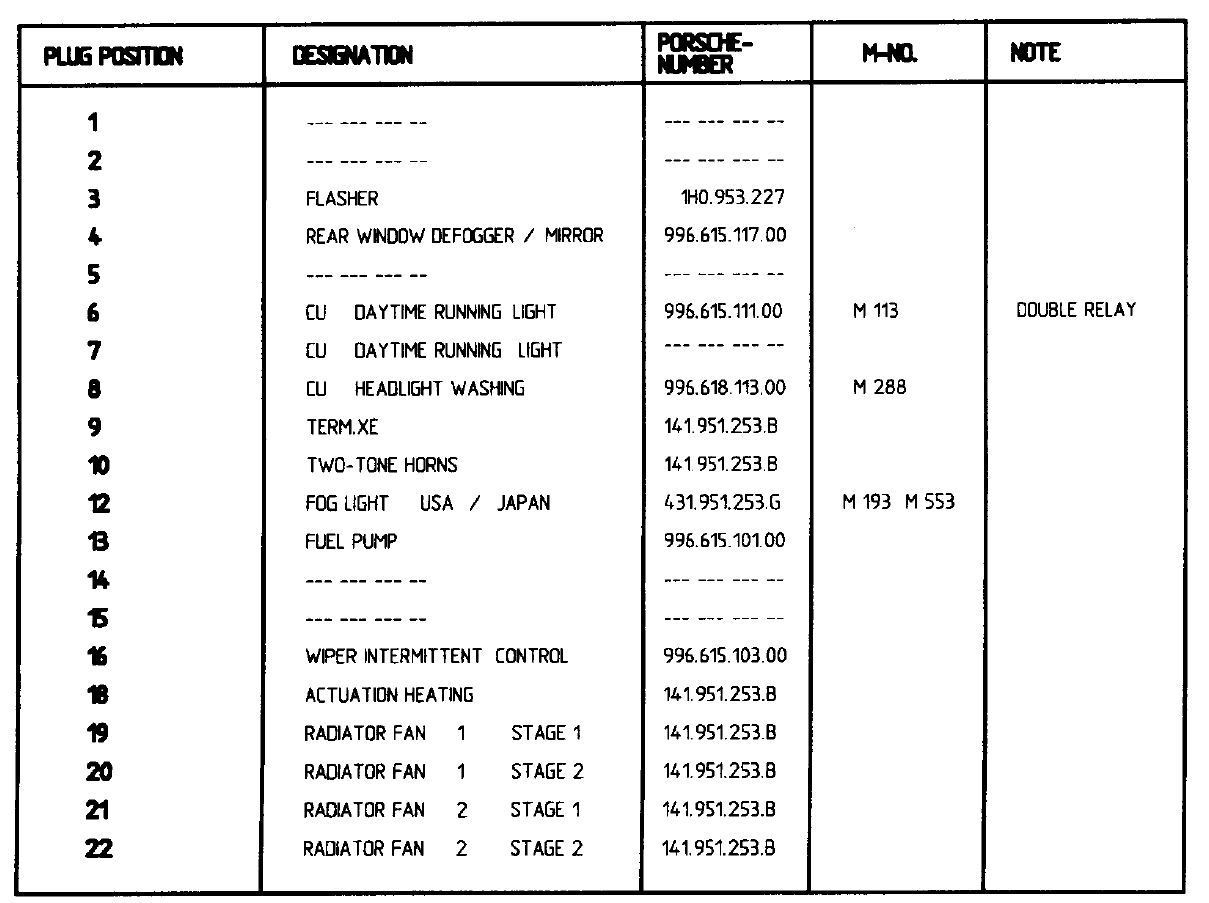

DBJoe996's Avatar
DBJoe996
Joined: Apr 2010
Posts: 6,288
Likes: 1,516
From: Ormond Beach, FL
Located under the dash drivers side.

Originally Posted by jim010
If you are willing to play with the relays under the dash, you cold also use a jumper wire to test the fans. I can post how to do this when I get home.
OK, so you can take a wire and attach it to pin 85 on the relay to the fan. The other end of the wire, all you need to do is to touch it to a metal part of the dash to ground it. This will turn the fan on. You can check the high speed and low speed of both fans this way to check that they are working. The relays are 19, 20, 21 and 22.
I see that DBJoe996 posted a diagram of the relay box. Its really easy to access the relays and identify them when you are down there. They are above the fusebox. on the driver's side.
