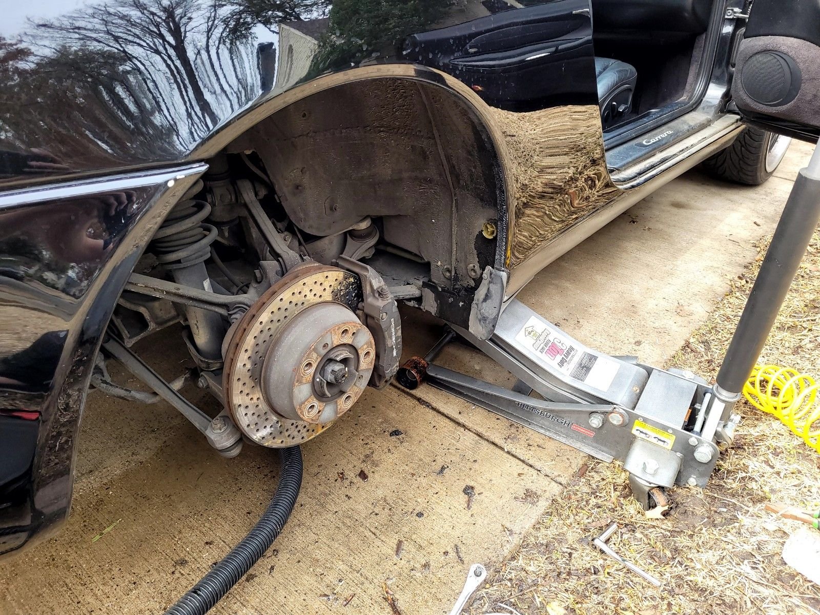

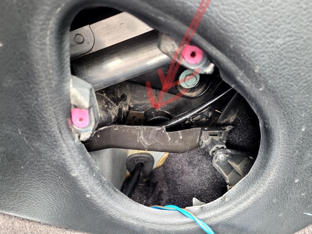

I owe you guys an update. Hopefully this helps someone else. I noticed that some water was pooling in the drain tray, pictured in the red arrows. I tried a thousand different things it drained slowly I ultimately took it to a mechanic who said they cleared out all the lines, this is a European service center who says they have a Porsche guy. Still was leaking took it to a top specialist who came recommended from the community here he thought it could be the middle window seal of the top. Ultimately no it was a clogged drain and the mechanic just never looked at it. And lied to me obviously.

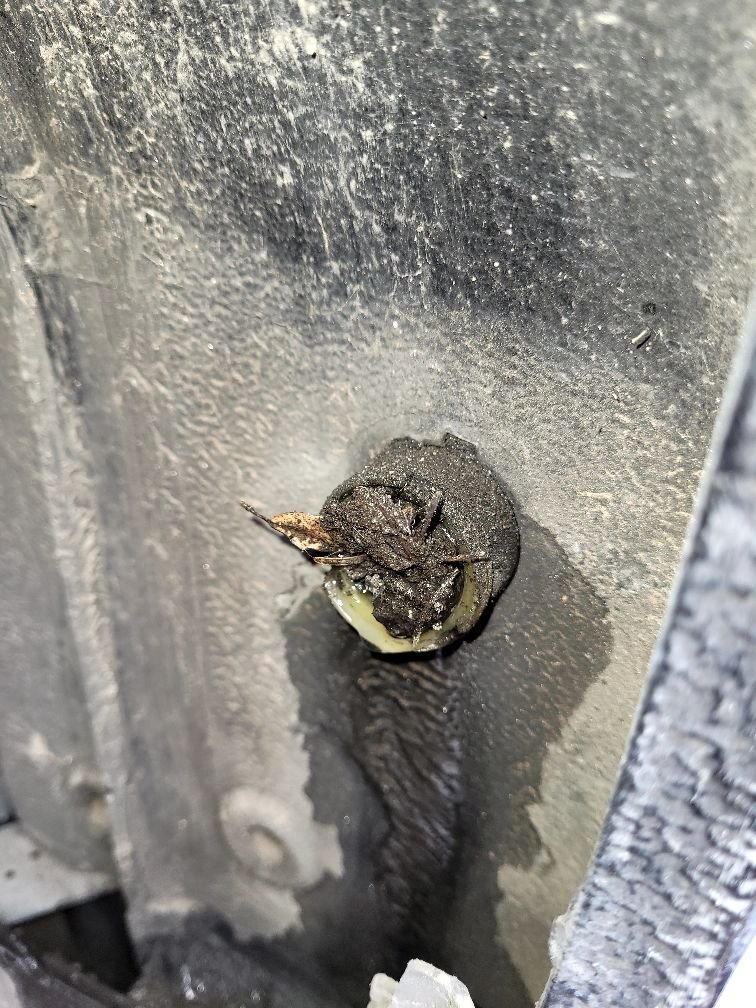

From the top I tried everything, compressed air, clothes hangers, boriscope, you just can't get through all the twists and turns. So I took the wheel off took the fender cover off which is only 3 plastic nuts and super easy. Then I found the obvious obstruction. Water's flowing nicely now Big rain this week will find out if it worked for sure.

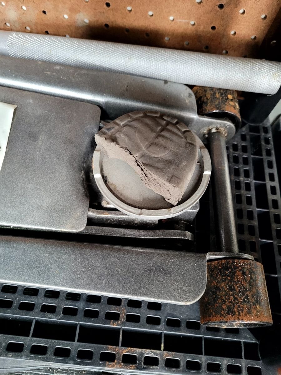

Thanks for the all the input! In the end I had the data just needed to stop pussyfooting around and get the jack out. (Oh I didn't have a jack spacer, never bought a hockey puck, took a hack saw to some old shrunken croc shoes and made a great one).
