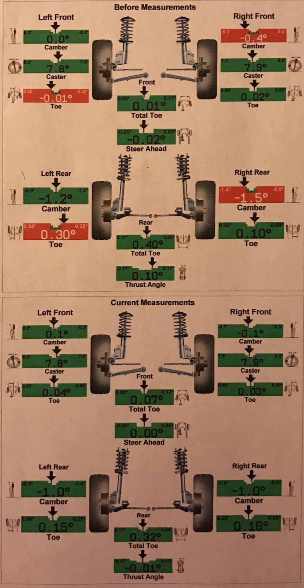

Before and after specs on my 99C2. My setup maximizes tire life, but to be honest, the car still handles very well, even on the track. I have no complaints, and I have racked up 16,000 miles on my Michelins and they still have lots of life left.

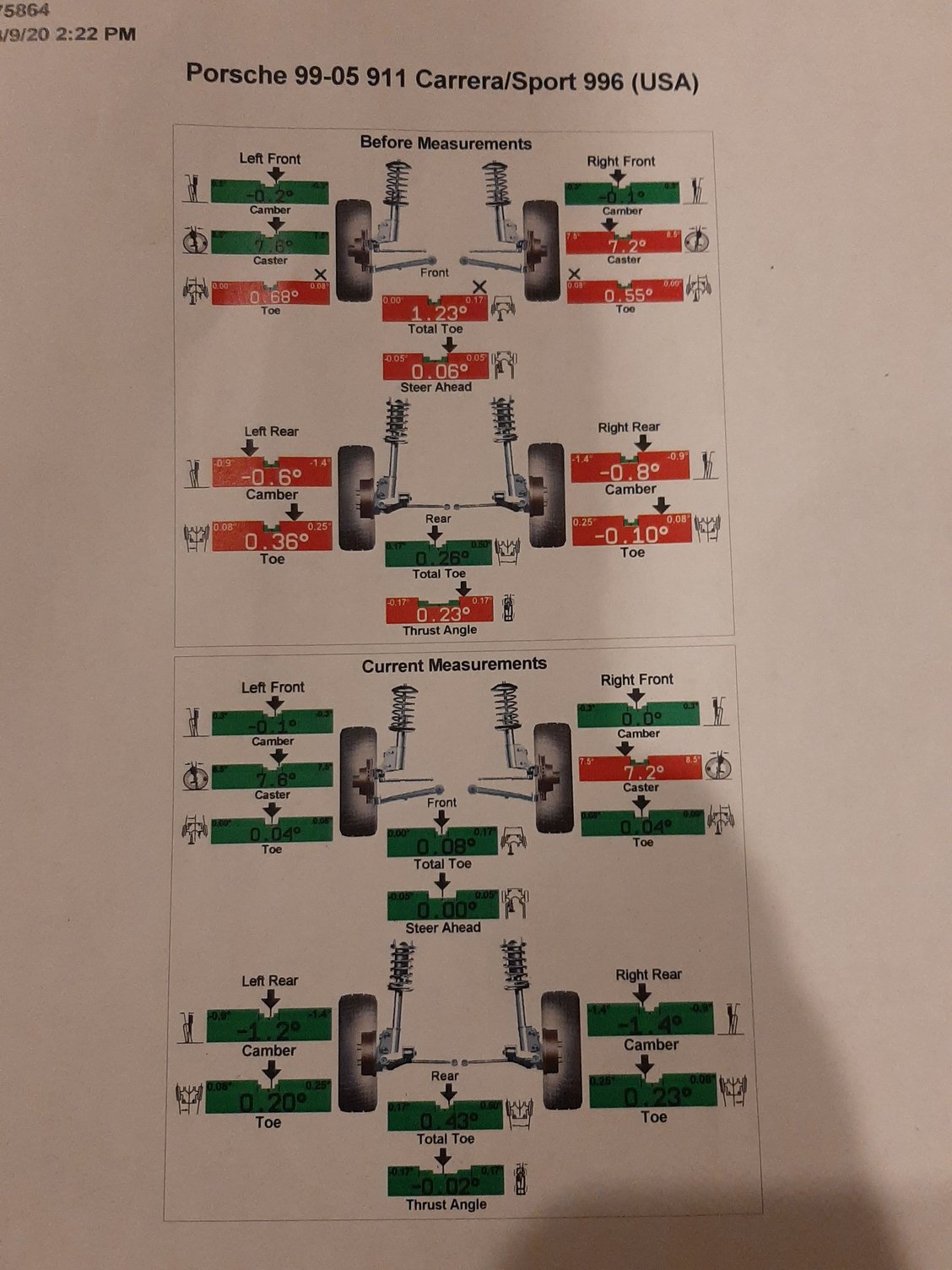

So after wrestling with the A arms, the new suspension is installed and the car has a fresh alignment. I'd like some feedback of the specs. The right front caster is out a few hundredths. I voiced my uneducated concerns to the tech/senior tech (shop owner) about the caster still being in the red. As my car routinely sees speeds over 130mph, a stable, predictable and safe car/alignment, are paramount.
after an explanation of the numbers, I was assured that these numbers are acceptable. The tech said that due to the roads crest, its preferred to have the higher caster on the left front, but the current setting shouldn't affect the car as is. The work is warranted for two weeks, and if I need an adjustment, theres no additional charge.
I was told that the car either has its caster maxed on that side, or there isn't any additional adjustment and that the other option would be to split the difference side to side. Alignment and mount/balance are the only things I take cars to shops for, (outside warranty work), so I'm unsure if this is smoke being blown or not. The shop is reputable and I've used them before when having a car set to a specific spec, with great results. Seeing red has me nervous though.
consensus?

Old Mar 9, 2020 | 06:19 PM
JTT's Avatar
JTT
Joined: Jul 2015
Posts: 2,180
Likes: 360
From: Halifax, NS. Canada
Unless you have a GT3, or aftermarket parts, caster is not adjustable on these cars as far as I know.

Thanks. I didn't know that. does the rest of the numbers look "good"? I regret not having my tire pressure's set high, when I got the alignment done. My pressures are 36F 40R. Not sure if this negatively impacted the results. Overall, the car feels better, and the new struts/springs are much better (not to mention safer).
