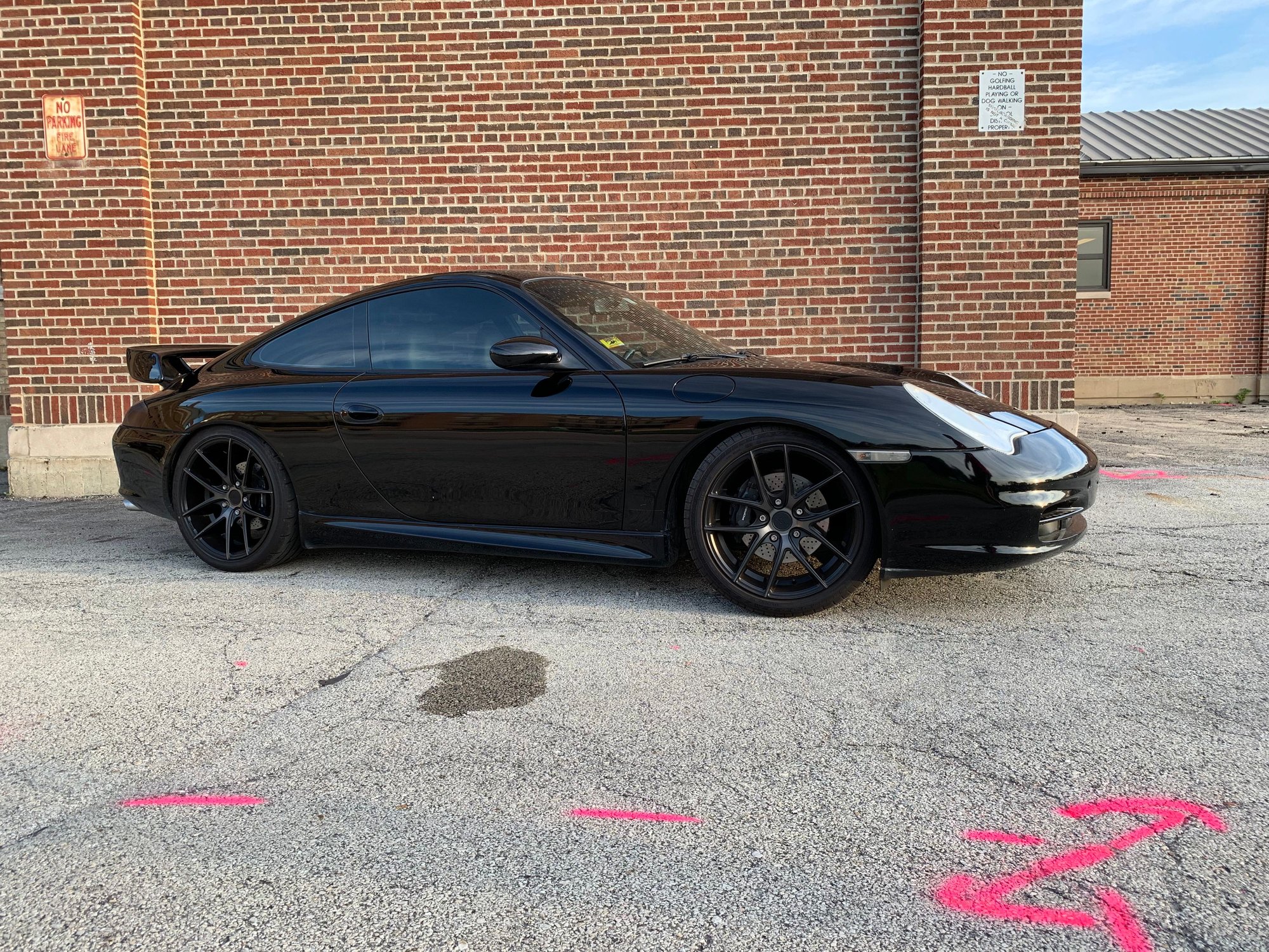

Thanks for all the info. I hate it that the car turned out to be toast as the guy dropped a ton of money in the engine and this would have been a sleeper. Well at least I still have my other 996. Here’s a pic of it. I need to swap out the suspension as it was lowered and it rubs the inner wheel wells. I’ll start looking at coil overs and other possible options. Here’s the new toy and the 944 I just sold.
Looks like part of your problem is running 19" wheels. What are the widths? I'd try 18" wheels instead.
