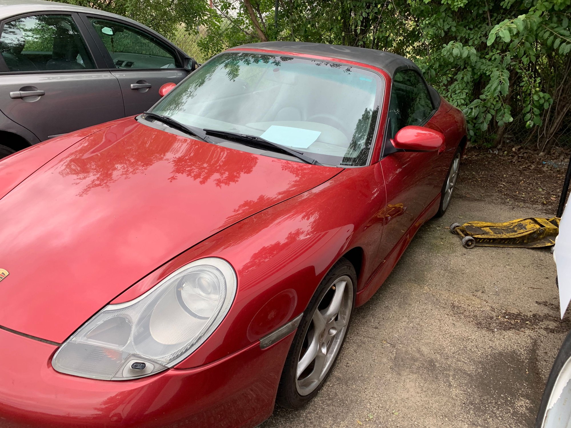

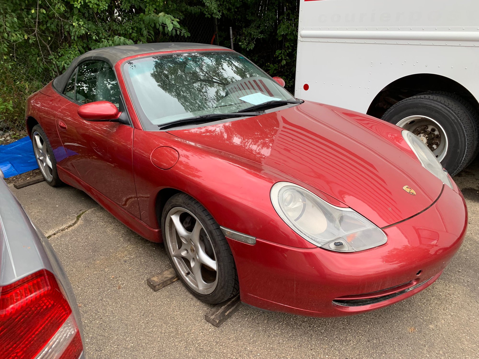

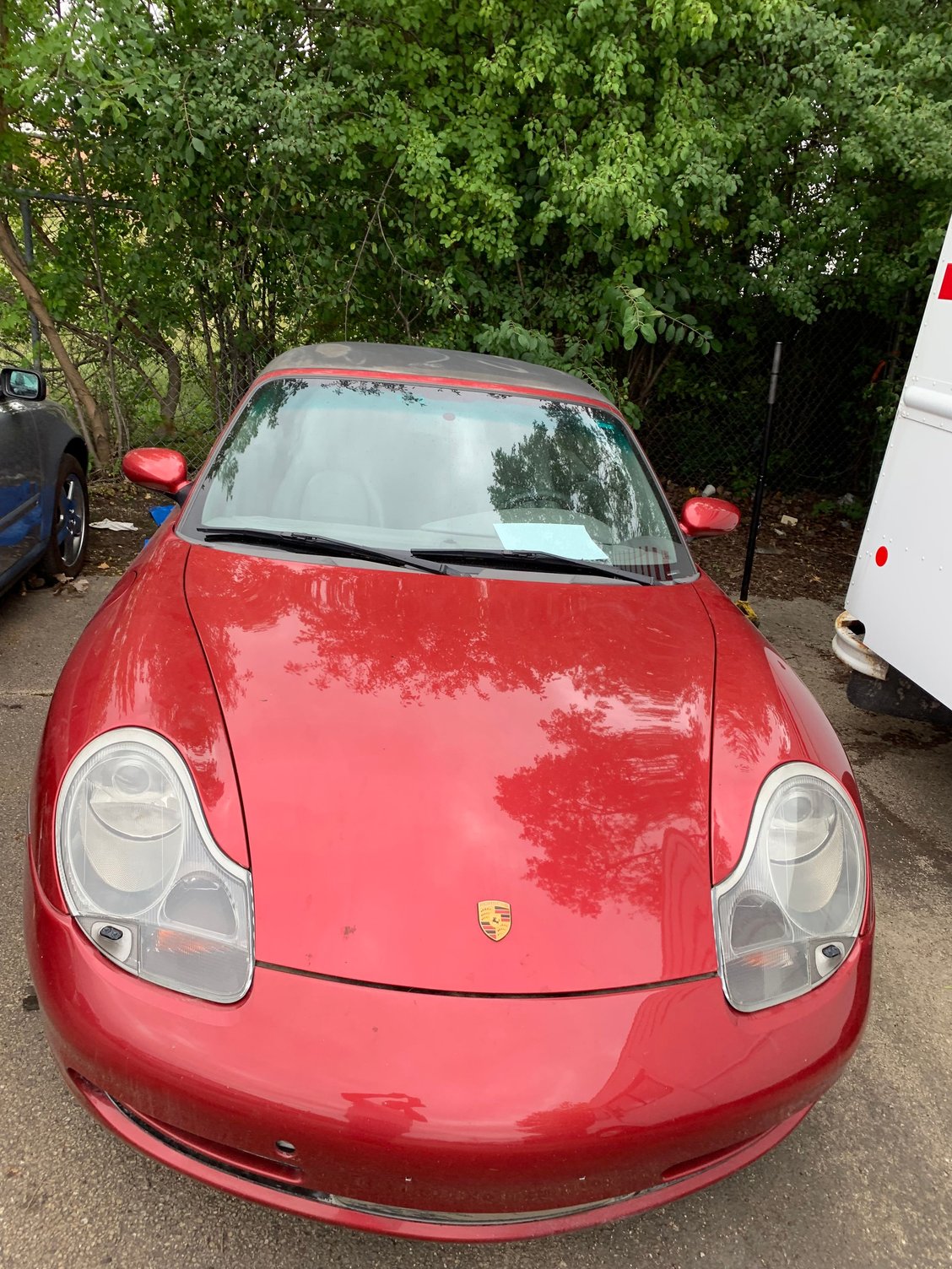

I can’t get any other answers as. I have tried reach the past owner and his mechanic. The car is still for sale and while I was hoping it would be an easy fix with adding a trans I can’t believe what I’ve been told. Why would they put on the housing and claim they tried another transmission? The guy who has the car now won’t take less than $8,600 as that’s what he has in it. After putting a motor in you would be upside down in the car. If someone has a motor and trans, this could be a decent buy as the car only had 54000 miles and everything works except the radio and the engi
ne
