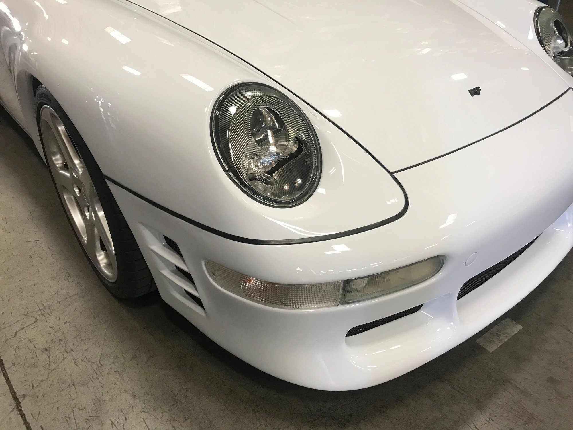

Here is the RUF seal install, Proud.
I like this look better.
