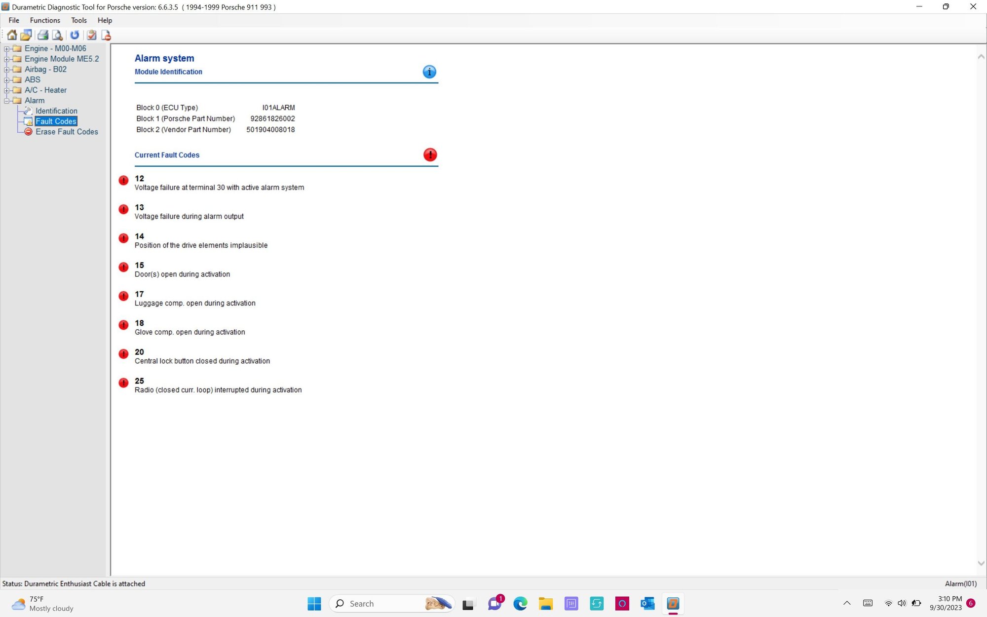

A Durametric scan shows the following fault codes (see below) in the alarm system. The alarm warning light flashes continuously on the clock and the Master Warning Light (!) comes on. All doors, windows, trunk lid, and glove box were closed during the scan.
Here is the interesting part: The alarm system functions completely normally (as far as I can tell) and the car locks, unlocks, and starts with no issues. I do have an Immo-Block installed, which also works perfectly.
In the meantime, I have removed the warning bulb from the clock and have been clearing the (!) with master switch on the center console.
Any thoughts?

Originally Posted by jay@EZimmoblock.com
You might have gotten off on the wrong track looking for problems with the Alarm Control Unit (ACU) -- if by "alarm warning light" you mean the immobilizer light (at 4'oclock), that's telling you the immobilizer has a problem, not the ACU.
I do mean the immobilizer light is flashing.
Have you tried clearing the ACU faults to see if they come back? They might be from an old fault that's no longer active.
I have cleared the codes and they immediately come back. After clearing the faults, I then get a message Durametric cannot communicate with the module. Odd...
What you have is strange indeed: 3 modules (ACU, IMMO and Central Informer), all reporting "errors" that don't seem to be affecting the car in any way. The other thing that's odd is that when the central warning light goes on, my understanding is it's accompanied by another warning light telling you the specific fault, but all you have is the CWL. These three modules are separate and perform unrelated functions: The ACU monitors anti-theft-related things (doors, radio, glovebox, etc), the CI monitors critical vehicle faults (brake pressure, fuel, airbag, etc) and the IMMO gives permission to start. Hard to come up with one thing that could suddenly (and simultaneously?) affect all of them this way. Each even has a separate chassis ground. the only thing common to all of them is ignition 12v (Terminal 15). Maybe slap a meter on it and see if you see anything unusual?
Thanks, Jay. To be clear, the immobilizer light does flash when the CWL is on. Once I clear the CWL light with the switch on the center console, it stays off and the immobilizer light continues to flash. For now, at least, I have removed the bulb for the immobilizer warning. I will check the battery voltage. I have a meter which plugs into the cigarette lighter I can use.

The Durametric system is unable to clear the fault codes indeed, all these codes would not appear instantly, and at the exact same time.

Originally Posted by SpeedyC2
OK, I see what you are saying now. I am not seeing faults with the airbag module, and I have confirmed there is a bulb in the airbag warning indicator location. I have not swapped the bulb out with a known working bulb but will do so. I might have time tomorrow morning to check this out and re-scan and will report back.
Make sure ALL warning lamps are present and good. You could actually have a REAL CI fault but a blown lamp is masking the source.
I do not think I can clear the ACU flags. When I try to clear them, Durametric seems to get a bit confused and gives me a message it cannot communicate with the module. If I then disconnect the OBD cable and restart the process, and I can access the ACU module and see the flags again. Most likely they are not clearing, but I guess they could also be immediately resetting.
This might just be Durametric thing and what you're seeing are old, inactive ACU flags that you can't clear, i.e., a "problem" you can probably ignore for the moment.
