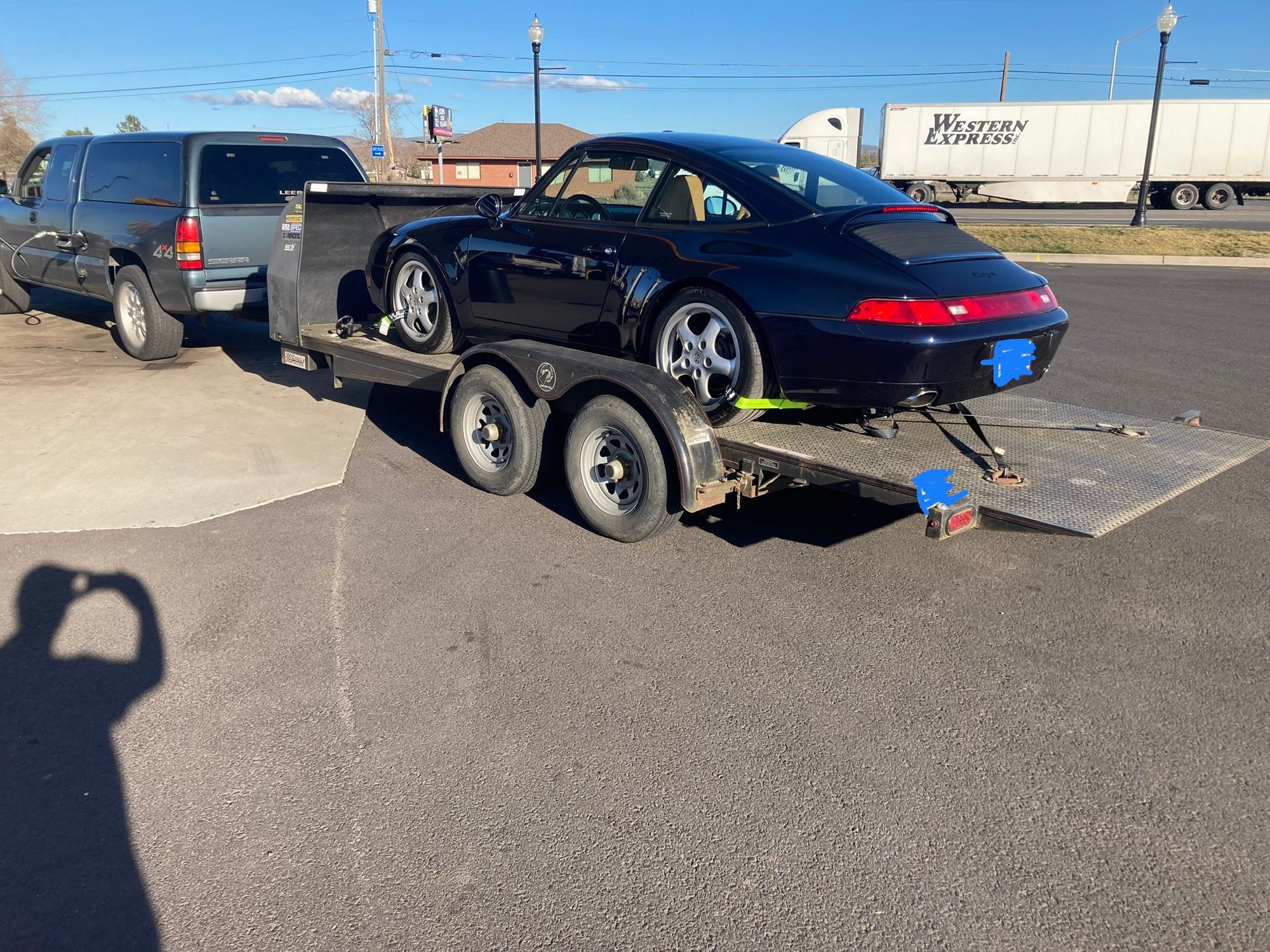

Basket handle third brake light on a 96? Targa?

It's a targa
