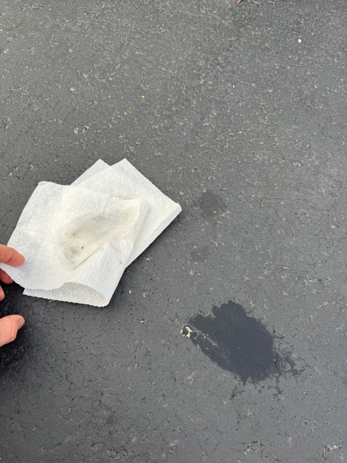

Old Feb 25, 2025 | 10:23 AM
L76's Avatar
L76
Joined: May 2018
Posts: 690
Likes: 248
From: Las Vegas, NV
Originally Posted by Vitruvian_man
Curious about this so I did some googling and found this thread
https://rennlist.com/forums/996-turb...er-of-car.html
can you get some of the fluid on to a white paper towel, toilet paper, tissue so we can see if there is any color to it?
also, can you let us know what trim you have, year, and milage?
Definitely water. Paper towel pix attached. 20k miles on the 2023 992.1 Turbo S Coupe. Daily Driver. I am suspecting blocked A/C drain plugged up and/or windshield water drain gulleys plugged up. I will take pics and document what I find.
Thanks guys.
L76

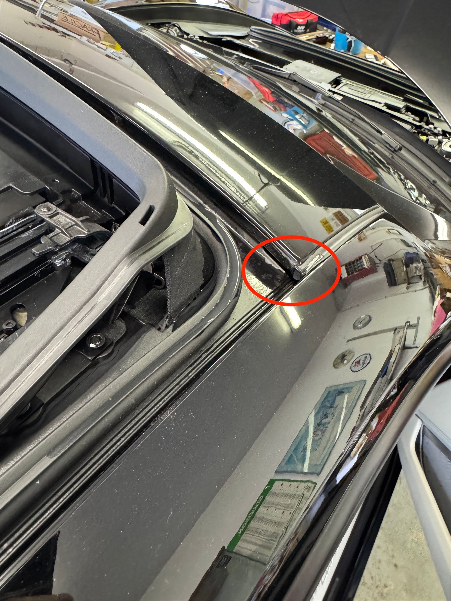

Old Feb 28, 2025 | 11:00 AM
L76's Avatar
L76
Joined: May 2018
Posts: 690
Likes: 248
From: Las Vegas, NV
Ran a test... just clogged drains. Water was from windshield runoff drains.
My TEST:
1. Removed underbody panel and noted drip locations.
2. Extensive inspection - main drip location was radiator hose (low point/capillary action led the water here); verified that the drips were water. No sign of coolant leaks nor engine/drive train fluid leaks.
3. Removed frunk battery cover panel near windshield.
4. Poured warm soapy water onto windshield near rain runoff drains... video'd the water flow and found that the test water eventually went right to the radiator hose where the drips were located. Sir Isaac Netwon's Law of Porsche drips confirmed. Poured warm soapy water into sunroof drain channels. Ran same video observation. Sunroof water drains at bottom of doors, so unrelated to my drips... confirmed the source was the windshield drains.
5. Used compressed air and towels to dry everything off... and ran the test a second time. Same results.
Pics/short video attached. All good!
