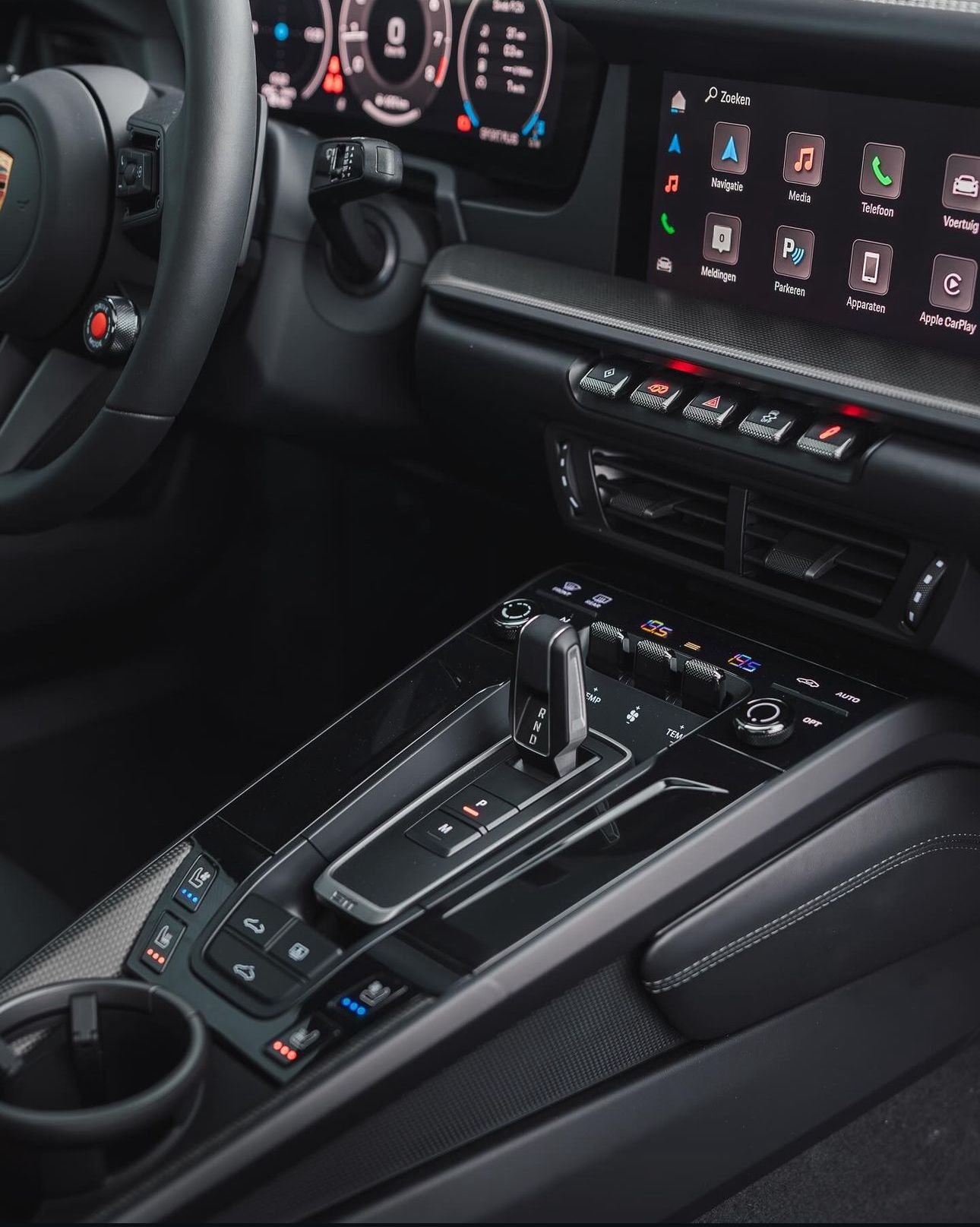

What buttons does it show on the dash if you didn’t get the PSE option?

Blank programable button.

Depends on how you spec the car... I have the front axle lift, so I only have one diamond programmable button.

I have a TTS incoming and didn’t get the PSE so I can retain the quad exhaust look. I’m planning to add the PSE via programming and curious if I can replace one of the programmable buttons with the factory PSE button.

I have done the PSE programming on all 2 of my 992s that I opted to get the quad exhaust (2 targas).. My first 992 in 2020 had PSE. It is about 70-80% of the sound, and I also like the look of the quads better.
There is one downside that I have found with the programming of the PSE, and it is minor but worth noting. If you have two blank programable buttons on the front area selection, you will only be able to program one of those for PSE, the other will not be able to be programmed. In the case you have FAL and only one, you will have no problem as the one can be programed for PSE or whatever you want.
For those with two "open" buttons you can only program one. The other one becomes a pseudo dead button each time you press it will ask you to program, but if you do it will override the other button. So you can replace the button with a PSE symbol button, but the other is non-programmable (ie. will override the other one). I am sure there is some hardcode somewhere in the programming where you have to hard code a switch to let it use both programmable buttons independently, but once you enable PSE it seems to allow only one.
With that said, I did not program the PSE switch on either of the control buttons, as I turn mine to sport when I get in, so just like a normal PSE exhaust it turns on the PSE exhaust automatically - just like it does with the PSE.
I ended up using the second button as surround view and the open one on the steering wheel as my homelink. The first one I just don't touch as if you do, it will have the pop up message that ask you to select a command. Which if you do, that now becomes the command for that button and you loose whatever was programmed in the second (if that makes sense).

Mine had two diamonds. I added the sports exhaust muffler and changed out the switch assy because one of the diamonds became inoperable after coding for sports exhaust. Now has one diamond programed for my garage door and the sports exhaust switch.

Base 2024 C2. No PSE. No Sport Chrono. No programable buttons on dash. Buttons are factory allocated to Wet Mode, Sport, PASM, and PSM. Programmable diamond button on steering wheel. I use it for Surrond View.
