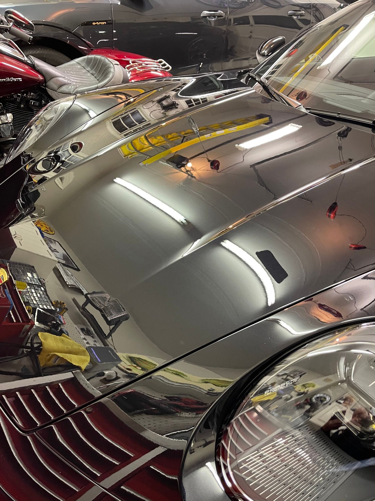

Don't get hung up on "paint correction", it's really just going over the car with a polish and getting the surface squeaky clean prior to the ceramic coating. You want all impurities out of the paint, really no difference than a proper wax job. I have Ceramic coating on my wife's Macan S and my Audi E-Tron (both of which I did myself), because they clean up so much easier with it. For my 992, I will still stay with the Swissvax system. It won't last as long, but leaves a "warmer" look than ceramic coating in my opinion - a richer look. Certainly gives nothing away in shine, here's the hood of my Jet Black Metallic 992.

Amazing amount of gloss on that car. Thanks for the feedback.

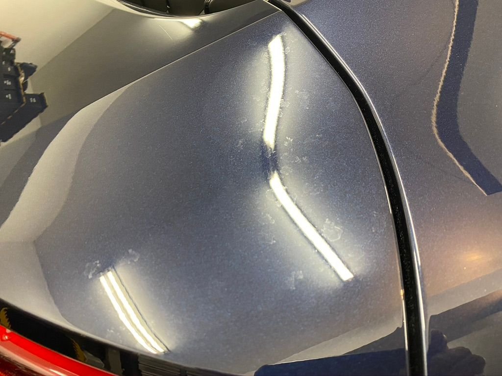

After a long voyage from Germany. Swirling/etching in the paint is not uncommon for a brand new car. Most of the time, imperfections won’t be seen at first glance, but more-so under certain lighting conditions.
Paint correction is key when prepping for PPF/ceramic. I’ve had two 992 cars & BOTH have had clear coat imperfections caused by the transport film trapping moisture during transit.
https://rennlist.com/forums/attachme...erfections.pdf
This is obviously something that requires more effort to correct.
