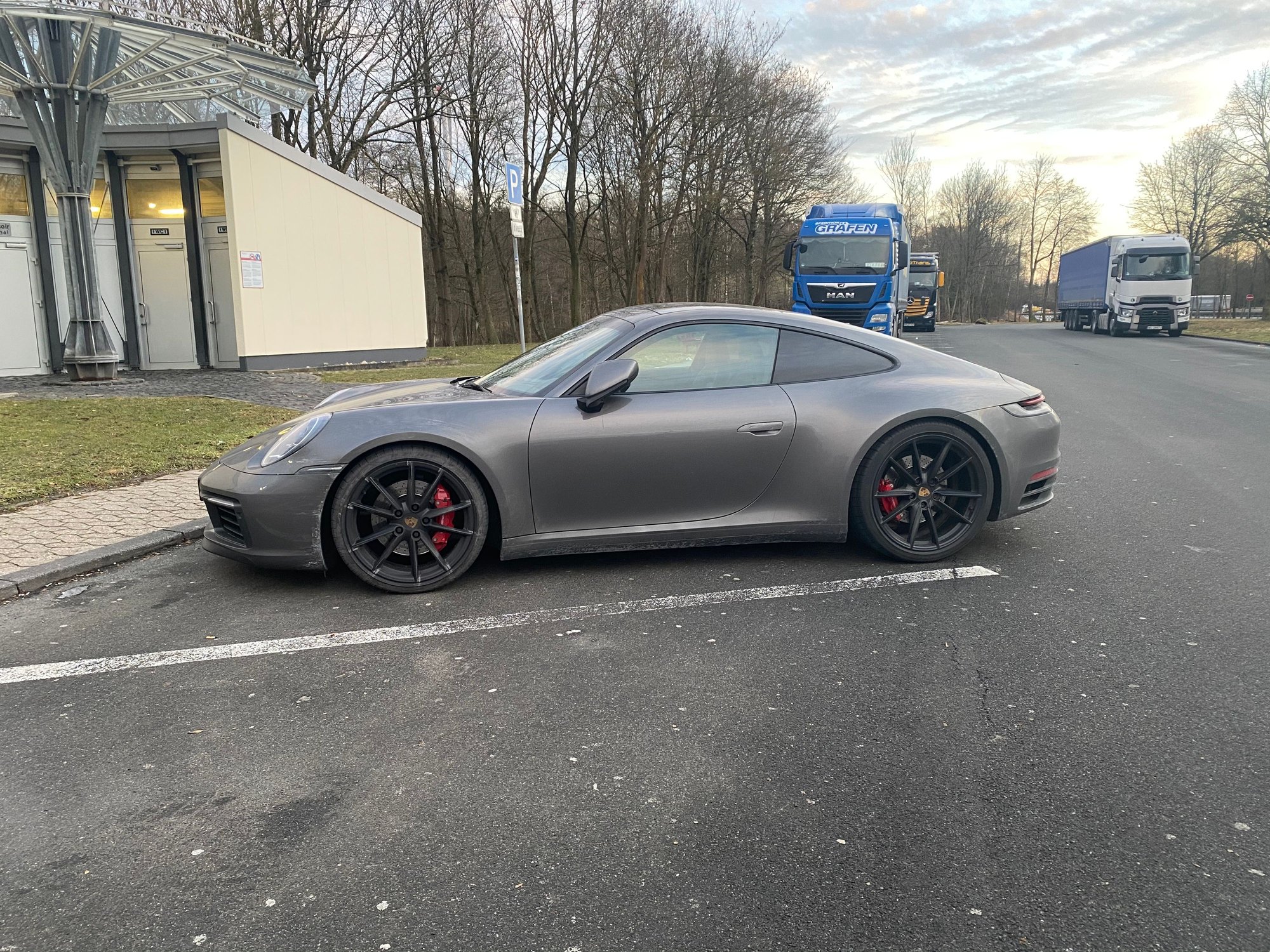

Techart HAS kit for me was the way to go. Had PASM and car didnt feel like sports car. Now it does and looks great. Better than SPASM imo. Front was lowered 20 mm and 15 at the back. Also added the SPASM frontlip and 12/5 mm spacers.
Car is dirty because of autobahn run yesterday. Car feels good and stable at (very) high speeds, also compared to all the other 911’s inhave owned.

Is this the KW HAS kit that tech art sells, or the techart lowering spring kit?
KW is the only one with an actual HAS - height adjustable spring - kit.
Car looks great.

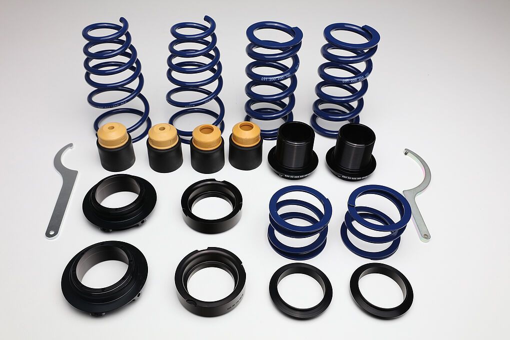

it’s a techart kit but i can imagine its KW’s HAS rebranded:
TECHART sport springs and height adjustable spring kits add a good dash of sportiness to your 911.
Sport springs allow a lowering of 40 mm and apply agile driving characteristics.
With a TECHART height adjustable sport springs kit, full flexibility is at your command. A wide lowering range of 15 mm to 40 mm allows customized height adjustment. The systen fits vehicles equipped with and without PASM, as well as with and without front axle lift system or Porsche Sport Chassis.
Scope of delivery:
  • 4 main sport springs
  • 4 helper sport springs
  • 4 adjustment rings
  • assembly parts
  • installation instructions
  • homologation certificate

Joepster...could you comment to the quality of the ride before and after the spring installation. Other springs I have installed on previous cars (BMW 440 and 991.1 TTS) the ride actually improved?!..and not the harshness you might think. We have a 992 Targa which only comes with PASM. The ride height you have set is perfect ...and we still want the ride to still be compliant - NOT JARRING - and that the car still enjoys the benefit of the stock Bilstein shocks that come with the car - only that it sits a little lower. I am considering the same HAS package from Techart and was going to do 25mm drop. I would appreciate you try to describe the ride - because it does look great.
