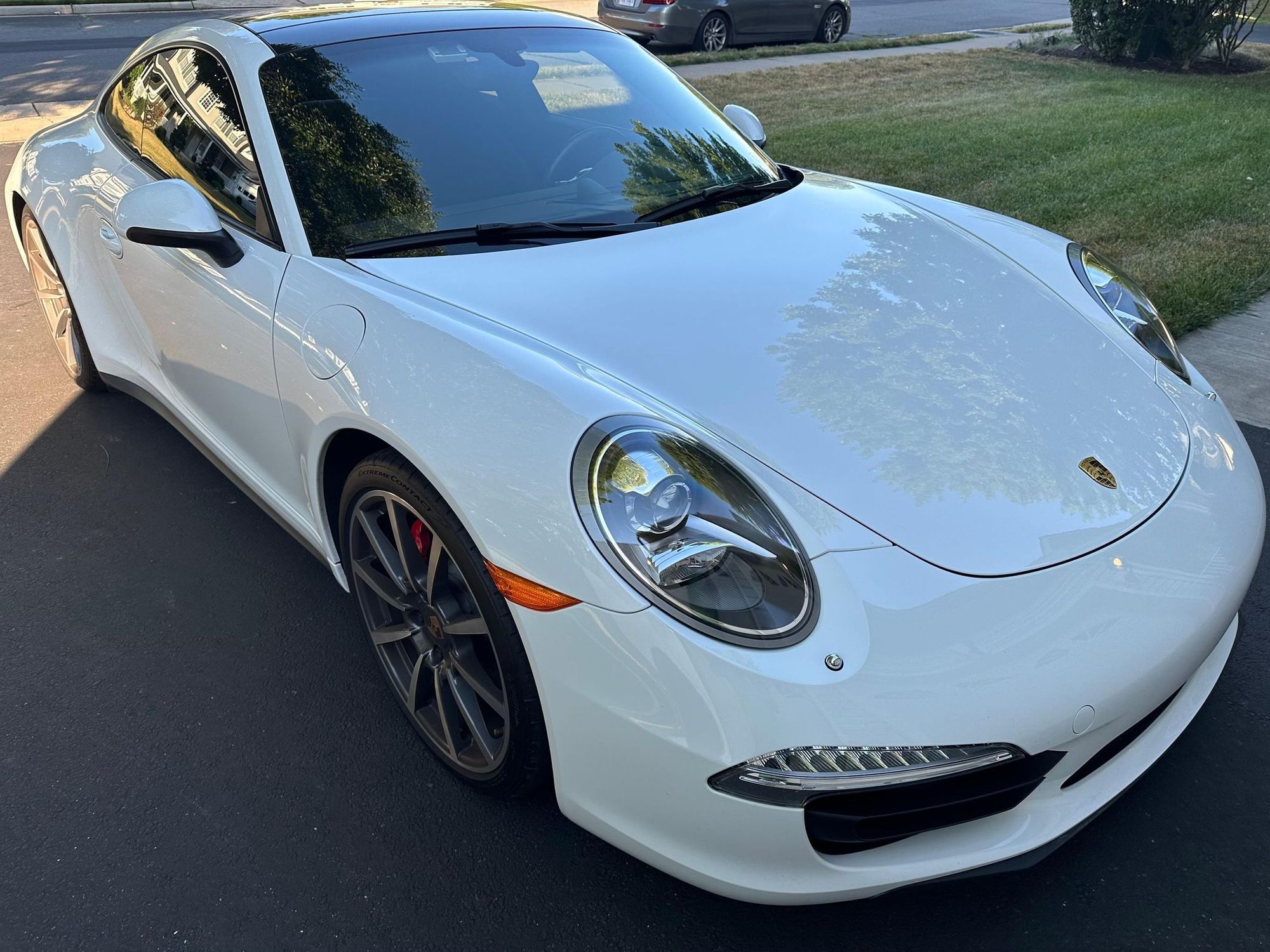

Picked up a 2013 991 C4S “991.1”
I have a ton of excitement and questions about this car. I’ve read 100’s pages of this forum and online in the past weekend.
I’ts a fairly average specification but it’s exactly what I wanted and a great deal, 70k miles but no real road rash, glass roof, interior does not look like a 70,000 mile car at all to me so I think that speaks to the quality of the platform. It is extremely well kept although a few trim pieces I probably will order to renew.
Issues:
-- TMPS light is on (but it just got new tires which is apparently when that started)
-- Fuel gauge doesn’t seem to work. Stuck on empty with the warning lamp on, even though it’s nearly full, and I’ve filled it up, no change - sensor or sending unit?
-- PPF is peeling on the hood and I’ll need to have that replaced.
-- It has a slight exhaust rattle when the car is cold at first start for about 1 minute
-- The radio starts on very loud every time I get in but I’ve read that’s “normal” for this generation
I’ve had M3’s (E46, E92) and this is my first Porsche and needless to say, extremely excited.
