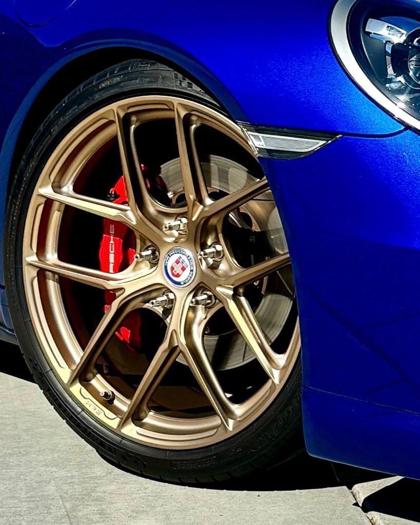

This is not the case on my 2013 Carrera S with 5mm spacers from factory (option XRP). The lug bolts are longer (guessing 5mm longer, although I'm unsure) and they are identified by anodized red conical seat to indicate they are the longer bolts. Here are a few reference pics. I don't believe most of the aftermarket bolts are a different color from looking around online.
