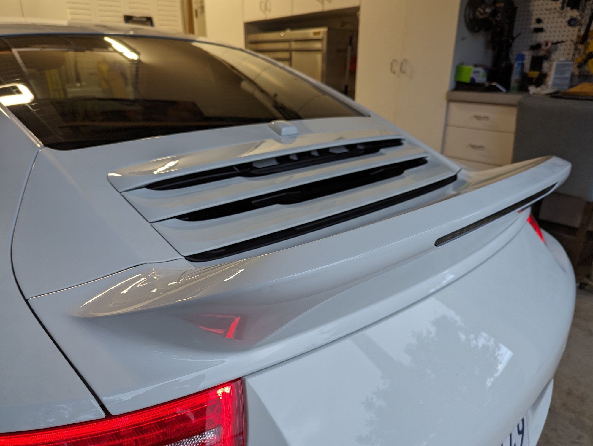

Nice to see another white 4S with a ducktail.

Awesome bro !! I did it too
