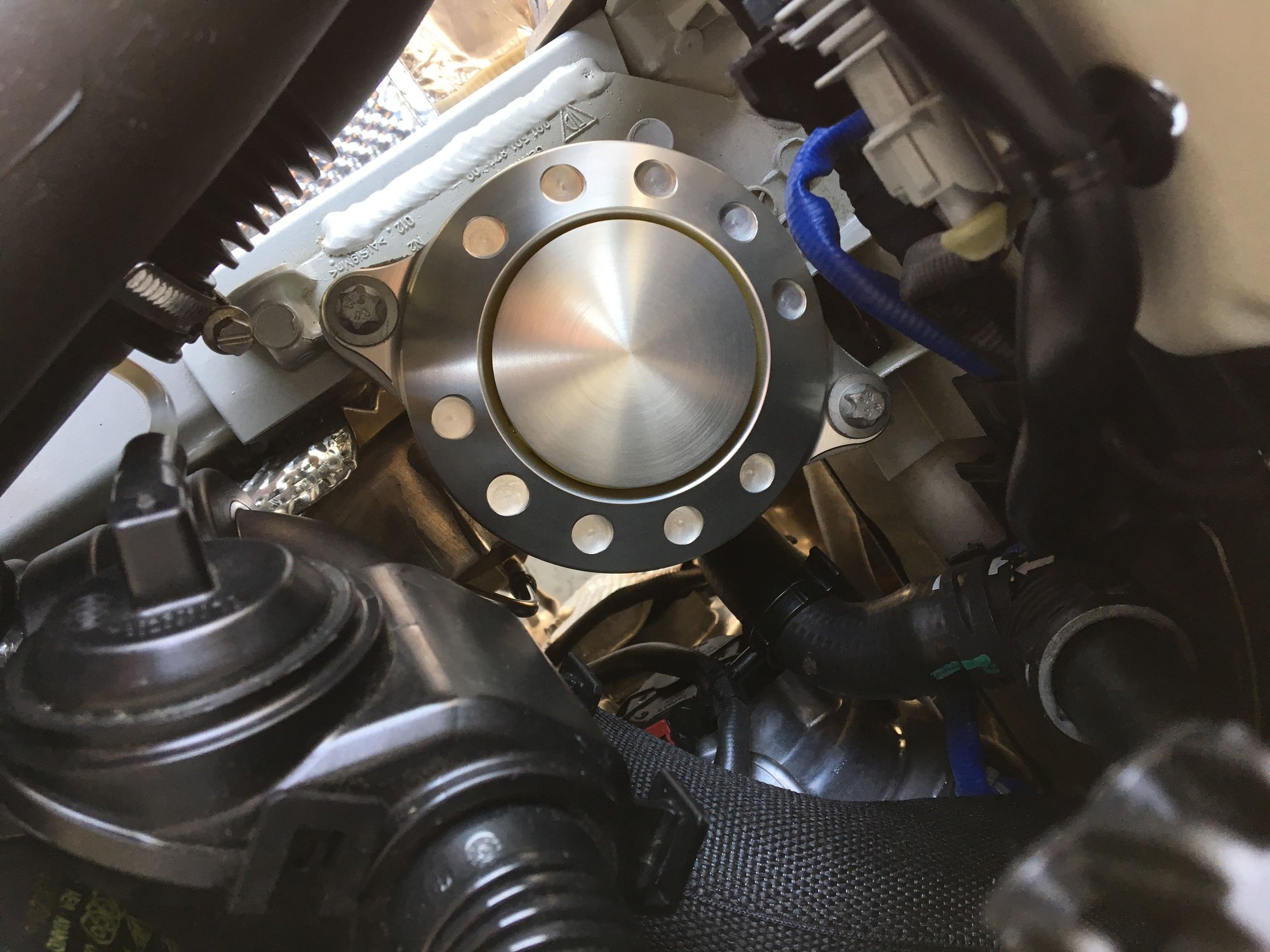

One of the first mods I did on my T was semi solid engine mounts. I managed to snap a pic. I have nothing to compare it to but I highly doubt there is a difference in mounting location vs other 991.2 models. The pic below is taken looking down from where the spoiler would be on the left side.
Curious if you noticed a difference with the mounts? If so what is it you have noticed? what brand did you get?

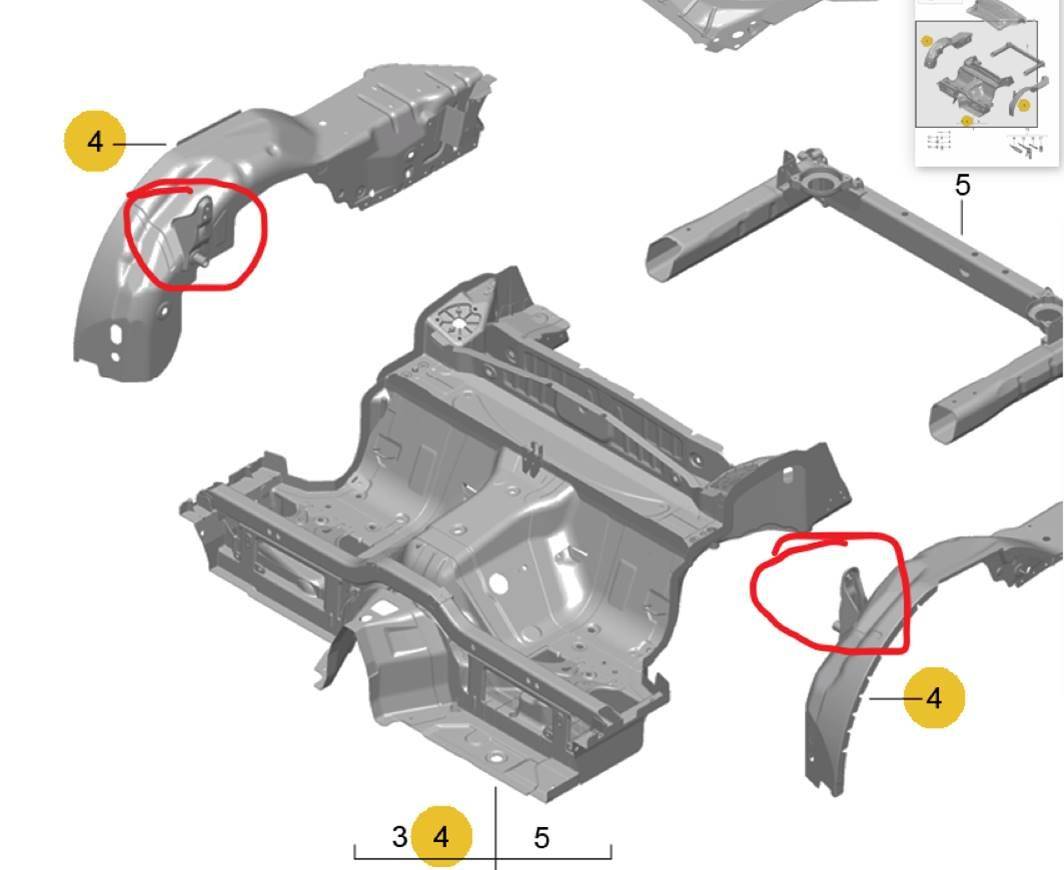

Originally Posted by Fullyield
Maybe we are hung up on semantics here. But the holes for the rear seat belts are already on ALL frames coming down the assembly line. The frame is never modified. Whether the seat belts are bolted to those holes depends on the option selected of rear seats or rear seat delete. But there are no modifications to the frame performed coming down the assembly line based on the rear seat interior option. The seat belts are either anchored into the frame for rear seats or not necessary if a rear seat delete.
From another thread:
Originally Posted by Norge911
All the mounting points (seat belt and threaded holes for seat, etc) are there except the pin to hold up the seat back. These are welded to the inner fender wells. The items in red circle are missing on a Carrera T with LwB and are missing on GT cars. Ie Carrera T with LWB have same part number inner fender well as GT cars.
While investing the installation of rear seats in a factory rear seat delete car I found the above to be accurate. What I discovered on my own is that the seatbelt anchors in the door sills are missing on my car; the holes are there, but no bosses to thread bolts into.
