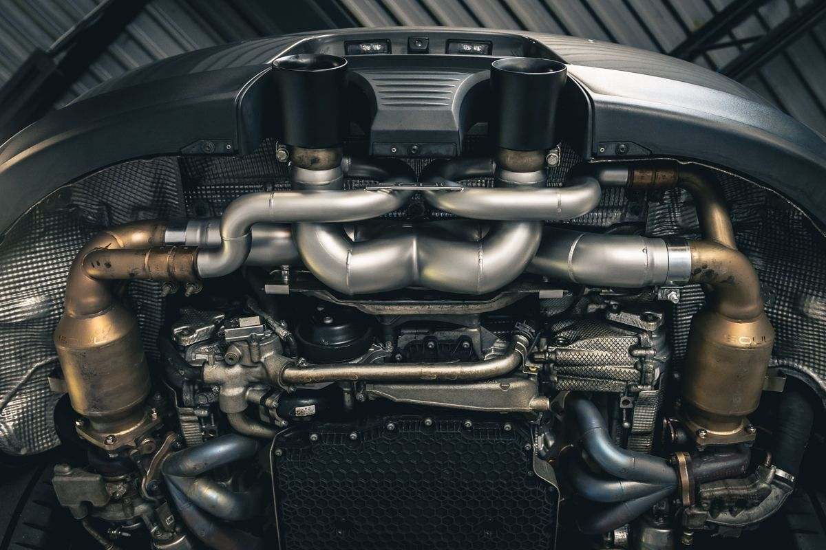

I forgot to mention that on a closed road, I had a couple of runs with a 992 GT3 (PDK).
Both times, I was pulling slightly. If I had GTS turbos, I'm sure I would have walked him pretty easily.
I went with APR tune as I have quite a bit of experience with them from my GTI and a friend who works in the industry knows them personally.
Never had any issues with anything they've done. Do they give up a little compared to other tunes? Probably. Are they safe(r)? Probably.
Below is my full setup (headers, sport cats and muffler)

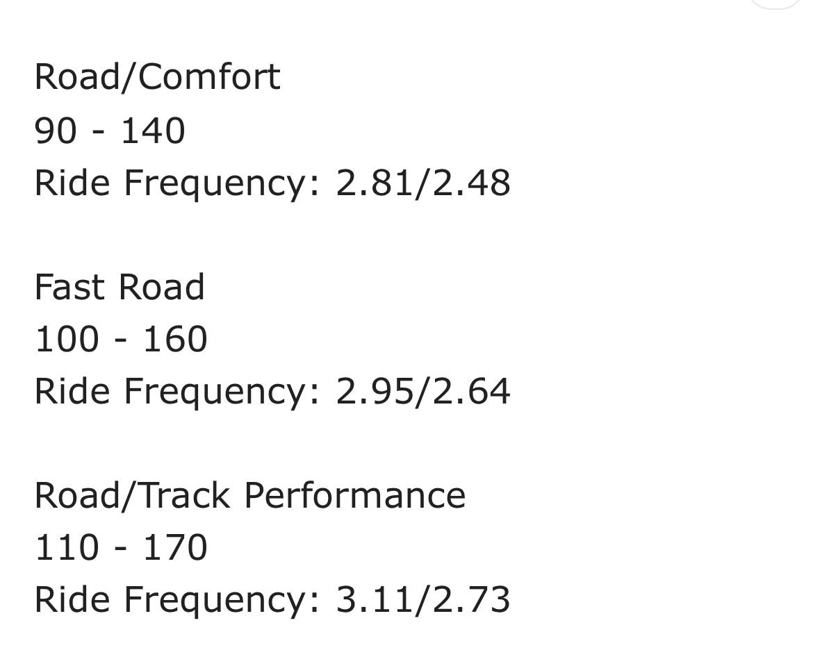

@Ksdaoski I recently upgraded my brakes w GiroDisc rotors and DS2500 pads and noticed an improvement in braking doing a few test runs on a remote road with a few hard braking sessions for typical road speeds of 60-80 mph. I'll be taking them on the track this weekend for the first time too and also upgraded to SS brake lines and Castrol SRF. Looking forward to the improvements over my previous set up which was OEM everything.
I know the 3.12 are definitely better for the track. I'm curious if you've used them for any considerable duration on the street and what you may have noticed in terms of noise or rotor & pad wear. My intention is to use the DS2500 for daily and swap in either the 1.11 or the 3.12 for track days. I've heard/read that the 1.11s have better "manners" and might be reasonably suitable for daily use, or maybe just more reasonably suitable for daily use than the 3.12. I think that keeping the 1.11 or 3.12 on full time is probably not ideal for extended DD use since they would tend to wear out (pads and rotors) quicker under cooler temps. I'm really just learning about brakes and beginning to experiment. For this next track day though, I'm going to give the 2500s a go and see how they perform. Since I bought them from FCP, I have built-in lifetime replacement on them. I guess I'm more concerned about premature rotor wear than pad wear.

OS Giken 1.5 Mechanical Diff
120 N/mm front Spring rate
GT3 Front bumper
GT3-RS Side skirts
911-R adjustable underbody aero
255/315 Cuo2-R
DSC
9.5/12 wheels
Wider track
Anti-dive, anti-squat bars.
What am I talking about? BRAKES. All of the above contribute to better brakes.
Bitey pads with stock springs, slamming the nose into the bitumen and having the rear dance around is not ideal.
The stability under braking due to the mechanical diff is next level.
You can also add race seat and harness for improved braking.
I haven’t even mentioned 380/380 Hi thermal Brembo GT-R BBK with vented pistons or pad compound.
The more stable you make the car, the harder you can brake, and the better feedback for modulation and releasing the brake. As Jake alluded to, the fastest guys aren’t always the latest brakers, but they are the ones who can clear the brakes.

BMC Filter
I also have Bilstein B16 coil-overs that are plug and play for the adjustable suspension. Lowered looks so much better!
Plus, AP BBK all the way around and custom forged magnesium LiteSpeed Racing Wheels.
With your car being a GTS and having the larger turbos than mine, I think you should be good-to-go based on what you're looking for. You'll be close to 600hp and quite a bit lighter than the two other cars you had in the past.
My car is around 500hp+ with the mods I have and it feels fantastic.
Soul is a great company to deal with. Really good quality. For a few years I had just the headers and sport cats with the stock PSE. The actually used my car to develop the valved and non-valved exhaust system (I live nearby). The exhaust made a huge difference in sound. The car sounds like an animal now, but it's not too loud. My wife and I just went for a ride over the weekend and she didn't say a word about the car being too loud. Open the valves and you can really hear it. Also, with the full exhaust, you can really hear the turbos whistle and with the diverter valves you get a muted, old-school "whoosh" sound when you get off the throttle.
LMK if you have any questions.
how are the soul exhausts? big difference in sound?

Spring Frequencies
Spring Frequencies
I had some suspension engineers calculate spring rate frequencies for my car.
With half a tank of fuel, and me in the car, I have 300kg over each front wheel and 500kg over each rear.
So 40/60 Front/rear weight.
I’m currently 120/170 MR Spec rates.
I have ordered 160 rear with 15 helpers. ( Had 170 with 30 tenders).
This will bring me to 120/160, after I complete tests with this, I may bring the front up. Now I’m going to tease @IRunalot a bit here.
110/160 is MR .7
120/160 is .75 (my new rates)
130/160 is .81. (GT .83)
135/160 is .85. (Very old method)
When car suspension was in early development, they created a rule of 15%. That the rear of the car needed to be 15% stiffer than the front, because the rear wheels hit the bump after, but they want the rear to stop oscillating at the same time as the front to stabilise the car faster.
Most drivers don’t like the rates so close together but I do.
A lot think the car feels numb if the nose doesn’t dive. They need to feel that. Cup cars are 1:1. You need to stay on the brakes and trail brake for them to turn properly.
But they have big Aero and slicks, we don’t. So we don’t want to over do it.
140/160 would be R7’s or slicks. I want to run CR-S and Cup2-R. So I won’t go that high in the front.
