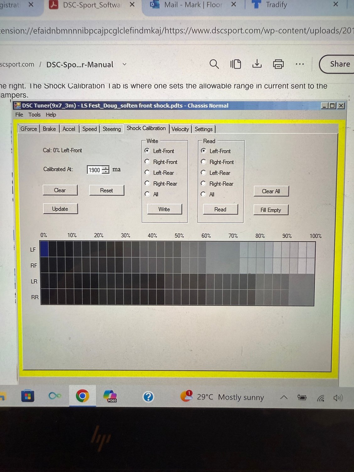

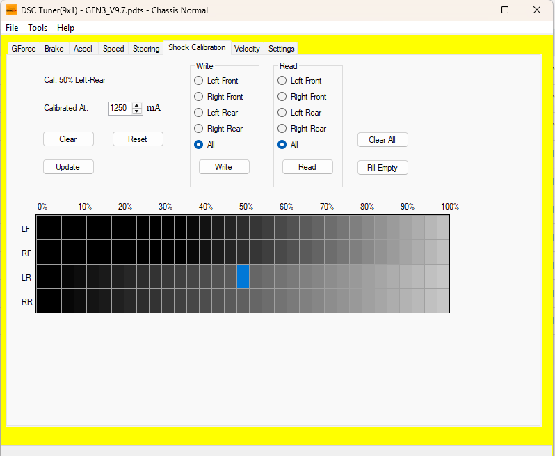

This is the Calibration tables yeah?
just looking at the pdf, there is only one value. 1900ma
Where is the hard value?
Soften front
Soften front

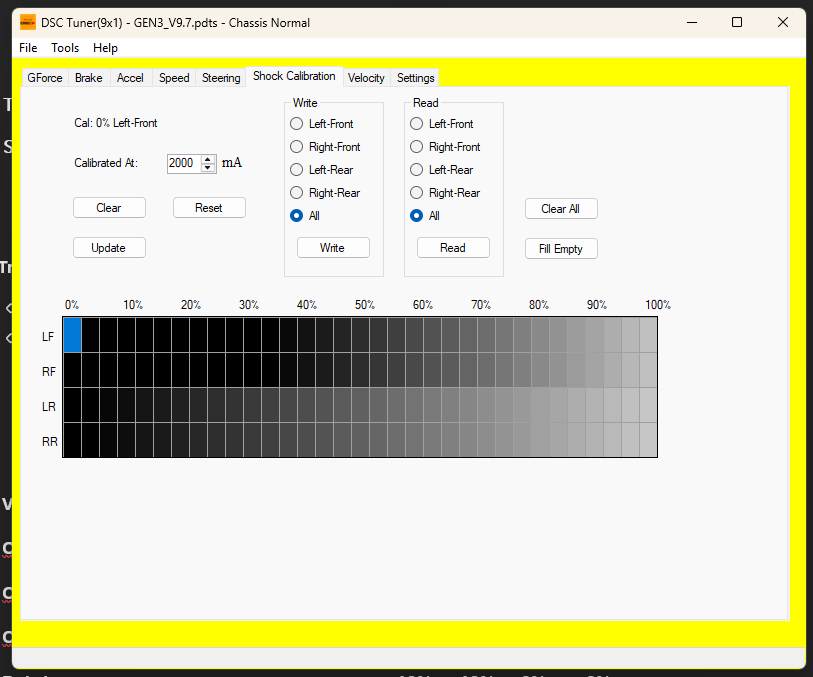

Look at the 50-60% range where the G-Table is set to and he also has the base value at 60% if this is fro the video. I don't know what the default rate is or the table is at. That 1900mA will never be seen by the damper, I only care about what I refer to as the the active rates.
I gave a better explanation in the other thread a few minutes ago. I have three methods of building the damper curves and G-Table.
This is mine and I just put it on the other thread. Mine is at 2000 at 0. Look at where its at around 50% that is much stiffer than mine
You can also clear the entire table and set your own values.

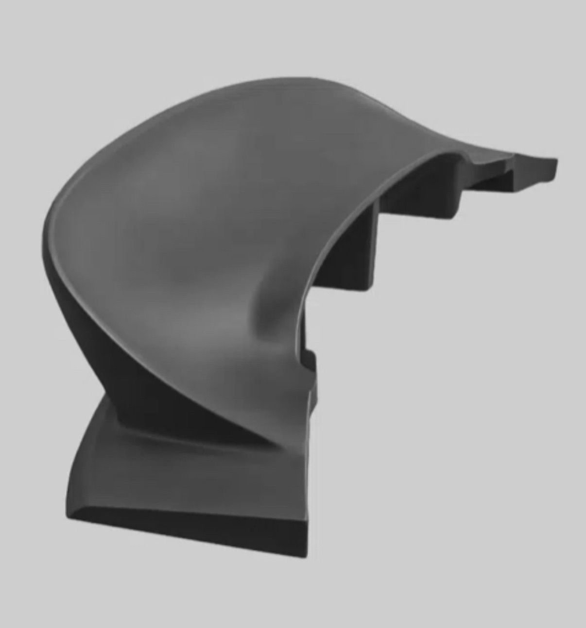

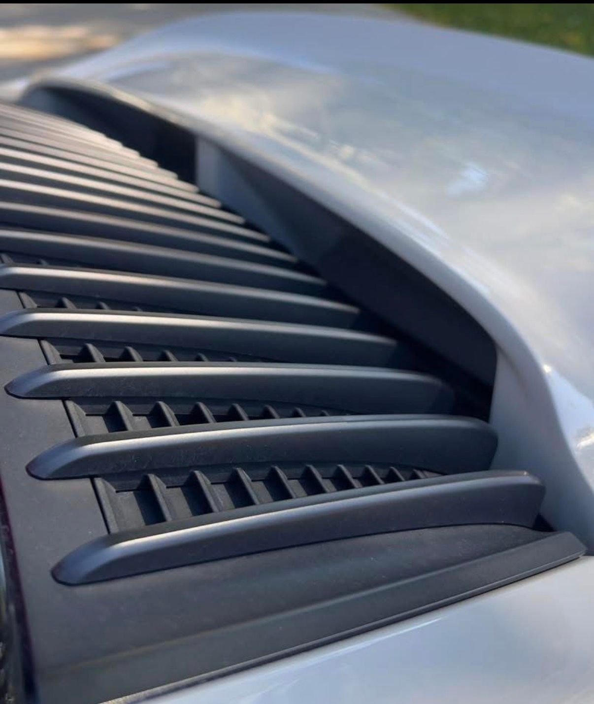

I ordered a Moshammer Ducktail to pair with my TurboS deck lid.
Can’t wait to see it.
TurboS Engine scoop
TurboS Engine scoop
Mos Duck
Mos Duck
Moshammer Duck
Moshammer Duck

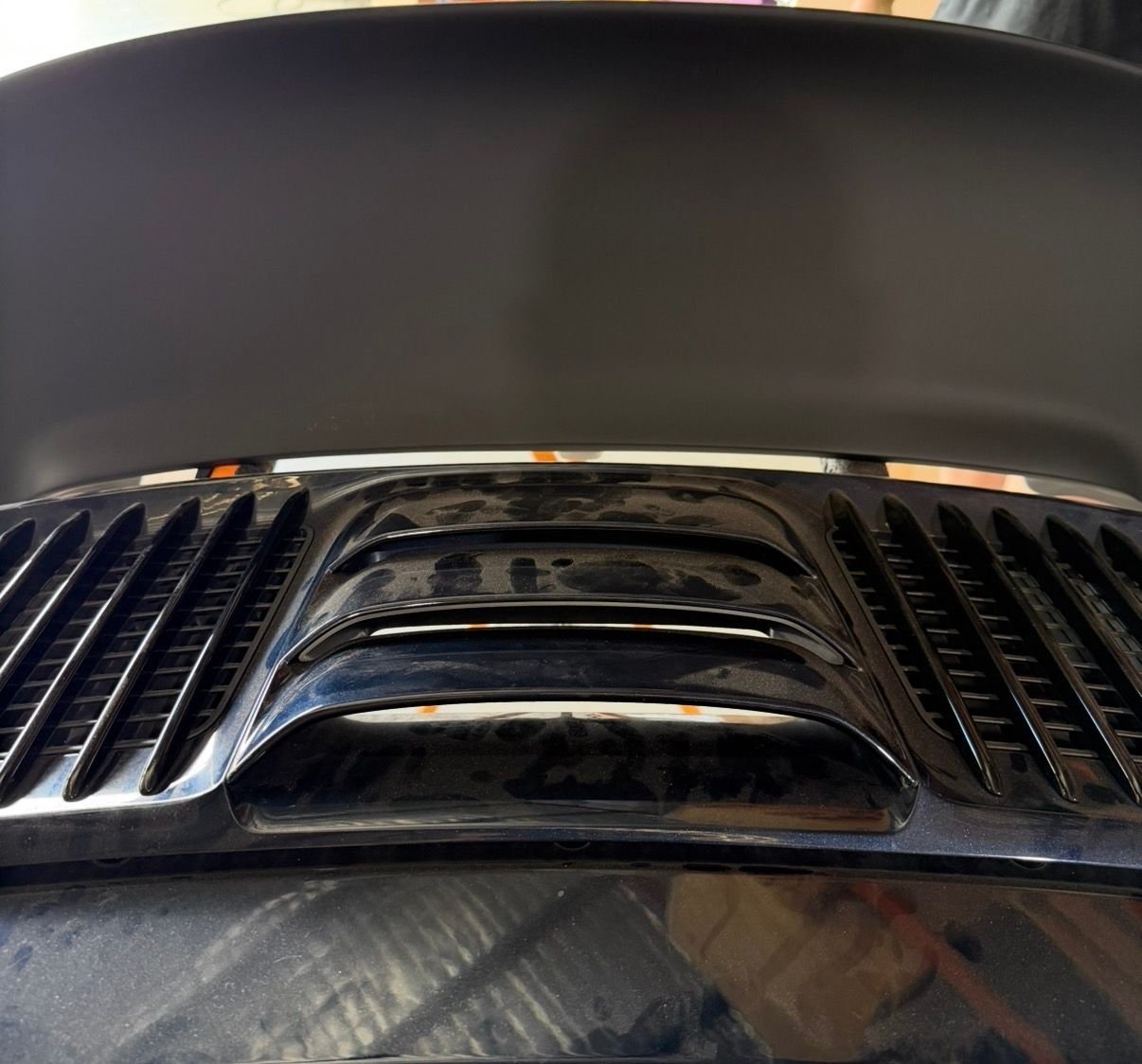

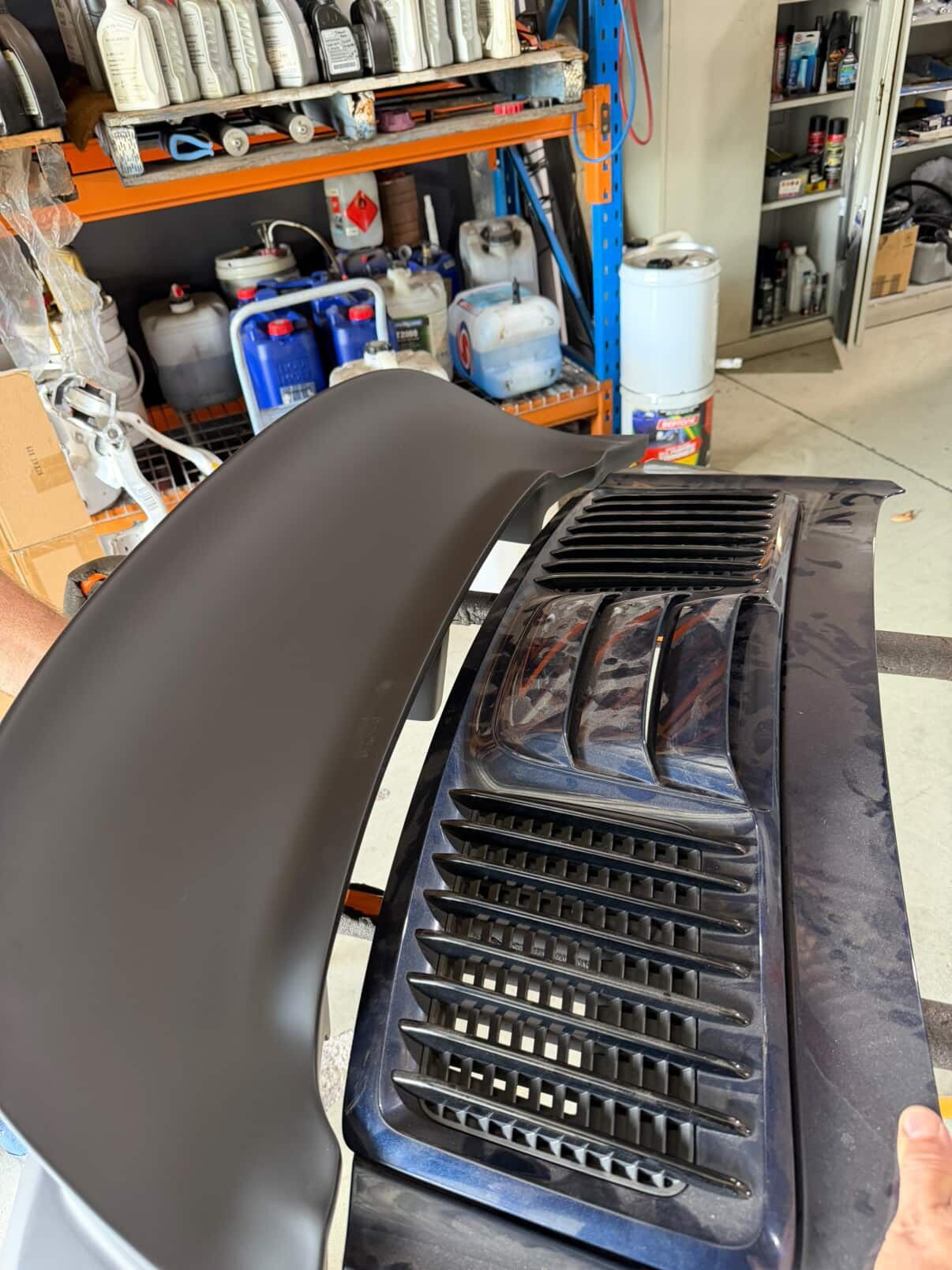

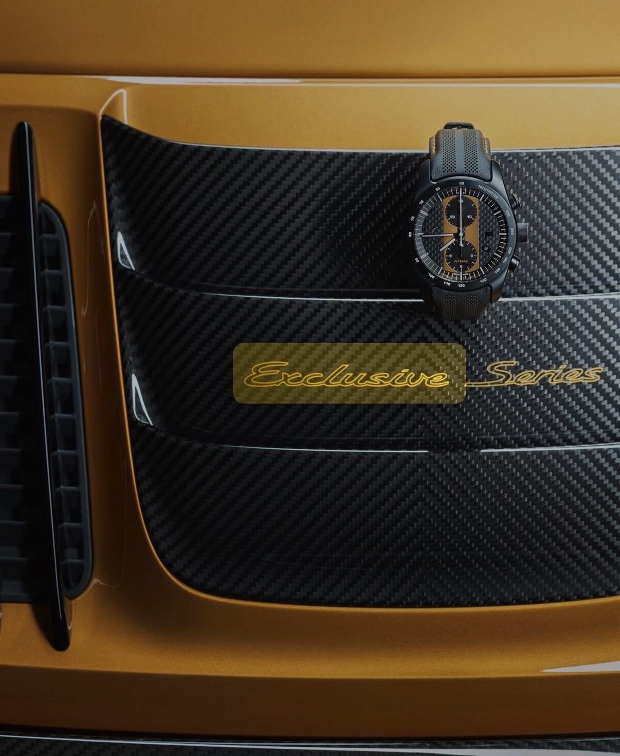

Carbon Fibre scoop incoming
Looks epic
Looks epic
I am having the scoop painted Piano black, but won’t use it. I pulled the trigger on the Rennline Carbon Fibre replacement.

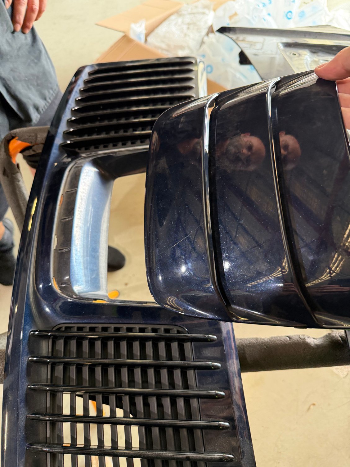

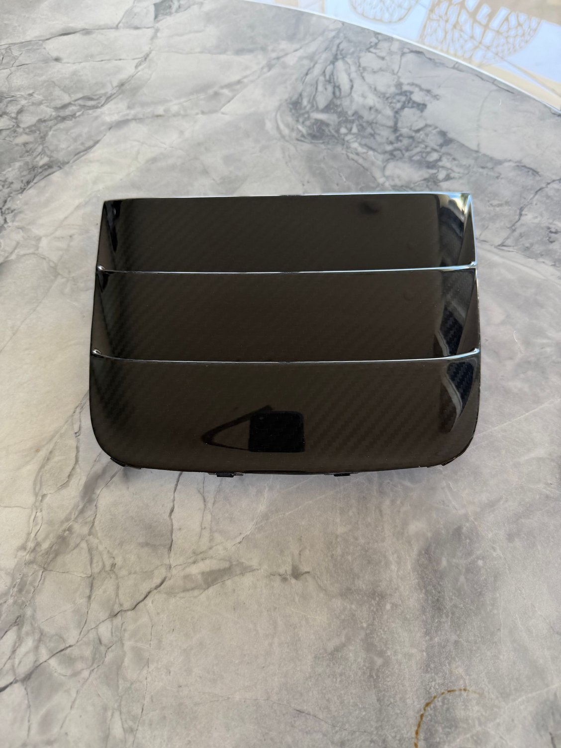

TurboS
TurboS
The carbon fibre scoop showed up. Hopefully everything else back from paint late next week.
