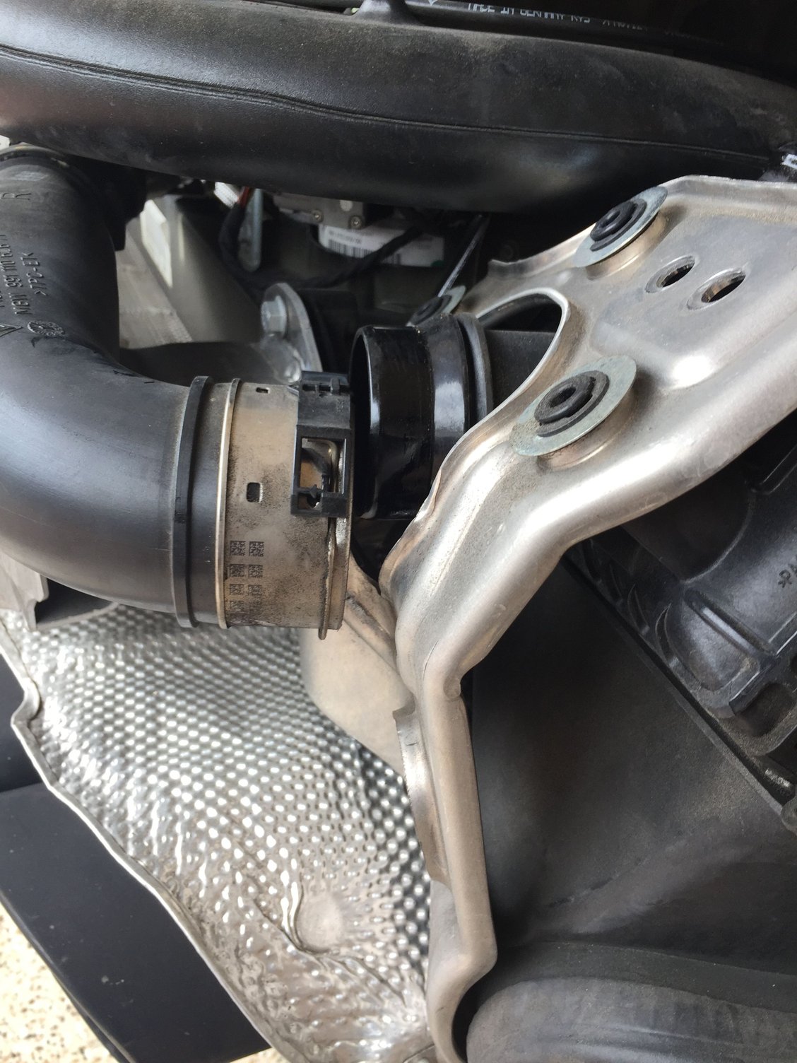

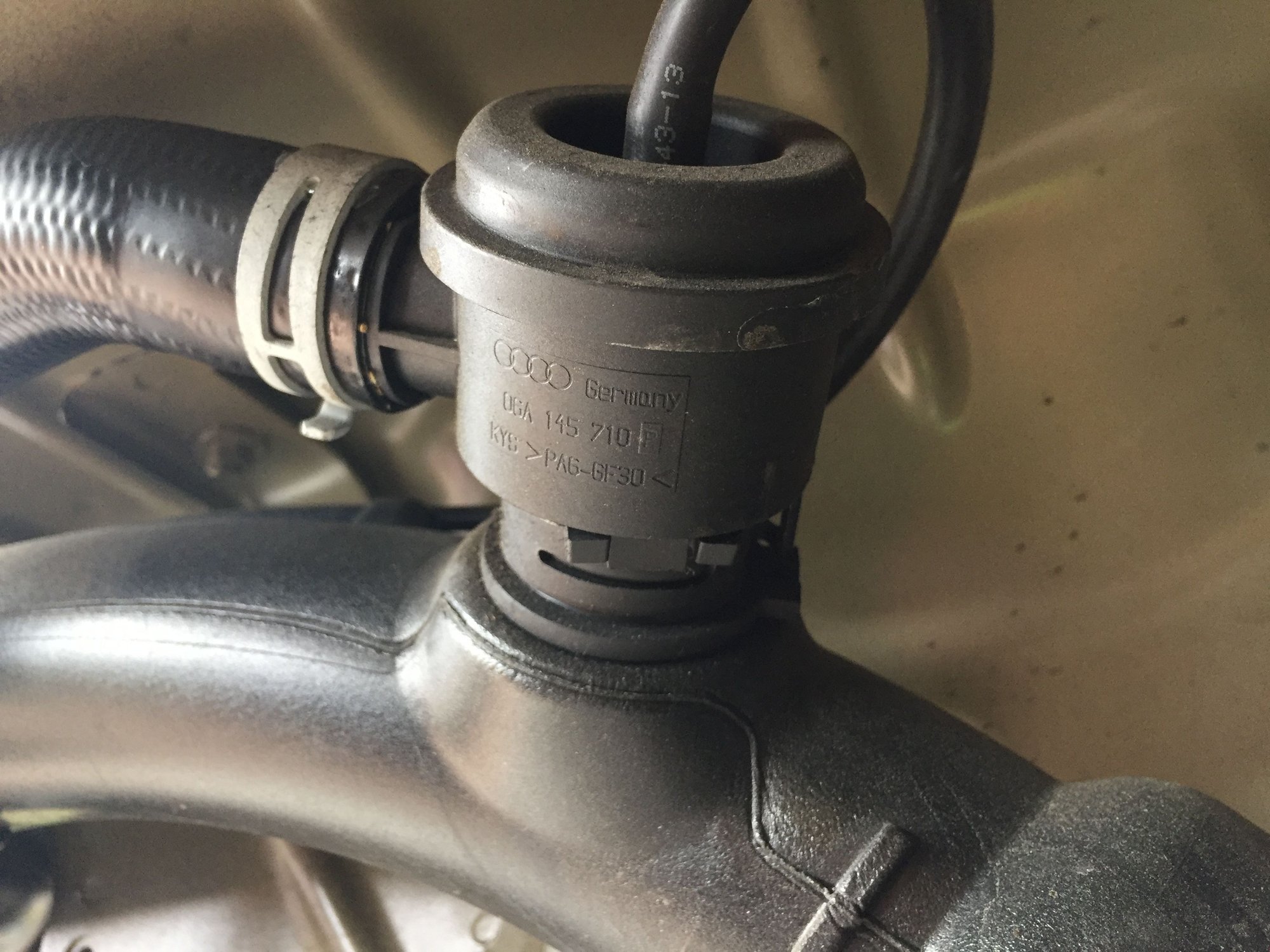

Hi all
i did some logging over the weekend and I seem to have an actual vs request boost delta or about 3psi.
my mind first goes to bypass valves but I do also worry about the intercooler hoses and connection to the intercoolers. I have a set of BPVs to throw in but wondering any experiences people can share of issues they have seen and resolved.
thanks in advance car is hitting 30k
Example of connection
BPV installed one outlet pipe. Part spins easily in pipe hmmm

Another note I went back and saw I had a good amount of play in my passenger side outlet hose connections.

It’s just a possibility but I think the black hose is where the boost leak might be coming from, especially if you have an IPD fitted, the clamp from one of the sides might have come lose.
