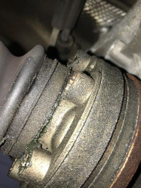

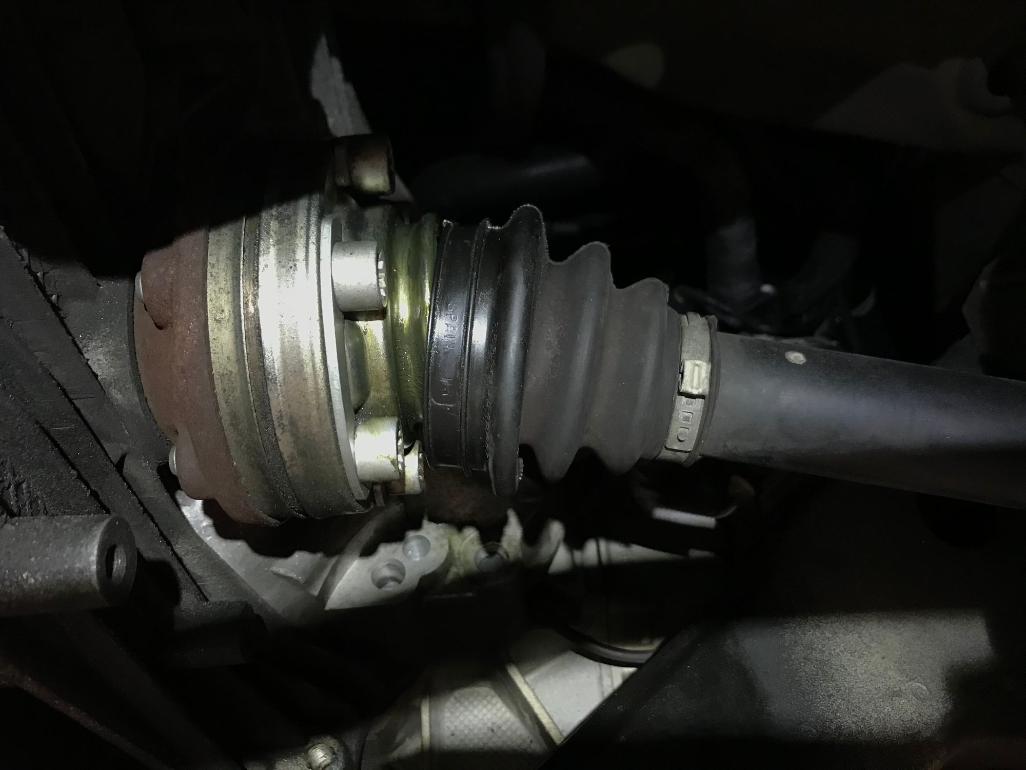

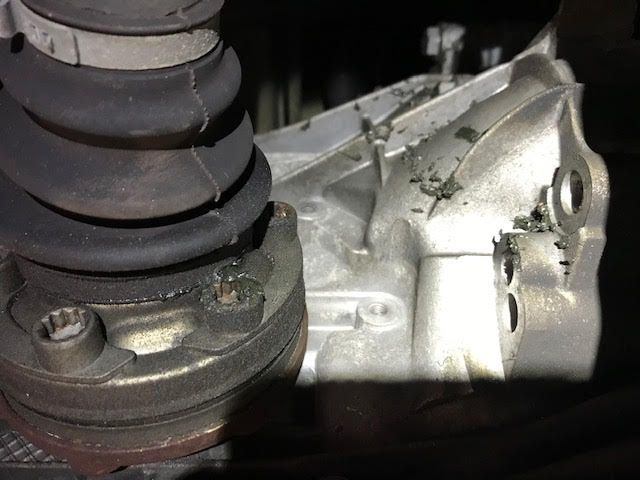

Below are photos of my inner CV joints. Both sides are leaking/spitting grease from the seal on that inner portion of the boot. (This after only 45k miles).
I'm thinking that simply removing the clamp at the inner end of the boot, perhaps squirting in a bit new grease, and replacing the clamp would fix this.
A couple of questions... does the type of clamp at the link below open up fully so that I can get it around the cv joint without actually disconnecting the joint? (I've never used this type of clamp). And is the tool in the 2nd link the right tool (although pricey), and how do you know when it's tight enough?
Thanks!
https://www.pelicanparts.com/More_In...=0&SVSVSI=4293

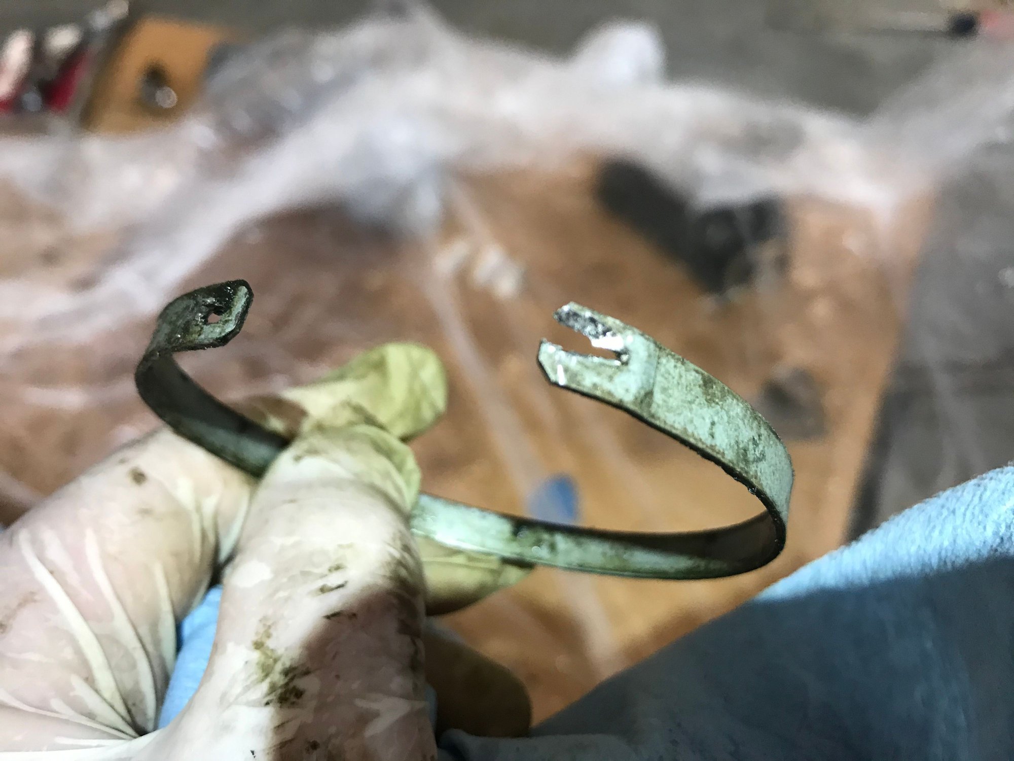

-carefully cut-off old clamps with a dremel tool at the tab the locked the clamp around the boot
-since i couldn't get the OEM grease in a timely manner, i chose to not add any new grease. I judged that what spit out was not significant and i didn't want to risk mixing an incompatible grease, and i didn't want to totally dissassemble the joint to clean it out and redo grease from scratch. When sliding off the boot to take a look at the actual cv joint, seem like a good bit of grease was in there.

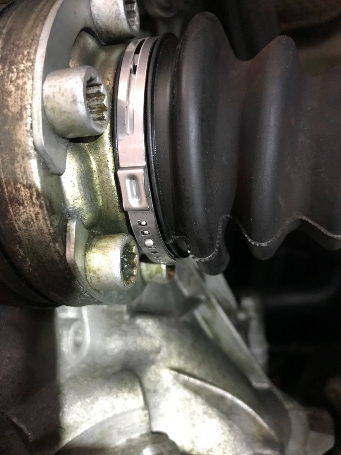

-replaced the clamp with a new 'ear-type' clamp. Amazing how difficult it is to find such a clamp (no local stores carried one). Finally sourced one at RMEuropean online. Also bought a pair of Lisle boot clamp pliers on Amazon, and applied 40 ft lbs torque to close the ears on the clamp - seemed to be sufficient closure of the clamp. (I raised each tire/wheel to make the driveshaft ~horizontal on the side i was installing the new clamp on, to help hold the boot in place).
(crossing my fingers for no further grease leaks)
After removing the old clamp, you can slide the boot off to inspect the joint.
Old clamp, removed.
New clamp installed (pre-closed)
With clamp ears 'closed'.

I just realized the final photo previously posted actually doesn't have the clamp closed. I've added a photo where the clamp is actually closed in its final state.
As noted, i used the below tool to close the clamps. Advantage is that you can apply more torque to close the clamp by adding wrenches to the tools 1/2" square.
