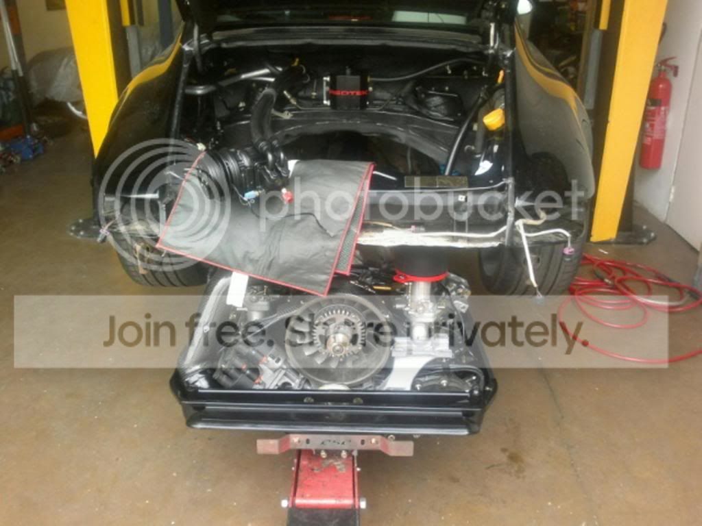

Thanks Dave. I was worried about going with carbon but when I saw the JB Racing engine that was it, the look I wanted, so I went for it.
Here we go again, we have lift off, erm.....lift in!
Redtek oil-catch tank at the back. Rennlist sticker in back window Domed ITG air-filters, we didn't have quite enough clearance for the flat tops at the back due to the retractable spoiler.
Rennline carbon plug lead tidy fitted on the fan housing. AC all connected up.
The heater duct modification has been made to the carbon shroud to accept the Rennline duct which you can just see under the cover on the first photo.
The exhausts (bespoke items to get the most out of the engine) just about to be fitted. Bilstein B16's just showing.
Fitted a work of art. I thought it was a shame to put the engine back in but I definitely think it's a shame to put the rear bumper back on :?:
We're on final furlong,
Paul
