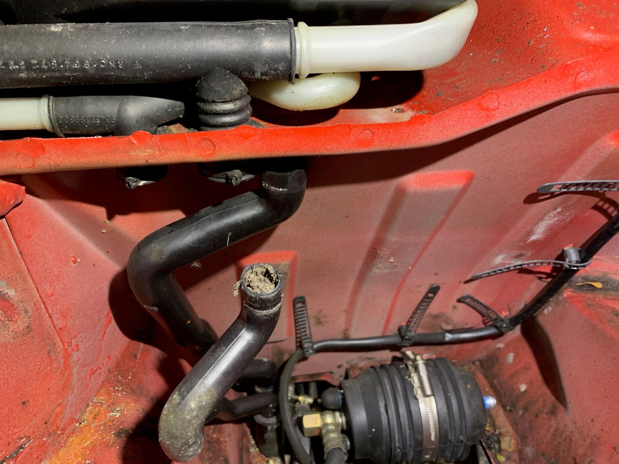

Mine looked like this when I went through my AC system.

Originally Posted by Deserion
Drains are likely clogged or severely restricted. Same for the little rubber valve at the end of the drain line.
Now for the bad news.
You will need to pull the fuel tank to reach the lines.
If you are up for the project, I recommend you go all the way; remove the suitcase, open it up and replace all the foam seals on the dampers. It would also be a good time to replace your evaporator and expansion valve.
With the fuel tank out, you can replace the strainer in the tank, both fuel lines and vapor line that goes from the rollover valve on the expansion tank to the hard line going back to the engine bay.
This doubles the size of the project but all the foam and rubber in a 964 is disintegrating by now so it's all due to be replaced.
