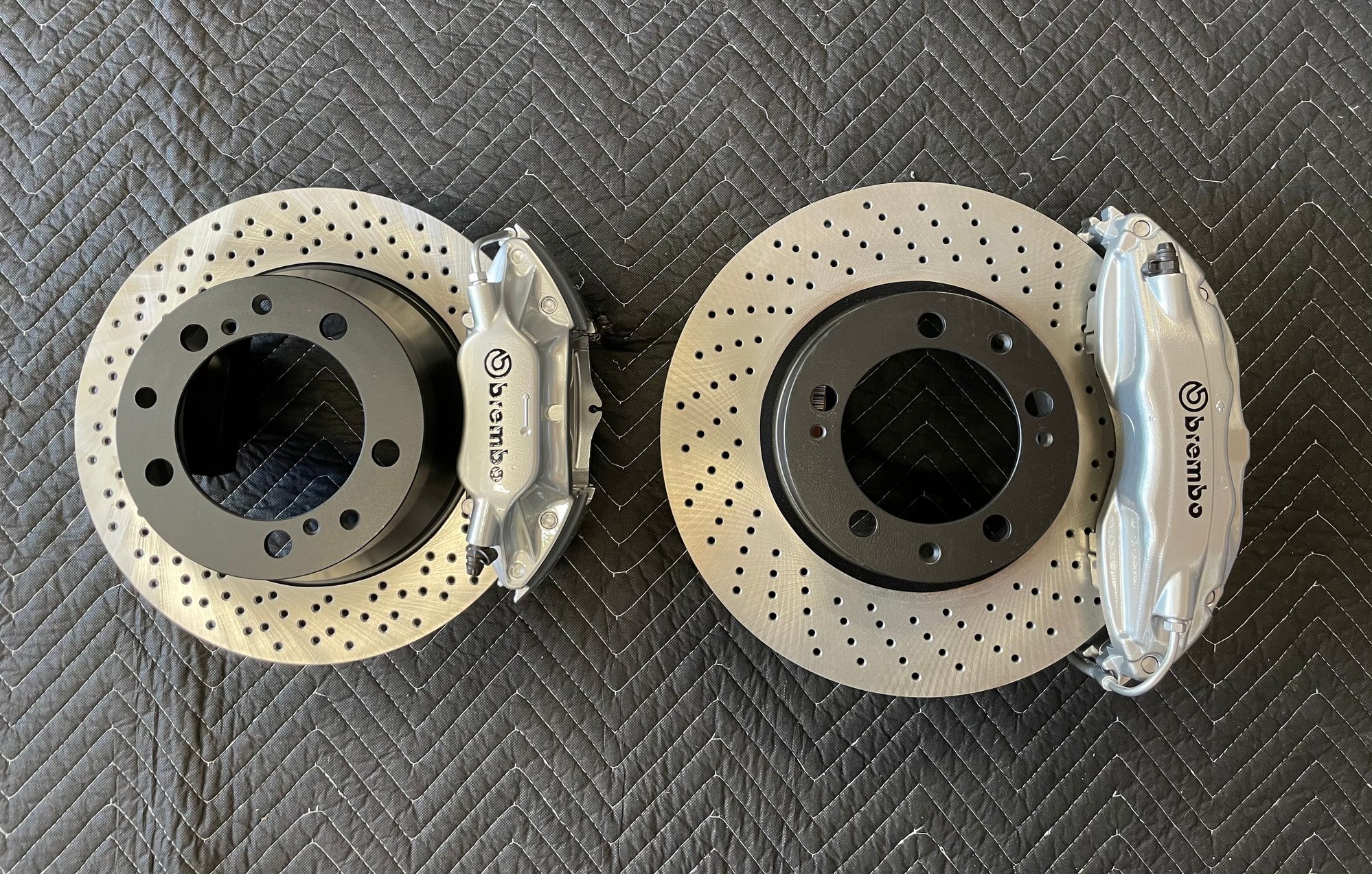

Hi RL,
i’m currently in the process of upgrading brakes on my 89 C4 to Big Red set up. 993 TT front calipers and 993 c2 rear calipers. Does anyone know if i should run 964 steel braided brake lines or 993 steel braided brake lines?

Don't know the answer but drool..... those look tasty. Why the TT fronts vs. 993 C2 all around?
thank you!
the turbo caliper is bigger, better stopping power.

Originally Posted by 911 jared
thank you!
what size are those rotors? love the silver
i dont remember the size off hand, all i remember is these are oem 965 turbo front rotors, the rears are a 951 part # rear rotors.

@titleistaddict87 the 965 front rotors are 322mmx32mm.
