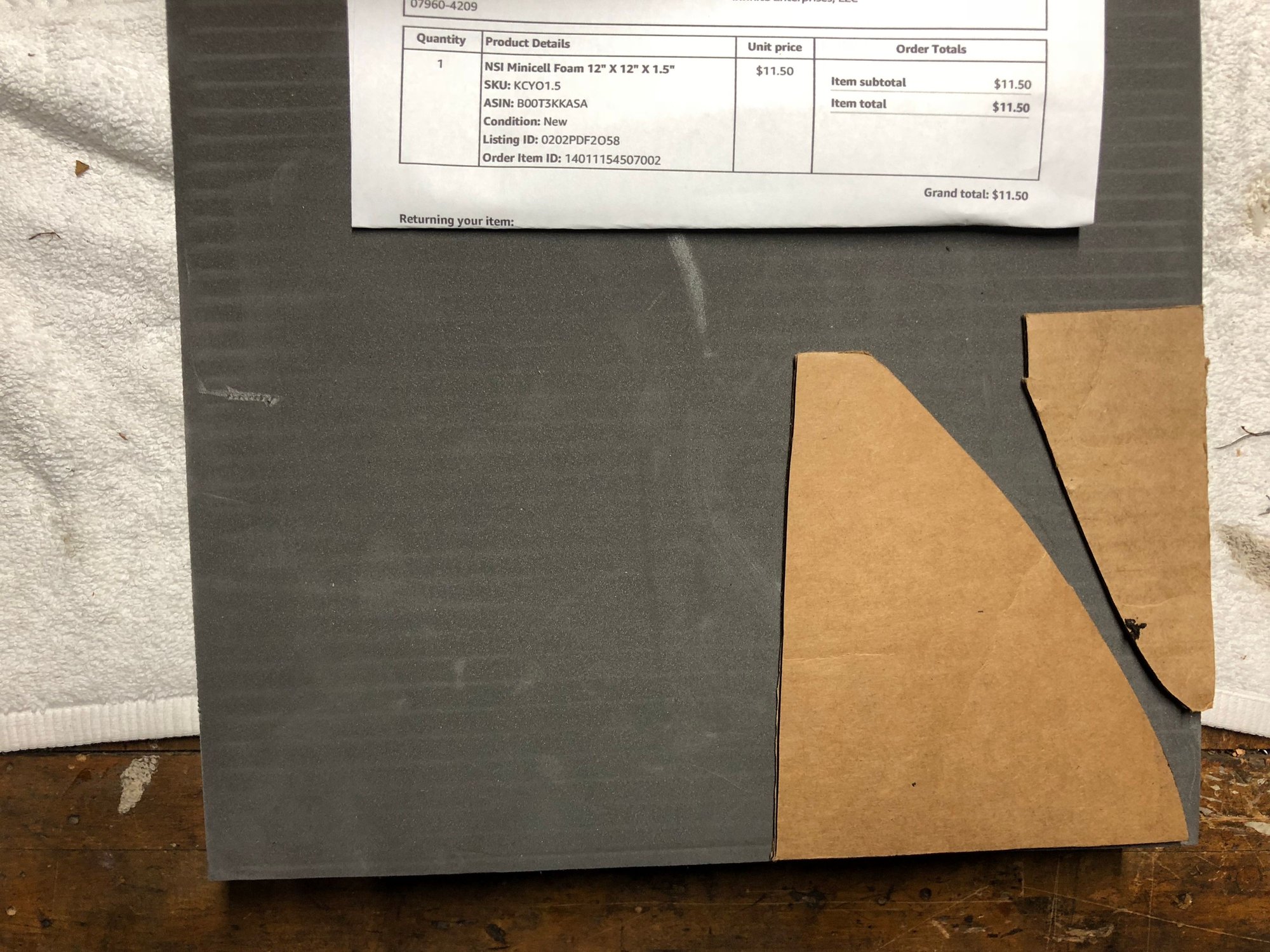

Likes: 83
Minicell foam perfect For carving out a new set!

From: Texas/France
Can anyone post dimensions for those wedges? Mine are missing and I’d like to cut some foam.
Old Sep 27, 2019 | 11:22 PM
Ubipa's Avatar
Ubipa
Joined: Dec 2018
Posts: 394
Likes: 83
1 sqft of foam is enough to do both sides, top and bottom. If I was doing it again, I’d use a 1” thick piece. You can use the card board it was delivered in to mock up the templates..

Thanks for the feedback. Yes, I've had the front bumper off multiple times for various reasons. I'll have to double check the baffles. I thought it was just the rubber seal that runs under the coolers and the vertical divider at the front of the cooler that were needed. So, in all likelihood my baffles are long gone.
Doesn't mean I can't spend $15 and make some new baffles to have them brand spankin' new, shiny, and ensure a perfect seal. That coupled with the second cooler which is already here should mean that I will have no cooling issues no matter the temp and duration of time on track.
