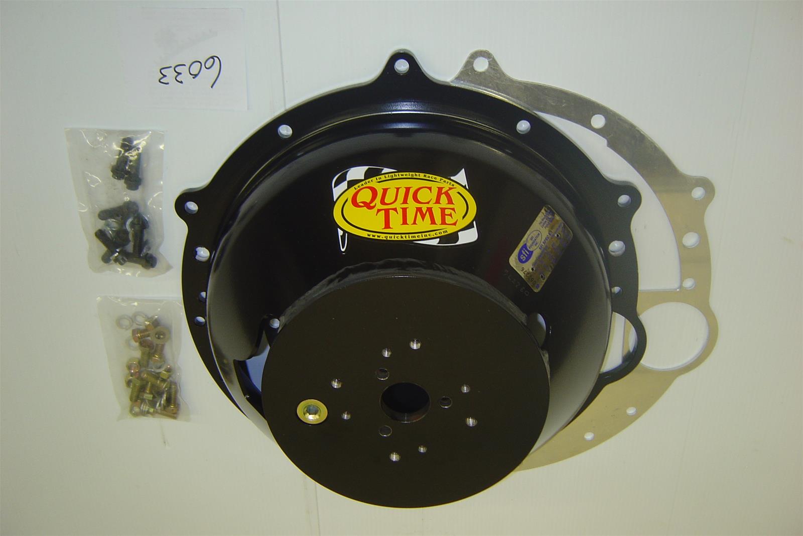

=TonyG;13096444]Here's the update....
Anyway, broke the clutch and bell housing in the last race.....
Just lost my C5 BH last weekend.
I am going to go with the QuickTime SFI rated BH with the integral adaptor for the 944 BH. It's amazing they make a custom BH for a small slice of a small market. Probably overkill for my 400 RWHP, but peace of mind should a clutch fail.
Gorgeous build on yours, and good luck with the new box!

That's from over revving the engine. These full sized pressure plates start to come apart at high rpms.
You can use what ever bell housing you want, it won't fix that issue.
A small twin disk will however.. :-)
TonyG
