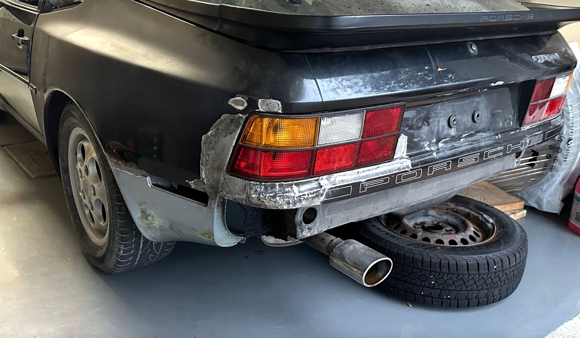

Today was a big day! After spending 7 months working on my new 1987 S, I took her (and my son) for a little ride across town. Just to see how she behaves.
When I acquired the car, there was a lot of body work to do and the engine was not running. It seems to have been stored outside for several years. After fixing all engines issues, replacing all rubber hoses, and putting new brakes, I was hoping to see what’s next to work on!
My first discovery is a passenger side control arm that seems tired… There is some knocking coming from it even when rolling over the smallest road imperfections. I will investigate that. No real concern there.
What is puzzling me a big more is a subtle shudder I feel when accelerating in fist gear. It’s hard to describe. The engine is not the culprit. I can feel all the 190 something ponies doing their work! But it feels like there is some kind of low vibration. Not feeling it when I go in other gears even under heavy load. It feels like it’s coming from the front not the rear and you don’t hear anything… You just feel it.
Any idea or suggestion on what it could be or where to investigate?
Thank you
Martin
