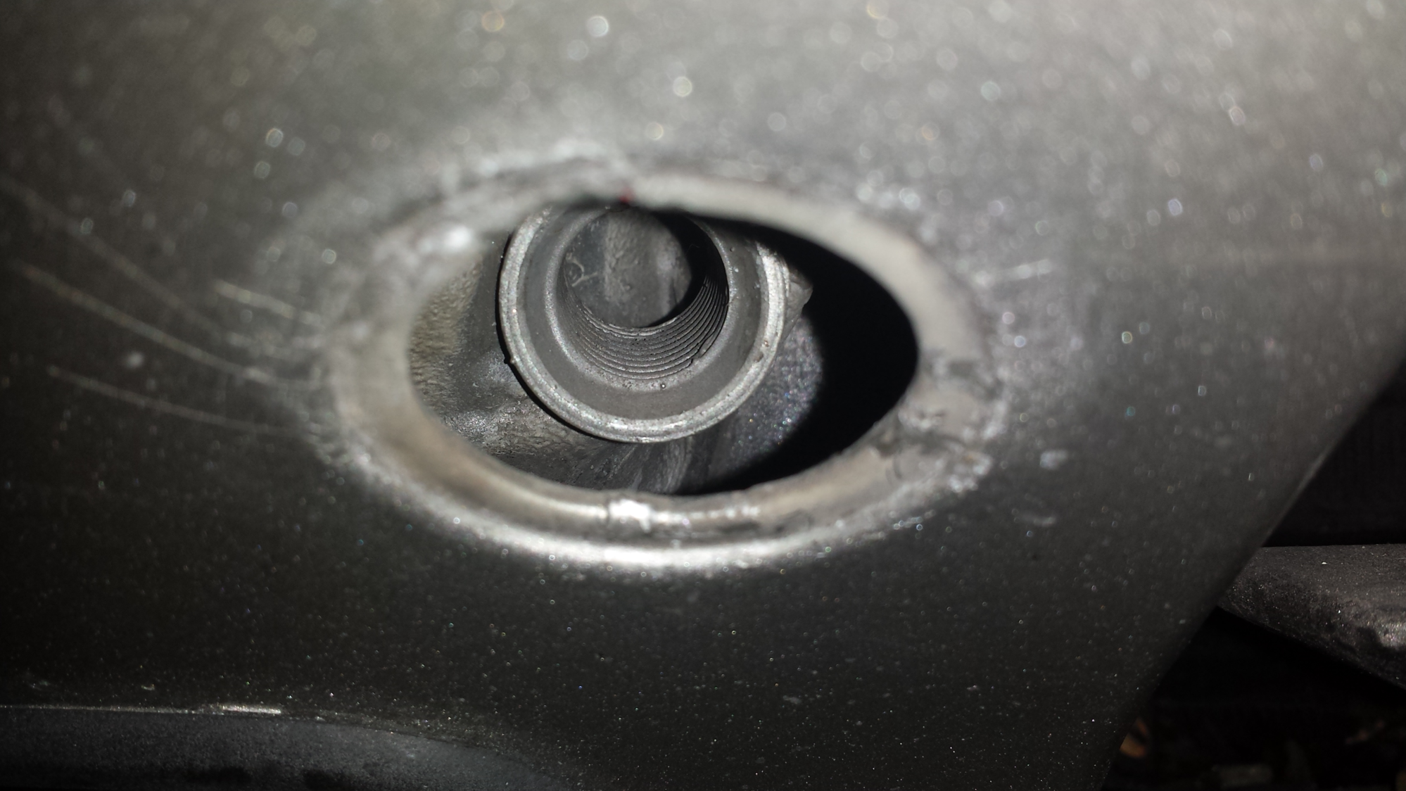

Borrowed tow eye tap and drill from CraigL.
Proceeded gently with instructions collected in threads. Kept tap and drill lubricated with WD-40. Alternated between brief drilling to remove aluminum debris and 1/4 turn with tap to remove aluminum in threads.
Mission complete; pictures below. Shipping tap and drill back to CraigL this coming Monday.
Tap and drill borrowed from CraigL
Front tow eye socket with aluminum debris from PO drilling.
aluminum debris coming out
small debris from drilling, bigger chunks from tap
just some more cleanup around the edges
New tow eye screws in just fine, and works, have test towed the car with it.
