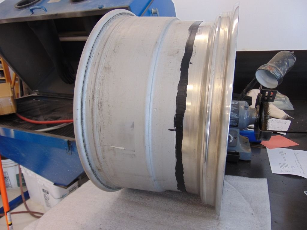

Update- I found the invoice for the original purchase of the wheels, out of Germany. I contacted the originally supplier of the wheels. They still had the purchase info. I was able to buy just the outer rim. It was a used rim but I found it to be in excellent condition, as they had polished it up so that no blems were visible. I also chose to buy a new set of nuts and bolts and the sealant that they use to seal the wheels. Shipping was by DHL and took about 2 weeks. I recently reassembled the wheels after consulting a few how-to articles. One by Pablo (via Flussig) and a youtube by Black Forest Industries. The only hard part was torquing the nuts. I had to have a friend help with that by holding the bolt heads steady while I torqued from the other side. The wheel is reassembled, sealed, and ready to mount a new tire.
All assembled and looking good.
I torqued in a star pattern, marking each one with a marker so as to keep track.
The black strip is the seam between the wheel halves that is sealed with sealant.
