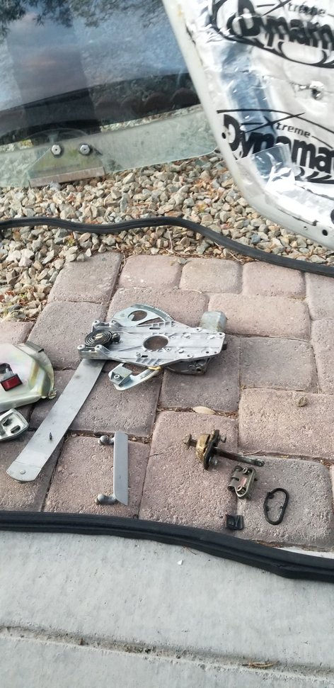

thanks for the info. Im in the process of gutting the door to be removed for painting....this was the last step. i dont have those bits And like everything else now, im looking at replacing the door catch while its all out.
edit...actually i did have those bits, So now it's just 6 hex head bolts and the doors can come off. Painters can handle that. Doors are gutted..,..glass...motor and assembly...door latch..lock..mirrors..
