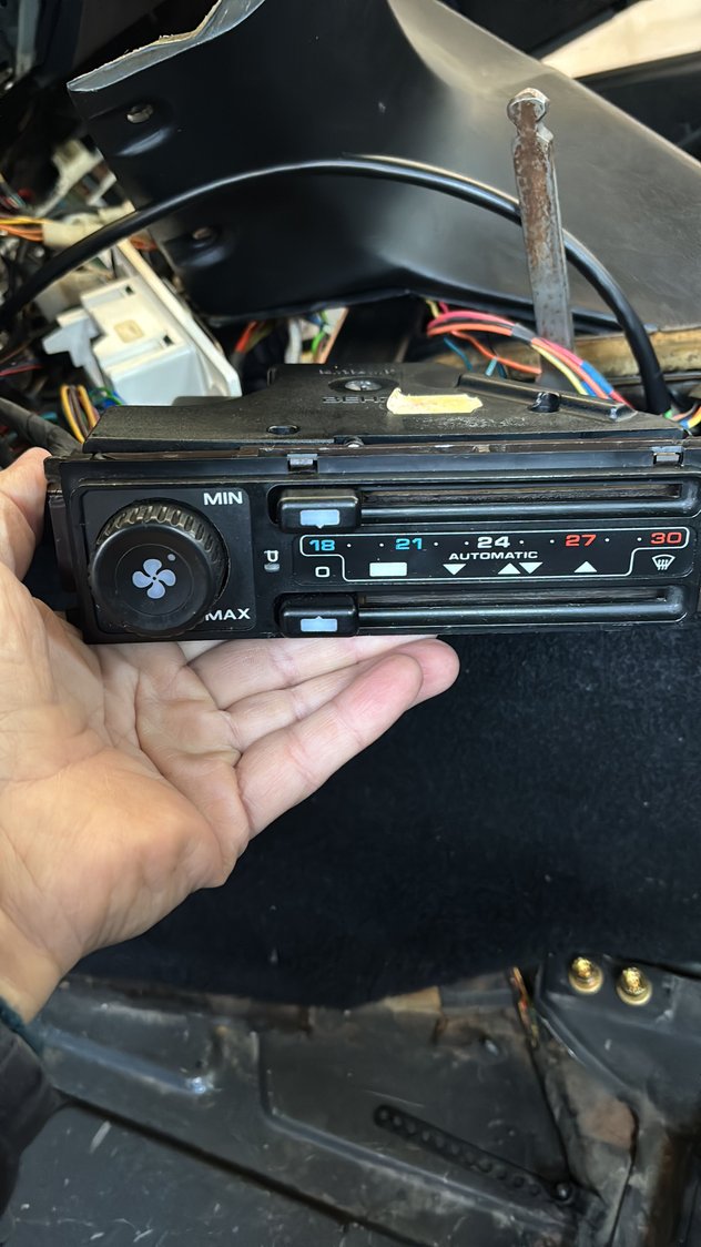

During the restoration of my 928 GT, I removed the center console and sent the climate control unit for overhaul, but I ended up installing a previously overhauled one. Now, what happens is that when I turn the ignition key, the fan comes on even though the fan speed selector is set to zero. Any suggestions on what to check? Could it be a slightly different model of control unit? Thanks.

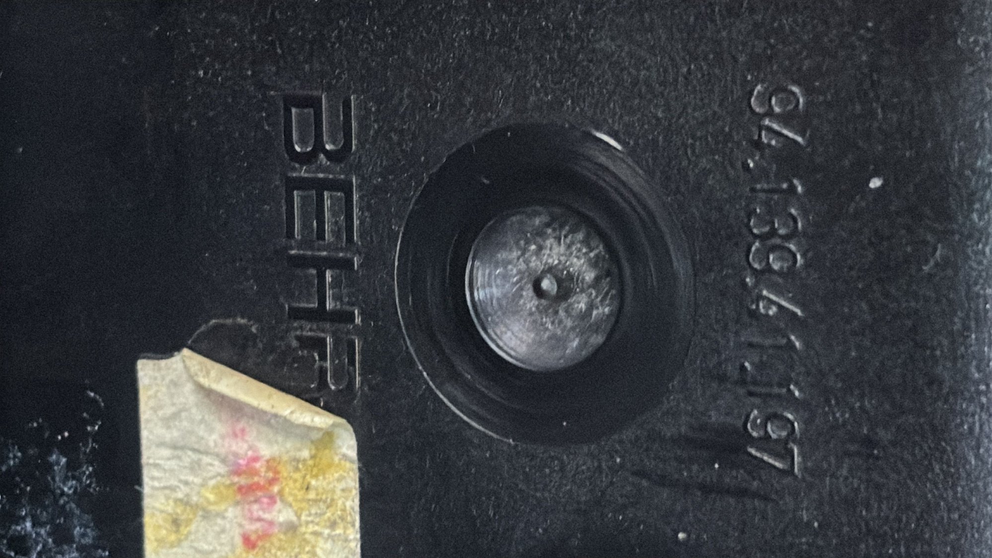

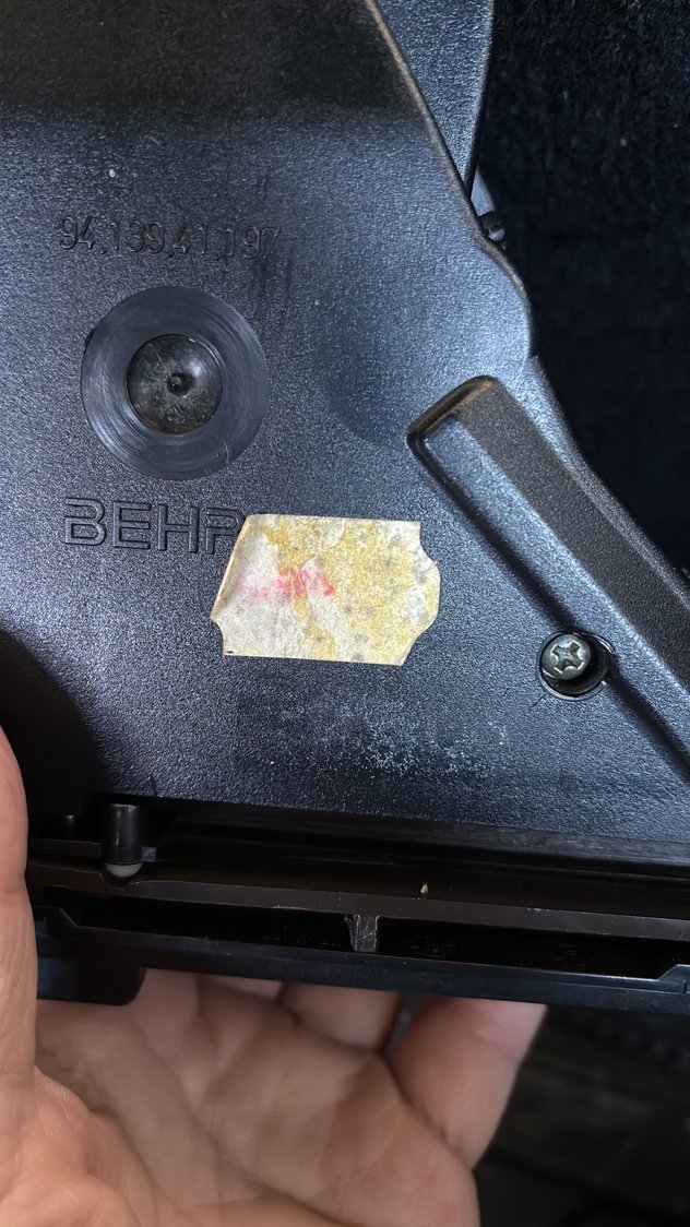

Are the front panels the same, the older HVAC head units had a "0" or off for the fan, the later ones do not and the fan always runs on low.

Should be a part / model number on the units, also I do not know what MY it changed for Off to Low.
I do know the 86 and earlier the blower motor can be turned off.

There is a subtle difference between the S4/GT unit and that used in the GTS's like mine even though in my case the early GTS models came kitted out with the same system and R12 refrigerant. I think the R134 variant emerged half way through MY93 and I understand it has the same unit that was fitted to my 92 delivered GTS.
This I suspect the OP may have the GTS panel unit. There is some difference on the control buttons and when the relay went in mine initially I swapped out the GTS unit for the one I lifted from my wrecked 90S4 that was wrecked back in 2005.
If of interest to the OP I could take a look and compare the units tomorrow. Whether or not the reverse swap - a GTS unit into a GT works I have no idea but I suspect it probably will.

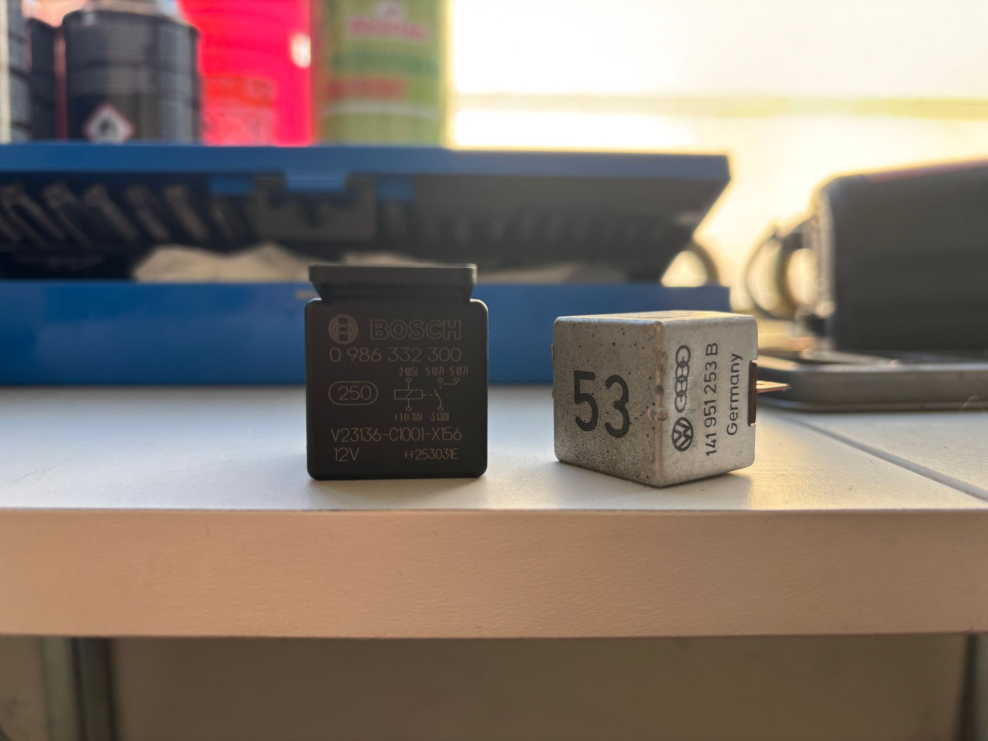

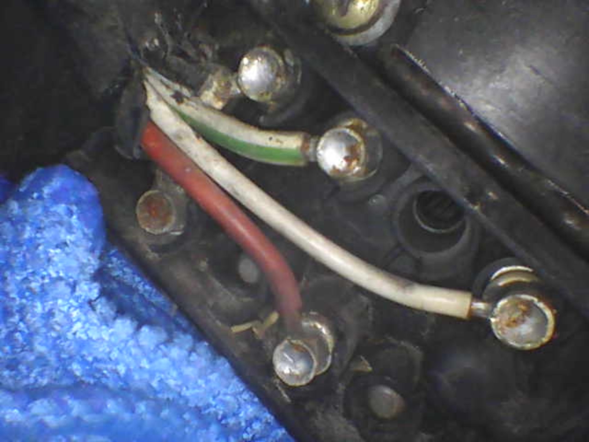

First of all, thank you for your help: Here the pictures you asked me for!
On the right the previous relais I have, on the left the new ones.

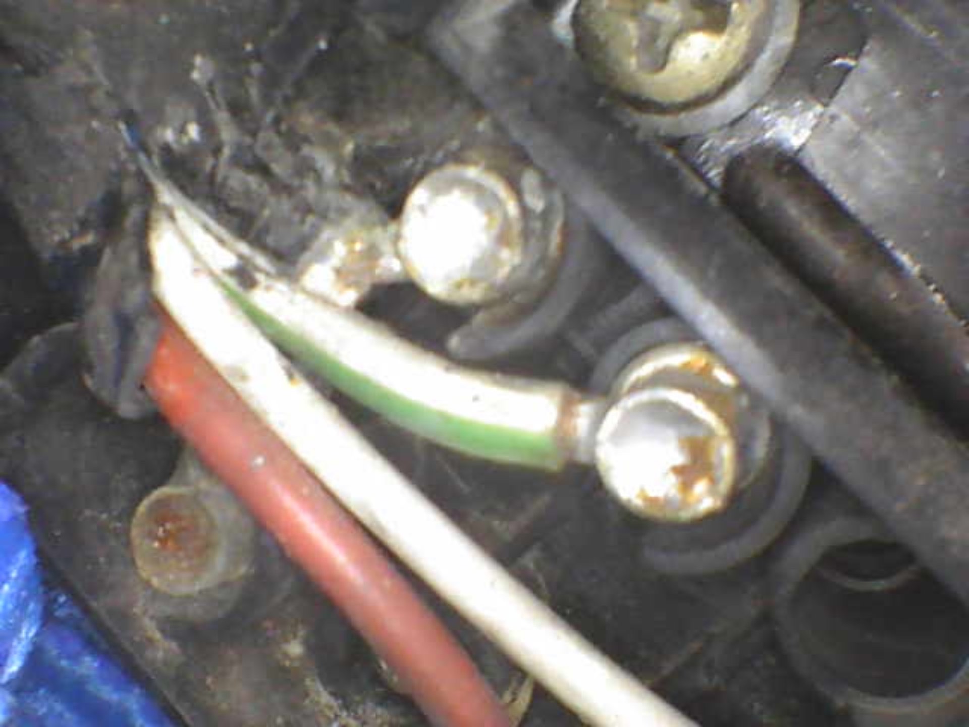

3) When reassembling the passenger seat, I mistakenly inserted the brown wire above the red one instead of the black one. At that point, NO MATTER WHAT BUTTON I PRESSED TO MOVE THE SEAT, THE FAN STARTED AT FULL SPEED ! Furthermore, the A/C control unit light also came on!

You are right, but I already checked this, and the fan starts both with the original relay (53) and the newer one I have installed.

I try to clear better what happens: if I have the relay seated in the slot XIV, as soon as I turn the ignition key, the fan blower starts at max speed (like defrost). If I remove the relay, the fan doesnt start BUT when I pressed ANY switch of the passenger seat WITH THE WRONG ELECTRIC CONNECTION (see image) the fan blower starts at max speed, like defrost mode.
Actually I have connected correctly the passenger seat and removed the relay XIV and anything seems to work except, obviously, defrost mode
