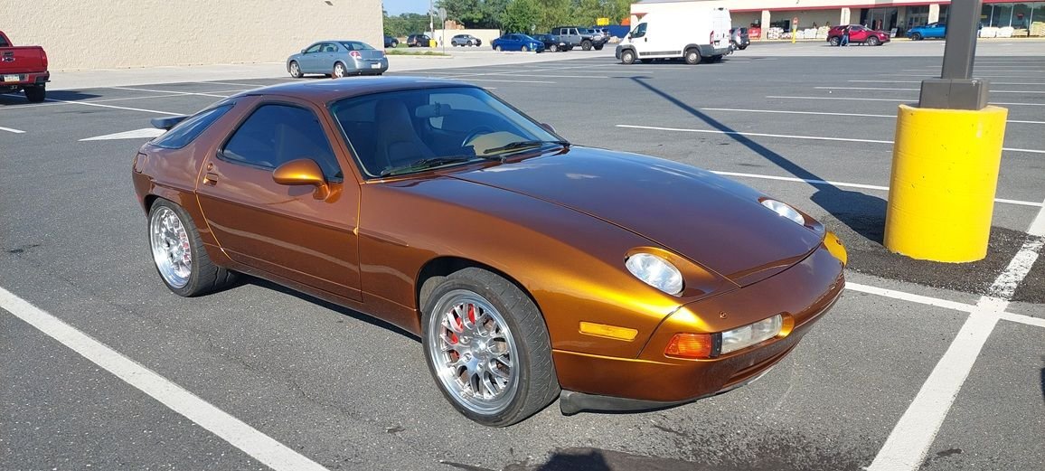

Would you mind sharing the product and equipment details? I had mine liquid wrapped with gloss top coat last year by a shop that specializes in it, but would prefer to do it myself on our other vehicles.

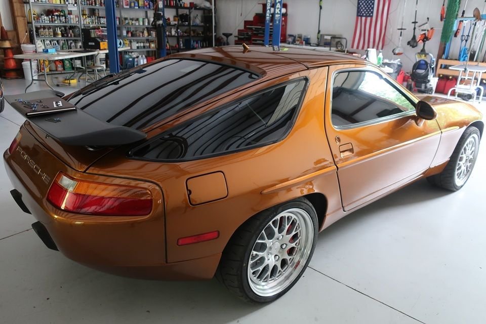

On mine, I think that they sprayed right over the rub strips, then went back and used a razor to cut the line so it would lay down and not bridge the gap. They masked all the rubber bits for the sunroof, but even without, it's easy to peel off of things you sprayed it onto and don't want it on. Think of it like a cheap paint job. Mask things up and go for it. But, reversible. Unfortunately, they didn't do as good of a job as I would have liked. If we connect in person, I can point out to you all of the things that I've found so far. I got what I paid for, but I wish they would have charged more and done a better job. But, for what it is, it's great. Looks fantastic from 10 feet away, and still very good from 5. And worlds better than my original paint.
It's got an automotive clear coat on top, so it can be waxed, buffed, ceramic coated, etc.
No problem operating the sunroof.

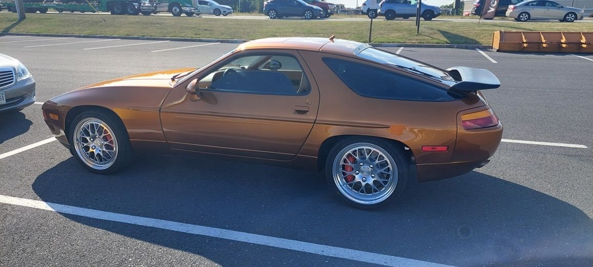

Sterling's is more brown, right? This is the color "burnt copper". Side by side, they would look quite different from each other. Mine isn't a color shift, but it does look a bit different depending on the lighting. And it has metallic flakes in it.

One thing about the clear coat on top of the peelable paint...no one has ever guessed that it was peelable paint until I told them. It's that good. It changes the finish from being obviously plastidip, to just looking like regular paint.

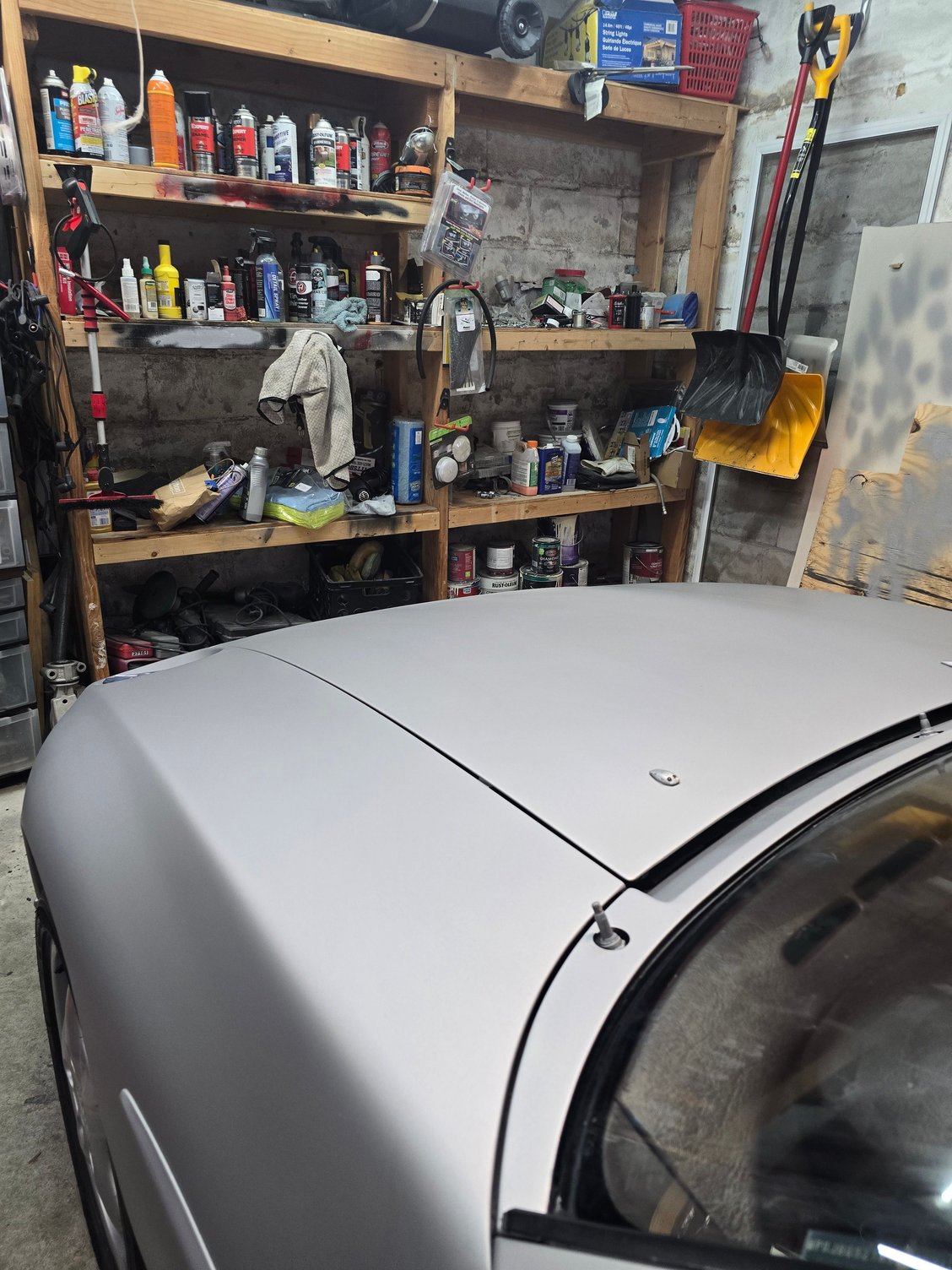

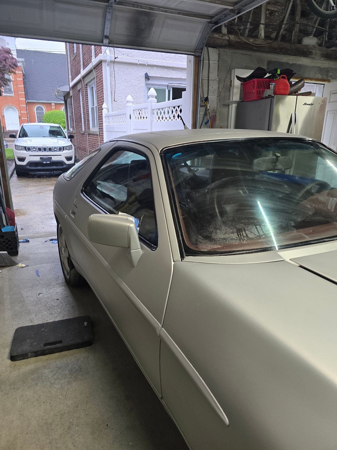

I have Plastidipped my car three times using the sprayer from dipyourcar.com: burnt copper, gunmetal gray, and sea blue. It's easy and a very forgiving process. So, even an amateur like me can do it. A few things I learned:
- If you're going metallic, use a color-matched base coat. Otherwise, the metallic might look thin or flat in some areas. (Metallic flake is mixed into a clear dip).
- Apply enough coats to make it easy to peel off (four is probably right). If the application is thick enough it peels off easily, like a giant balloon skin. Too thin and removal is a royal pain and requires either applying more to thicken the coat or solvents to dissolve what's on the car.
- Stuff up the cracks. The Plastidip gets everywhere, so if you don't block your body panel gaps you will find overspray in the door jambs, under the hood, the hatch, etc. for a very long time. It is a real nuisance in tight spaces like around joints, hinges, etc. For much of my overspray I had to go back and remove with solvent, a toothbrush and a lot of elbow grease.
