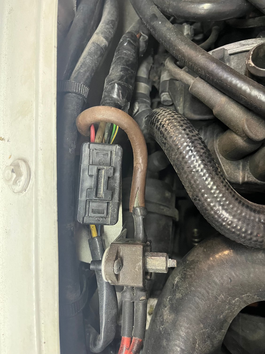

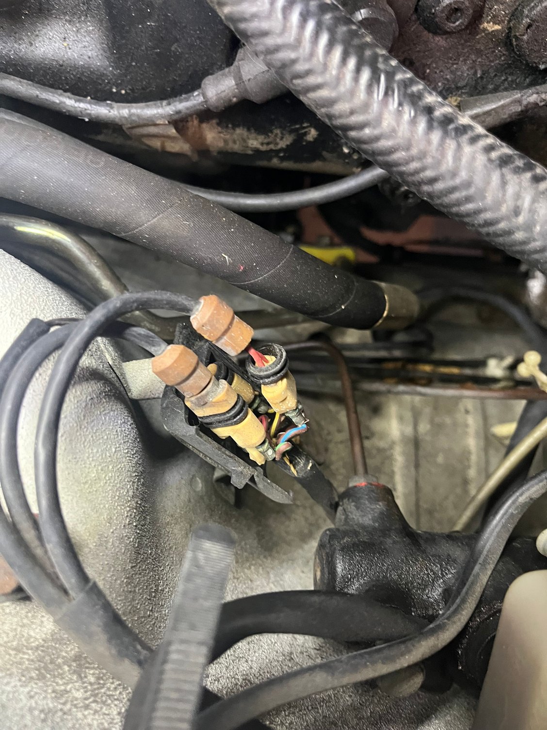

My new to me 90 S4 still hasn't made it to the house, still working on making space in the garage but hope to have it here soon. In the meantime I've been hanging out at the ex mother-in-law's where it currently is, tinkering a little. I thought about buying a battery and seeing if it'll start but I'm also finding little things here and there that make me wonder if I should tow it here and start tearing it apart. Looking for wisdom and guidance. I downloaded the manuals but for some reason the wiring diagrams didn't come with so I need to figure that out. My biggest questions right now is some wiring and connections I found in the engine bay, I'm attaching pictures of some of the questionable things. Any thoughts and guidance would be greatly appreciated and if anybody is in Wyoming or near
The connections in the middle of the pic, what are they for? The ones on the other side of the engin bay are in worse shape and in a pic below
When I touch these connectors they start to crumble

The picture with the bigger brown wires I can see electrical tape so I know someone has been in there.

Photo 1. That knock sensor, I think. The plastic part on the sensor side always falls apart like that. You can replace the sensor or just the connector. I'm cheap and lazy, I would replace just the connector. I have a few sources. I think Roger has it. There are two knock sensors, and the cam position sensor which are three pin connectors like that and they all fall apart.
Photo 2: Those are the main wires from the battery. They are meant to be red, but have decayed. Disconnect the battery and go over all exposed wires in this area. Look under the tape. It can be fire hazard when the wire jackets fall off, which they like to do. I use heat shrink, but you can replace the engine side harness it you want for medium money. $1000 ish, I think. I repaired mine. There are two covers missing. One for the jump post, and one for the whole area.
Photo 3: Not 100% sure if those are for the ABS or the break pad sensor wires. Both of these harnesses have plastic housings that just crumble. I don't think there are replacement housings. I deal with this by crimping in bullit plugs and sockets on the break pad sensors and just removed my whole ABS system wiring harness. I'm sure there is a better solution, but I don't like ABS so this is fine for me.
