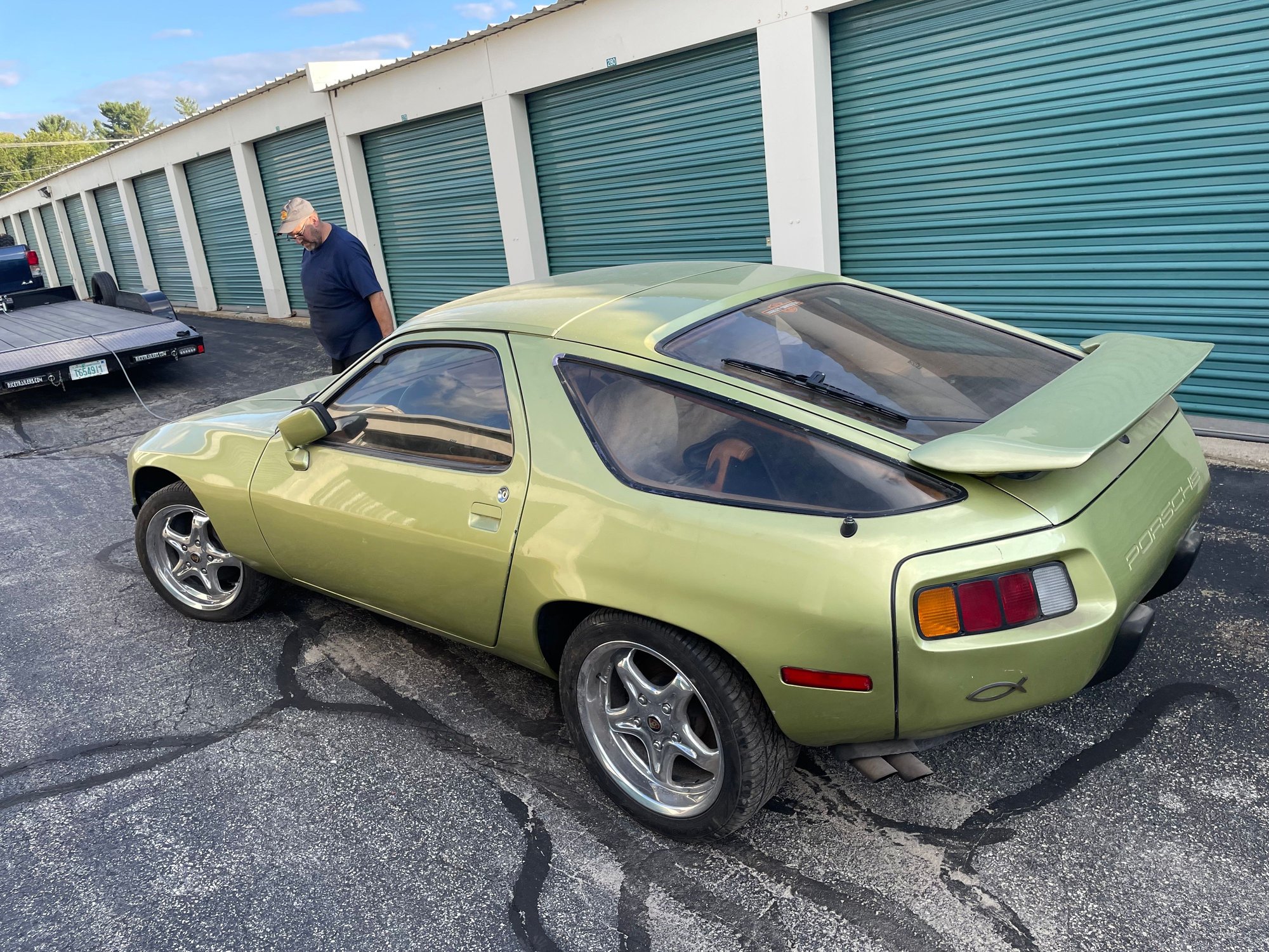

I need some opinions, my grandfather passed away about 2 years ago and he gave me a 1979 Lime green 923. (I am not a car guy)
When i was moving it into storage last year, it start briefly then died. The wiring system is complete junk, the front dashboard is all taken apart. I was speaking to my uncle and he was mentioning the possibility of replacing the current engine with a corvette engine, as that year had a lot of issue and it would make the car "turn key" in a sense. My question is, do i just dump money into fixing the current motor and pay for it to be completely rewired or should i replace the motor so I can have a newer electrical system so its easier to fix. The car was stored in a garage for years so there's no dents or dings on the body, its mint to say the least. My uncle restored it probably around 2015 and it was driving but then the wiring issue came up and he could'nt fix that himself so it sad in the garage for another 6 years.
I have had it in storage for a year & half and i finally have enough money to potentially fix it now. Please let me know your thoughts and potential options for fixing it.

No roof, and no rubbies. Get rid of that spoiler and put some period correct wheels on and it would be a good looking car.
@alapiana
I missed those details! Yes both would significantly add the rarity and collector value of this car'
