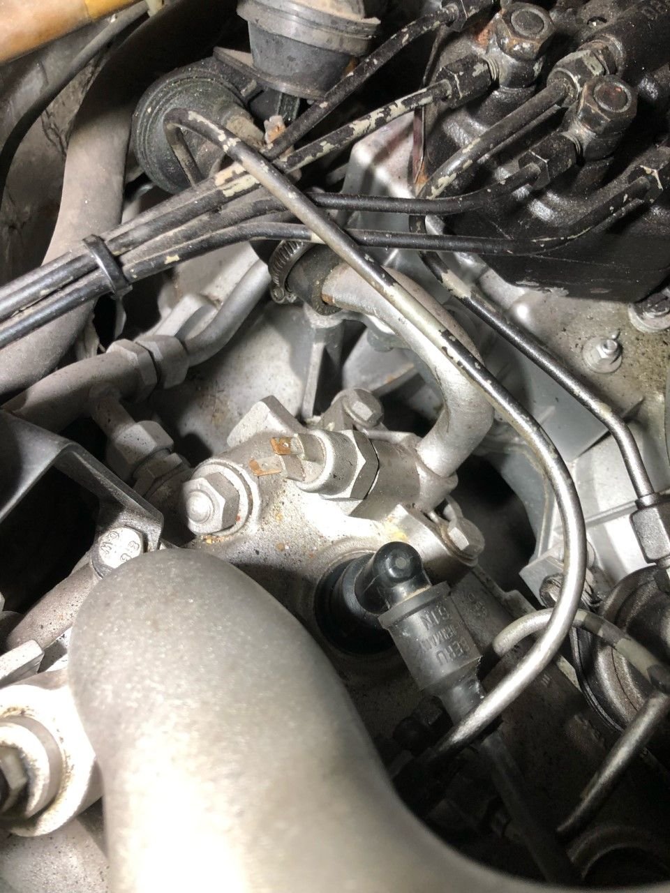

But there are some wires and sensors that I can not identify where they go (see pictures attached)

that ground lug might be one of the fuel injector grounds it should be anchored to the top side of the right cam tower.
The other 2 electrical connections one is a temp sensor that works on the fuel system,
the other is for a fuel cutoff,
if you can find another owner that will take a picture of what they have,
yes you need a same year euro. a picture could be worth a thousand words.

Indeed, I put the ground lug in the right side of the CAM tower.

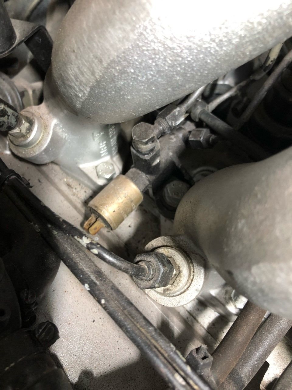

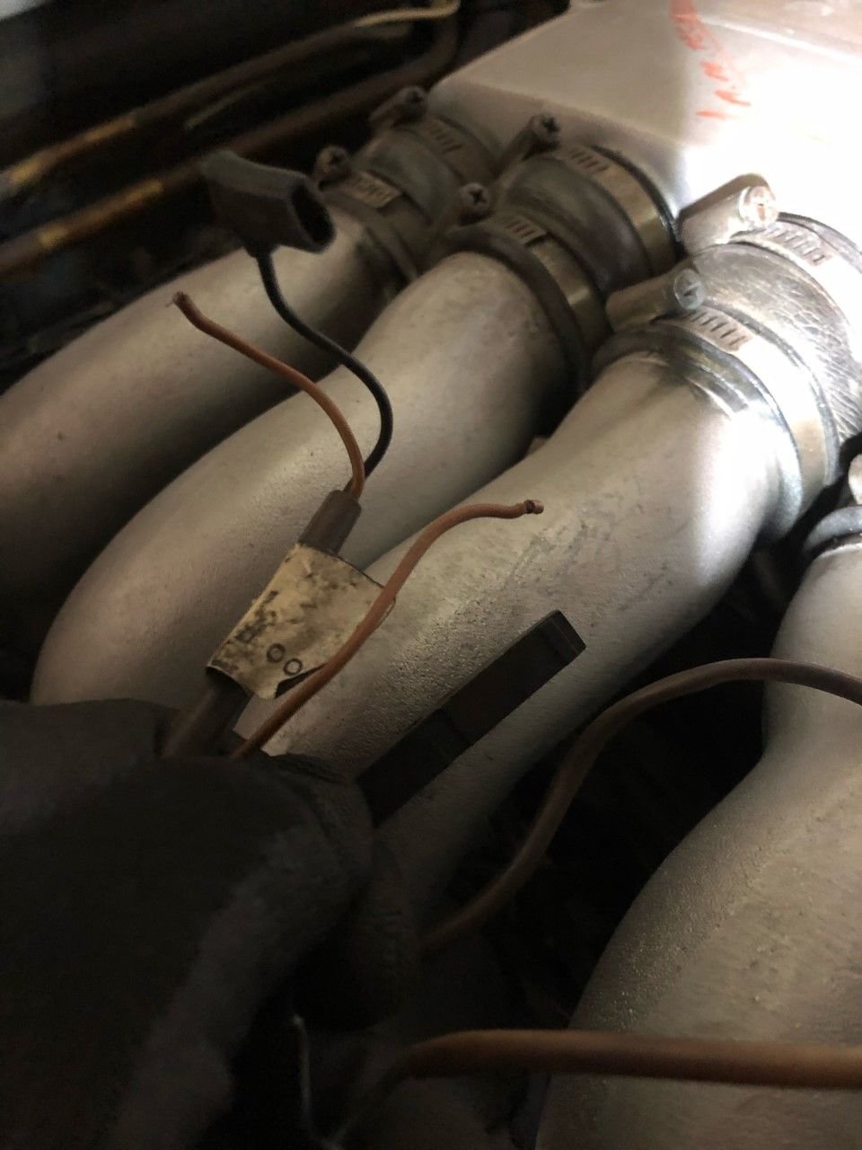

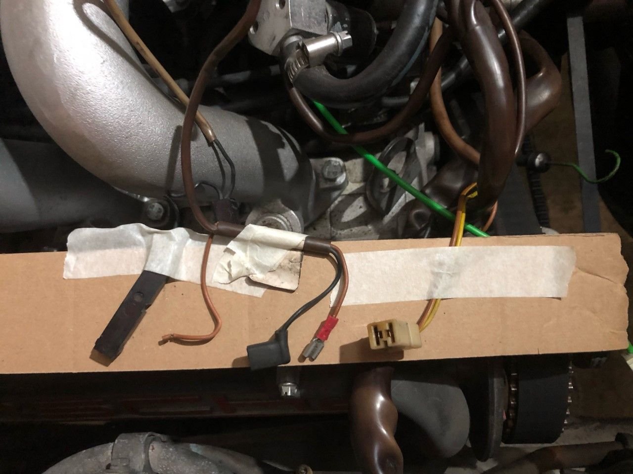

I herewith send the remainig wires from the front harness that I don't know where to connect. And the sensors that are pending to wire.
If any one has a 1980 Euro model, please tell me where to hook up these wires,
THANKS

Are the two unconnected wires in photo 1 with the female spade connectors in close proximity to the unconnected temp sensor in photo 2 that has the two male spade ends?

The two unconnected (female connectors) have a wire long enough to reach the sensor shown in photo 2 or even the other sensor (photo 3)

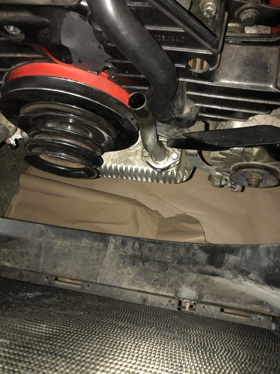

Can you send an up close picture of your installed harmonic balancer. If it was inadvertently installed backwards (easy to do), you can have fuel, spark, and compression, but it won't be at the correct time. It will be 180 degrees out. If it is on backwards, just remove the balancer, turn it around and reinstall.

I belive it is correctly mounted. See enclosed the picture.
Thank you all for you patience.

Wait a minute Soontobered84, is the harmonic balancer backwards?
It may be.
Can anyone confirm??
It may be.
It is hard to tell from the picture, but that looks backwards. The numbers should read correct-side-up when standing in front of the engine.
That would explain not starting with starter-fluid, but the electrical connections may still be important for the K-Jet.
