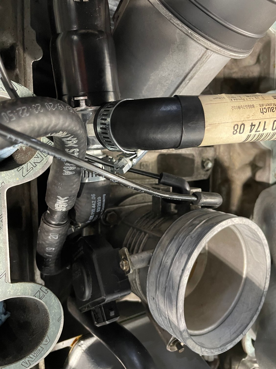

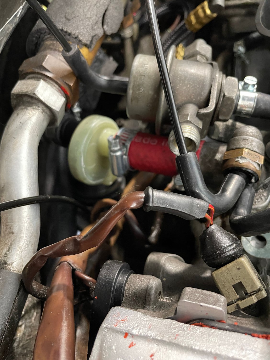

Thanks for the help, folks. I'm slowly making progress. Please see the photos attached. I am at the stage where I am wondering if I'm ready to install the intake runners. At the firewall area, I have the heater valve installed, a vacuum nipple on it, and the vacuum line seated. The two "bulkhead" fuel fittings are secured, as are the FPR and rear FD, and the hose clamps secure for the rubber line that feeds the FPR. At the throttle body, the only hose I'm not entirely sure on is the one that is seated on the drivers front side, that now terminates near the DS valve cover. It's somewhat L shaped. I'm pretty confident I've got the rest of the vacuum lines at the throttle body seated correctly. I was hoping someone could put a second set of eyes on these connections, as it seems that once I install the intake runners, access to the throttle body either goes away entirely or gets extremely tough. Also, per Roger's instructions, it does not appear as though gasket sealant is used on the gasket for the intake runners, correct? Thanks for the help!
