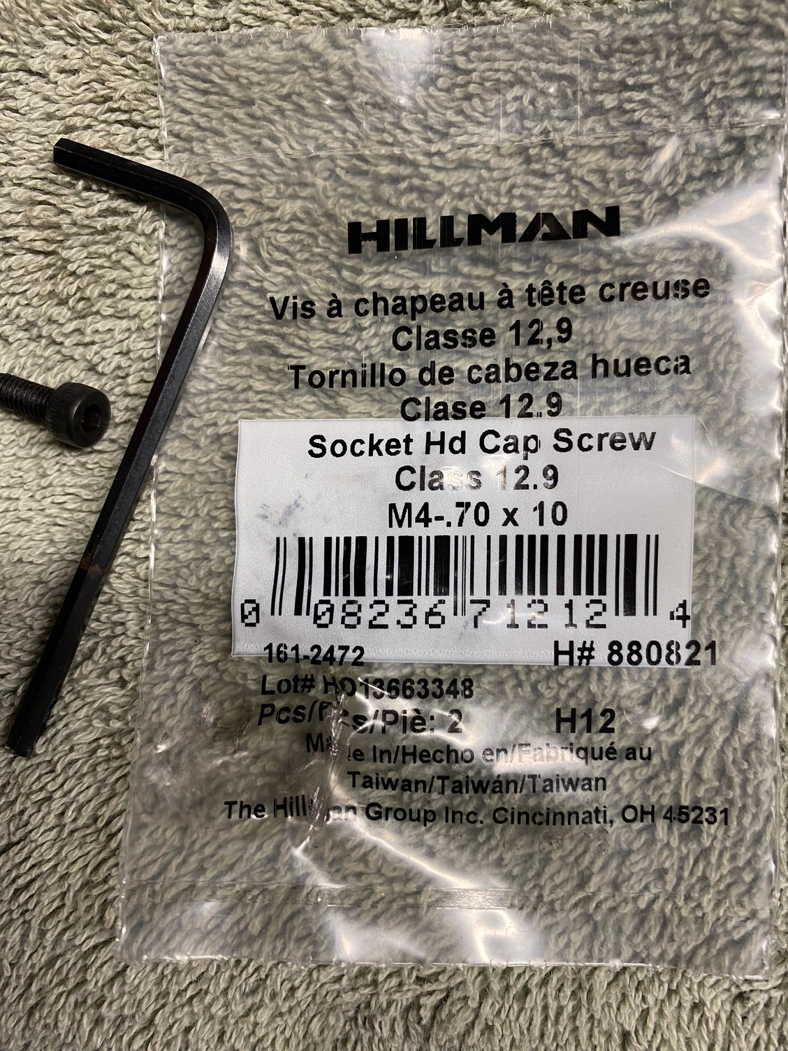

I was reading that someone replaced the 2 slotted screws holding the ignition switch with some hex screws for easier install-
anyone know the size?

For anyone doing this job-
scrap the factory slotted screws and go this way on the install-
keep your piece of mind!
