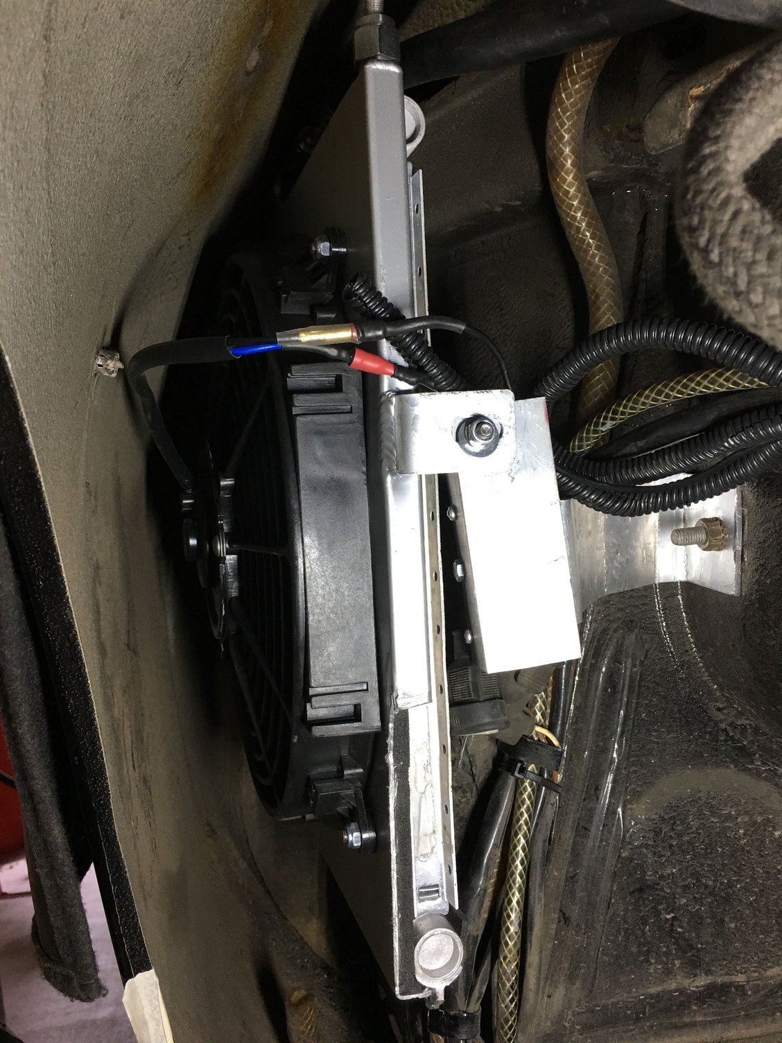

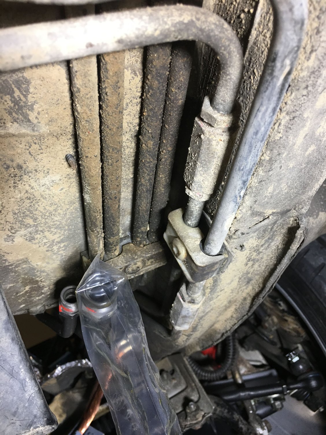

I left mine in place and plugged the two lines beneath the car along with manufacturing a plate to cover the connector under the car. It's worked great and I occasionally check for leaks with my refrigerant sniffer and haven't
These are the 2 I plugged.
I also installed and added condenser where the washer bottle was installed.
found any.

Tracy,
I believe Greg Brown mounts his secondary condenser and condenser fan in the same location; so you seem to be in good company.
