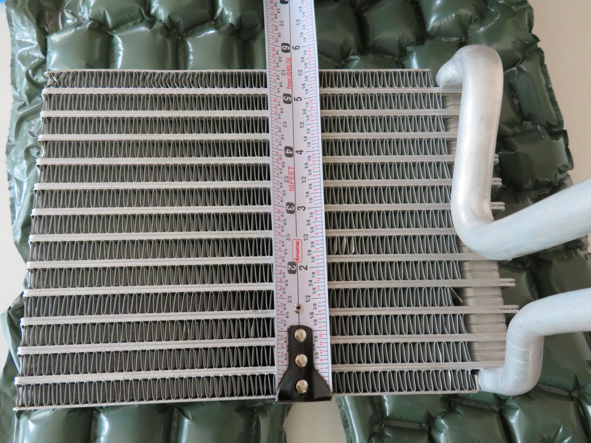

928 Fixer,
Yes, I got a used one from 928 International; however, it too had leaks. I've been working with a radiator shop to try to repair it. but is seems to be putting up a struggle. This is why I’m on a quest—hopefully not a Quixotic one—to find a new rear evaporator.
Yes, the rear evaporator is leaking. A dye test identified the leaks in the rear evaporator at some of the joints between the copper tubes and the aluminum core. Why the "928 Wizards” didn't make the whole thing out of aluminum I don't know. On the other hand, this OE design has lasted ~32 years, so who am I to judge.
The same dye test that found the leaking rear evaporator also identified leaks in the OE A/C hoses. As you know, the "928 Wizards” designed the OE hoses to leak R12 to avoid anyone ever over-pressurizing the A/C system. Unfortunately, I didn’t find out about this until this year. So, when I converted my 928 last year from R12 to R134a, the hoses leaked more. This s why I'm replacing them with barrier hoses.
Life would have been so much simpler if it were just the O-rings.

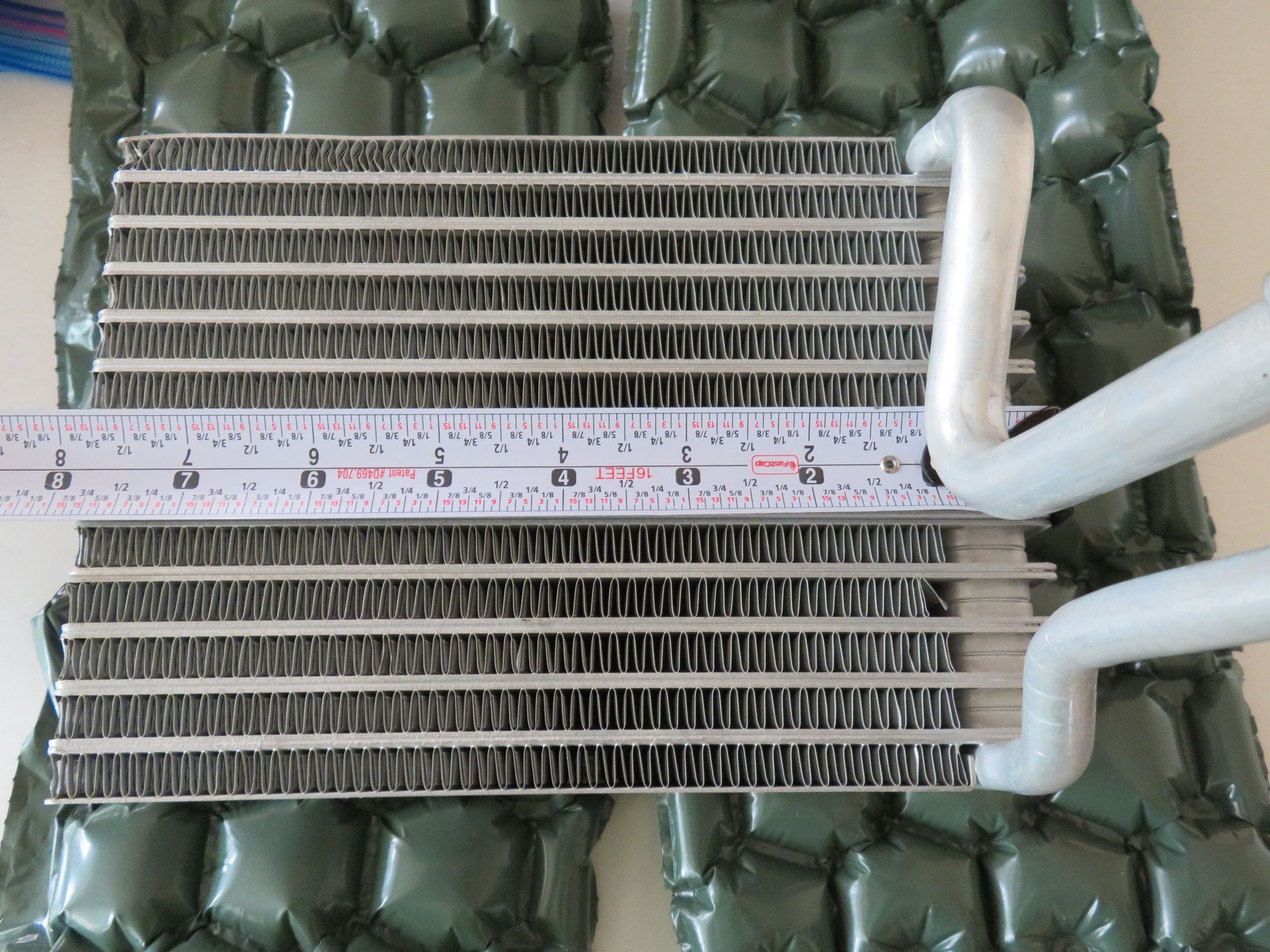

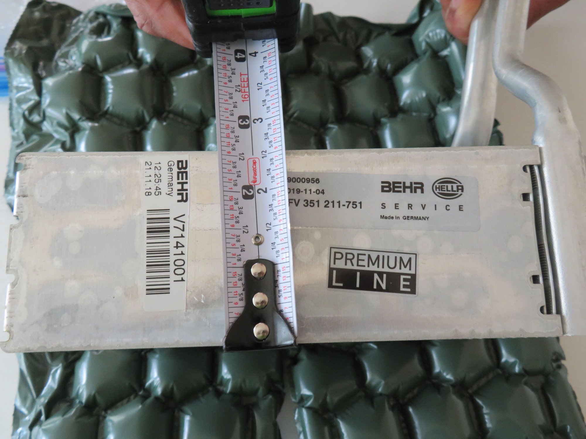

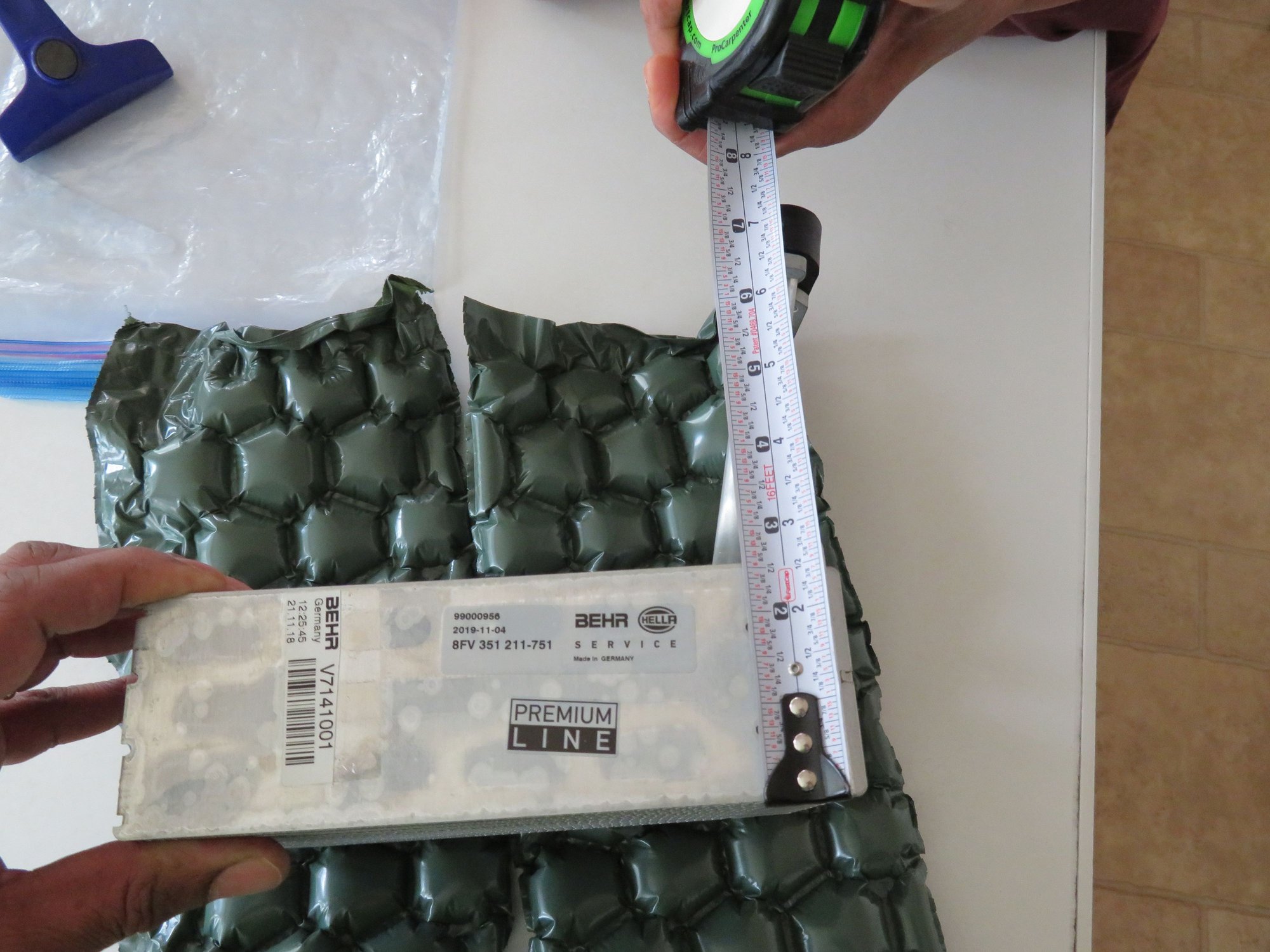

Karsten,
It seems repairing evaporators and radiators--especially ones made from dissimilar metals--is a lost and/or dying art. I would love to get a new part; hence, "the quest". I just have to find the right manufacture. I found a new Behr evaporator used on a "Vito Transport" (see below) that would fit the rear blower box. However, my radiator shop tells me that the modifications to the inlet and outlet tubes to have it match the OE tube locations--so it could mate to the expansion valve--could introduce more weak points that could manifest into new leak points.
Why is such a small part so hard to make and/or source? Wouldn't it be nice if someone in "928-land" had a new one just lying on a dusty shelf so I could buy it? Yes, it would be...
