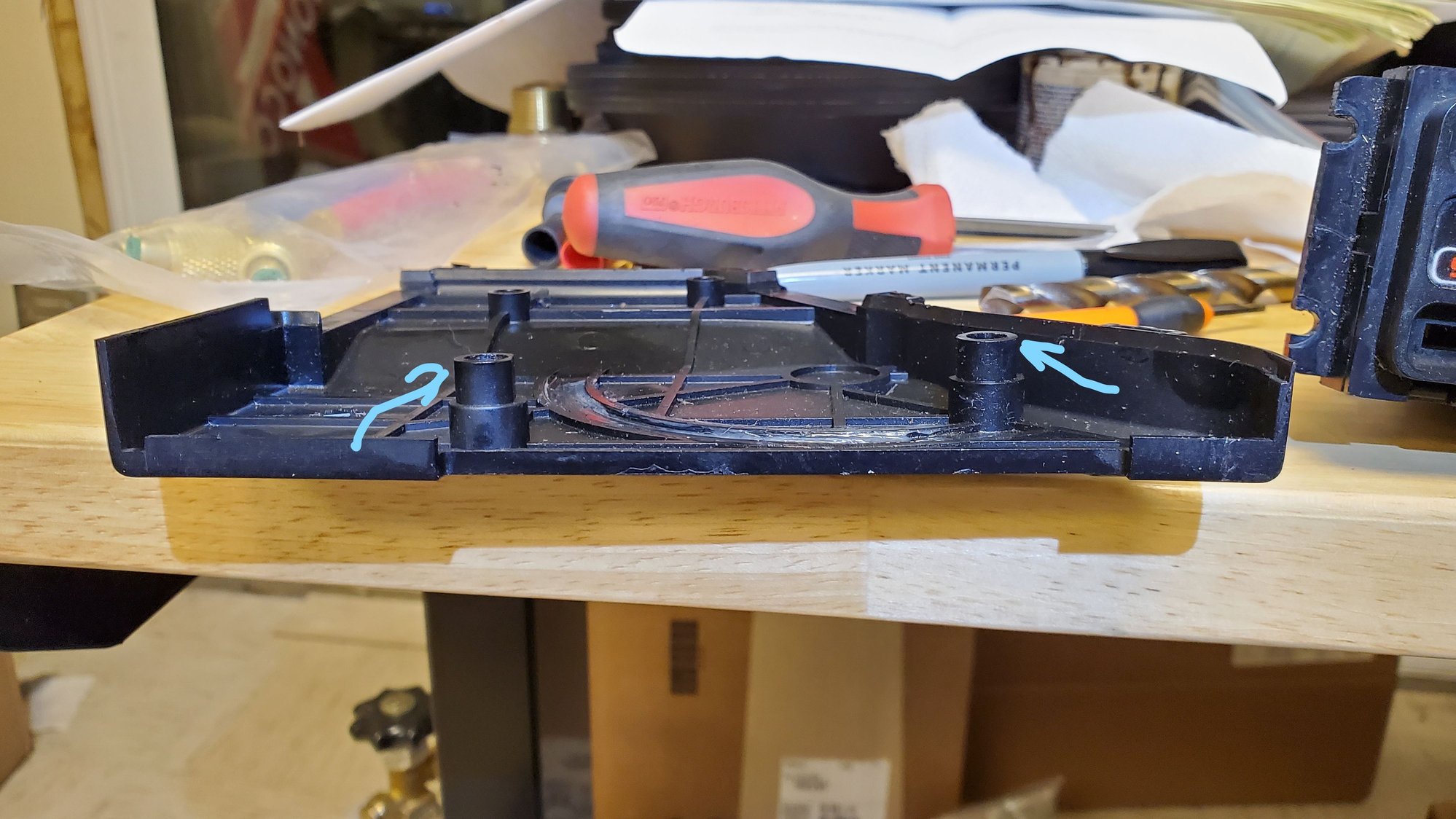

The 1981 Automatic AC does not have an AC switch on the console. The AC is automatic. The compressor stopped engaging. But could be engaged with power to the frost switch on the HVAC unit. Turns out the automatic slide switch can wear slightly and not engage the power from the slider switch (slider shown in pict 1) The solution is to reduce the clearance to the cover, pushing the slider down to the printed circuit. Only about 0.040" reduction in height is required, see pict 2. The slider has a triangular top, shown in pict 1, a small amount of wear, allows the slider power contacts to not make contact. On close inspection, you can see the felt marker, black, on the connector for the AC Clutch, Pins 4, on the smaller connector, and 9 on the larger connector should show continuity with an ohm meter, with temp control in Normal.
slider shown with arrow
reduce pin height about 0.040"
