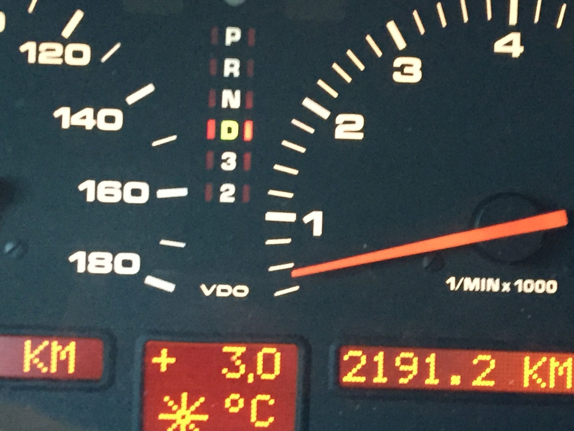

Hi guys
reaching out for help on my low idle
car starts fine it’s a 1990s4 auto with 70k miles
after around 20mins driving and once warm the idle is very low ie sub 500 in park and will drop as it shud even further in D this gets progressively worse as the car gets up to normal temp to the point it stalls if in gear which looks around 300rpm with a bit of shifting in and out of N you can keep it going but now impossible to drive comfortably after a while
ive tried battery reset and used the udt999 tool both with lights on etc to try idle adaption—
the battery reset makes no difference and the udt999 software says error after 60s ??? I think it says unable to perform can’t see why
Both lh and ezk and maff checked by john
any ideas ?
Cheers
johnny

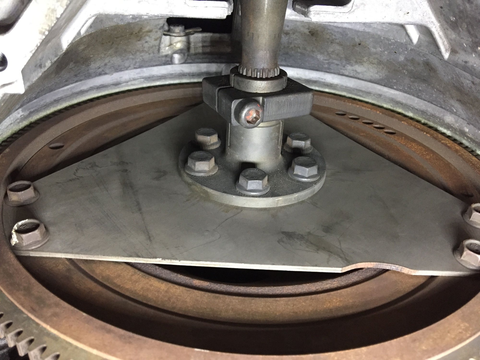

When is the last time you checked your flywheel flexplate end play?

Check all the driveshaft bolts and crank endplay as Speedtoys suggested

Irrespective of whatever problem is in play, have you done anything to check that the flex plate couplings are holding, that the front plate has not crept and that crank end float is as it should be at around 0.2mm? This is something every S4/GTS owner should know and be aware of.

i checked and reset the flexiplate around two years ago when got the car it moved a bit when released but nothing drastic

The info that idle speed is slowing down when fully warmed up is the bit that concerns me as does the fact that you found some pre- load tension earlier and released it and now perhaps think "all is well".
Many examples show slippage of about 2 mm and live to tell the tale. Sad to say some do not. Given we are looking for something that "explains the problem" when hot, the fact that you found the slippage previously should be of concern, especially if you have done nothing to mitigate this engine killer permanently. A sad fact of auto ownership is when one starts the car one day and finds it is seized- often that is the first clue. To be clear, I am not saying this is the issue but it is not hard to visualise why a hot engine might slow things down if the flex plate clamp has slipped ever more than previously and friction generated when hot is heating things up more than usual- it is not something I have noted in the many cases I have followed [with interest] but it is something you need to eliminate as a possibility. As I m concerned the slipping flexplate is a pre-cursor- a warning if you like that all is not well and something "bad" is going to happen if not taken care of promptly.

You should eliminate the possibility of flex plate clamp migration ASAP irrespective of anything else that may be causing your current issue.

Hi checked the flexiplate it’s sitting very flat no movement since I adjusted it checked with steel rule

A good result on the flex plate check. I use some white paint to index check for small movements.

Fred and others reading this if one of these engines is suffering from flex plate pressure careful listening can provide clues that it’s happening
this can be backed up by hand turning the crank and pulling the dipstick and dripping the oil on a black piece of paper then looking at the oil in the sun
sometimes I can hear the slight screeching sound or the engine laboring at idle or worse a very slow cranking from the starter motor once the engine is warm
Note these are very subtle indicators but most are present when an engine is having this issue
