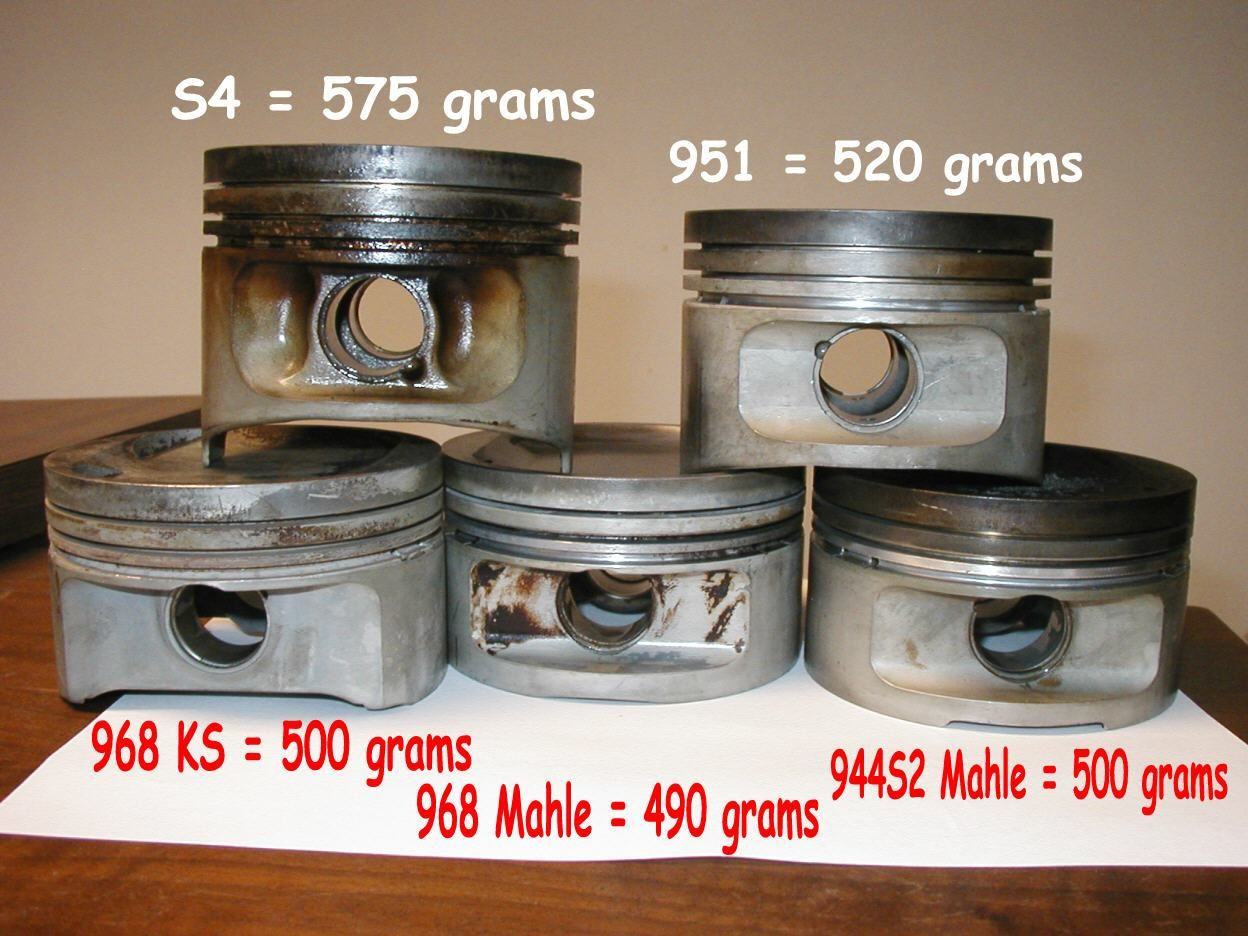

From a 944. Have a set of eight with wrist pins

What diameter?

Originally Posted by GregBBRD
What diameter?
100mm

I think they are 951 Turbo Pistons.
I'm not st the shop to check my samples, but that is what I think, too.

confirming that those are 944 turbo pistons.
those were 8:1 compression in a 944 and a 928 has 2mm or so more deck height - youll be way down in CR or need a longer rod/stroke to bring to the deck.
those were 8:1 compression in a 944 and a 928 has 2mm or so more deck height - you'll be way down in CR or need a longer rod/stroke to bring to the deck.
I think the P.O. had supercharging in mind, but not sure. His goodies also included a cross drilled 5.0 crankshaft. I'm wondering what I could build with those a starting pnt.
If you’re willing to spend on custom rods, then you can build a forced induction Alusil engine using them with a little higher redline rpm than when starting with an ‘87 S4. You need machine the piston top somewhat to accommodate valves with valve reliefs and also shape the dish a bit to improve tumble. Rebco can machine the pistons economically.

GregBBRD's Avatar
GregBBRD
Former Vendor
Joined: Feb 2005
Posts: 15,228
Likes: 2,530
From: Anaheim
Or, find another 85.9mm GTS crankshaft, use a stock S4 rod, cut 1.5mm off the top of the pistons, and add valve reliefs.
Toss in some GT cams and have a fun little "GTS style" engine.
those pistons on stock 928 rods and 5.0 crank will put your CR below 7:1.
