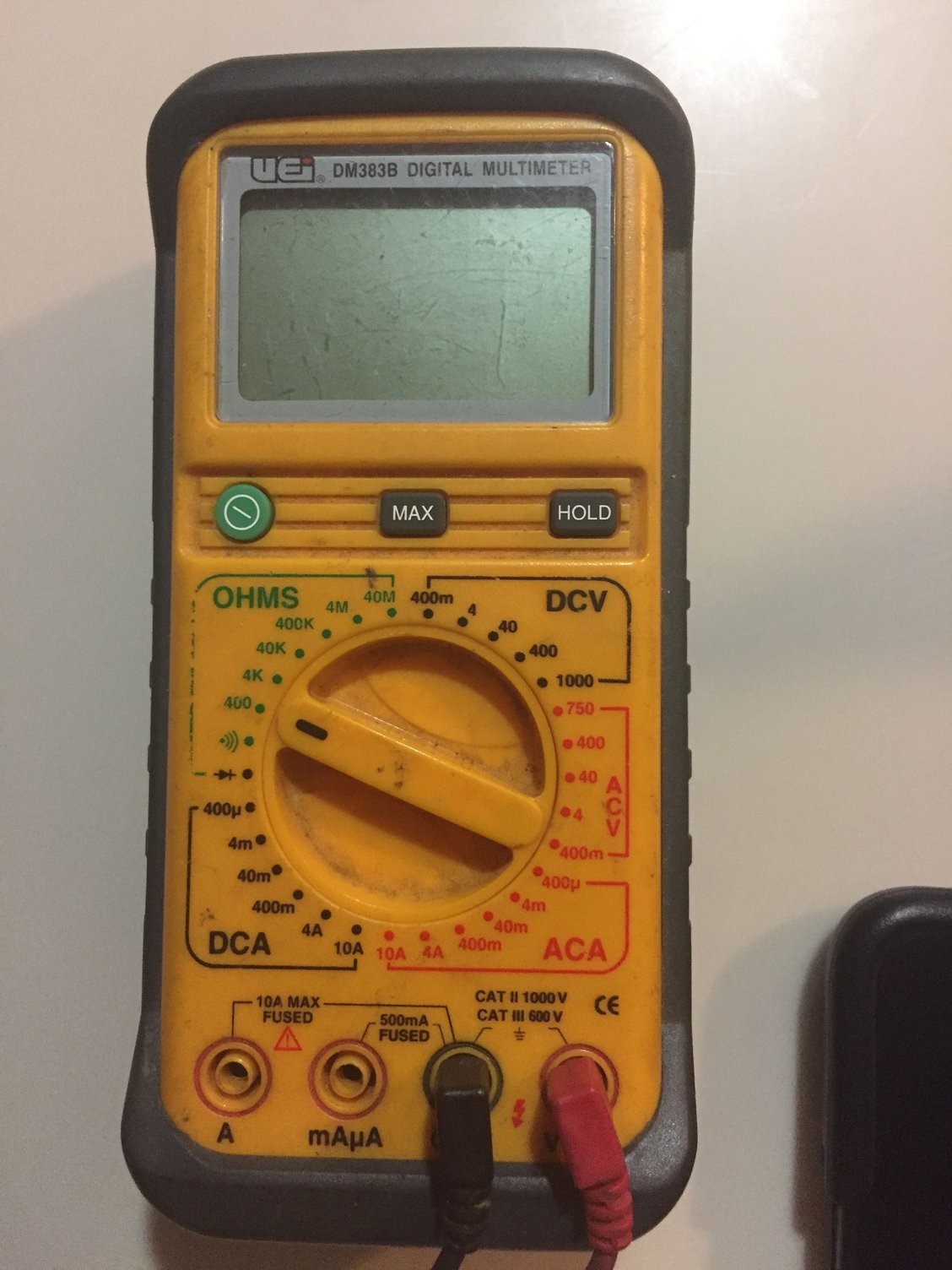

Here is my multimeter. What settings do I put it on to check.

Measure with the car running, not the starter cranking.

DCV 40. Probes are in the right place.

Car idling and reading 13.86. Cooling duct connected correctly. Just crazy behavior of my dash reading I guess.

Yep. Great readings. Problem is going to be the circuit foil on the back of the cluster.
I looked at your volt meter and went cross eyed. Been a while since I've looked at one with so many options. Catch me next year and we can goof around with yours and mine.
