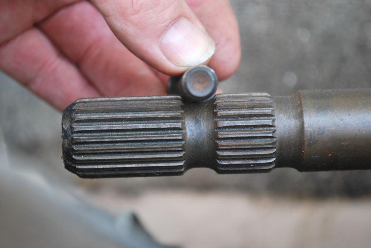

please see the picture it looks like there's too much spline showing based on a write-up I read on a 93 928 GTS.

Yes way to much.
Looks like the shaft moved to the back. You'll need to check the back for sure.
The front should look like this.

I should have mentioned I am reinstalling a new/used motor after TBF.
Do I just loosen the rear pinch bolt and move it back?
Any suggestions on how to do this?
I have the plug out of the rear pinch bolt location and have loosened it a little, but may need to do more. Also sprayed pb blast liberally in the tt hole.

Ok, I see.
You need to move the shaft forward until everything is well aligned.
Make sure the front bolt is lose. Remove the back bolt and aligned everything.

I can tell you exactly what is happening here Ryan.
Your rear clamp bolt is installed in the shaft neck-down area, instead of in the shaft cutout where it belongs.

Something looks somewhat out of whack there- has the drive shaft been displaced rearwards by any chance?
The rear pinch bolt is not adjustable as the bolt engages a detente in the shaft. Sounds as though you need to inspect the rear bolt and more to the point fit a new one but before that you need to ensure the detente aligns with the bolt hole and that the assembly has not been chewed up as it were.

I encountered the exact same problem. Read this thread:

Mark, you just used the right words to what I was trying to show with the pic!

Pretty obvious why the prior engine suffered thrust bearing failure !!!! Clueless " mechanic " .
