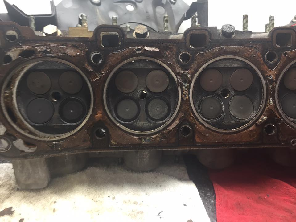

I wondered when the slippery slope would stop....or if it should. The head gaskets I've been seeing are absolutely terrible and if I was this far, I'd probably suggest to the client to take the heads off.
Some of the late '86.5 engines had head bolts and not studs. You might take a look, since if you have bolts, the heads can be removed with the engine in the car.
Head stud "issues" are one of the worst things we fight. It's a nightmare. I hope you have bolts.
115k miles '88 I tore down a couple weeks ago. They all are going to be bad if they are not already.
Heck, that's hardly even bad....I've had several of them with the fire ring around the cylinder completely separated from the "paper".
....People need to realize that no where in the engineering design specifications for the head gaskets was written:
"Paper based gasket must last for over 30 years, while soaking in acidic coolant."

Seth,
When I was preparing my current steed I used the motor from my late 90 S4. /That was 15 years old at the time and of course I had the engine out of the wrecked chassis. I had a couple of bent valves on No7 inlet so that head had to be removed. Nonetheless I pulled both heads and did the crank seals and was well pleased with the peace of mind it gave.
I found a little bit of corrosion on the wall of the water jacket that we sealed up but other than that it was perfect. Given where you are at and the prowess you have shown to date, I reckon you could have the engine out and heads off in less than a day. Do the head gaskets and chances are they will be fine for another 20 plus years. The other point is that if you do have anything festering away it will be quite apparent and probably cost a lot less to deal with now rather than when something gives.
Your pics suggest you have studs so the engine has to come out. Given you are now entering the winter season [doubtless mild where you are?] it must be worth considering doing this given the propensity of these things to fall apart.
Your call of course- you have been most wise in your approach to date. I dare say you can hire an engine crane and stand for a few bucks.
