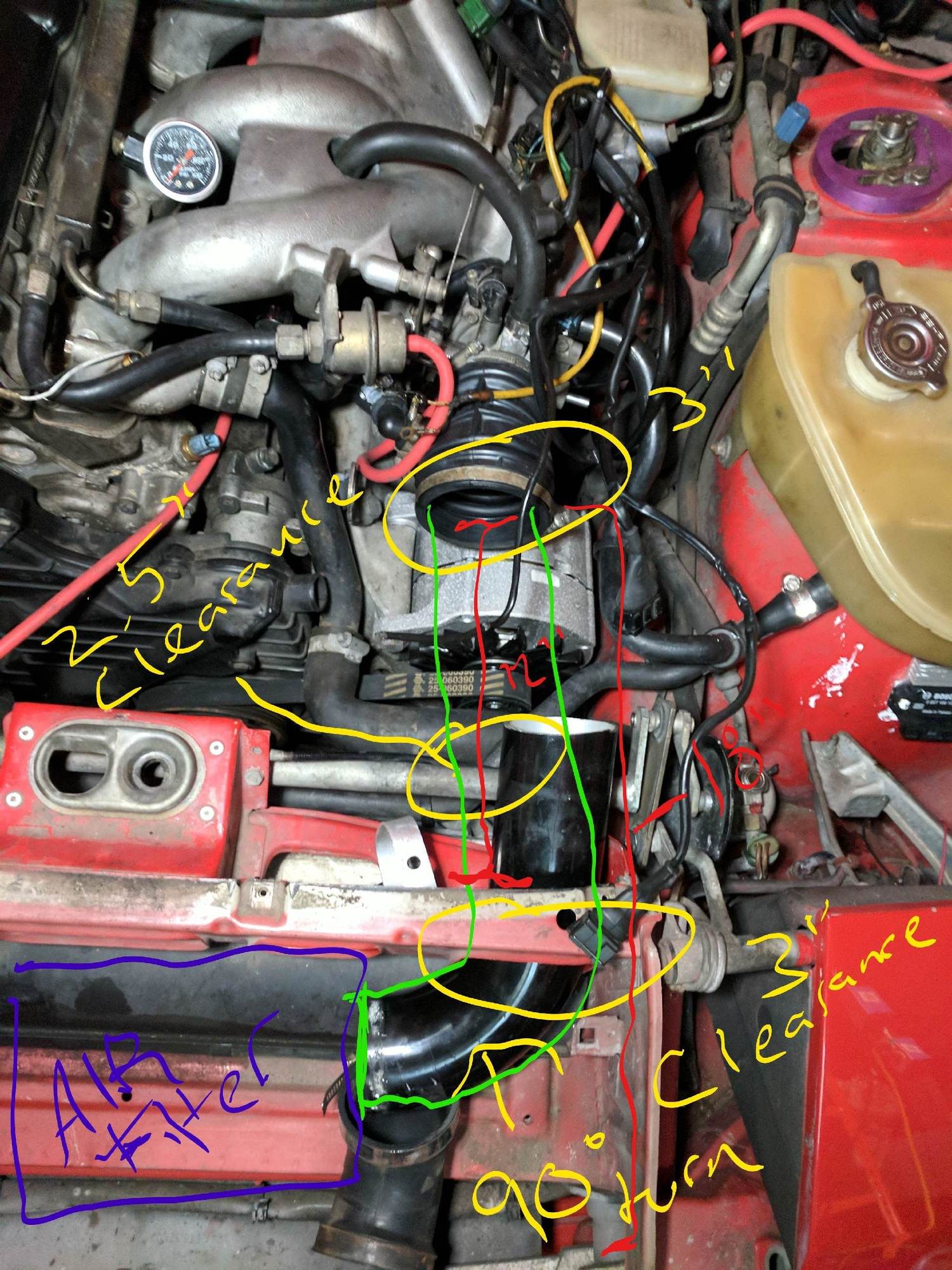

I'm in the middle of this process albeit for different reasons. I had a cone and stock AFM before due to not getting the S2 air box with my s2 motor (did a motor swap years ago). Now I'm switching to a Link ECU so I'm doing a map sensor instead of the AFM. With the Map, I bought a 3" universal intercooler kit off ebay that came with some silicon connectors. I run a pipe with 45* bend out of the throttle body, 5lb sledge hammer to massage the 3" pipe to fit between the hood and headlight bar, the 45* bend takes it right down into the header panel, 90* silicon elbow in the header, short 3" pipe to the air filter. We haven't finished the ecu install yet, so I can't speak to gains/losses, but I didn't have much of a choice.
If I were to do it again, I would only get 1 45* pipe and the 90* elbow to save some money. I knew I was going to do some 'engineering' to get it to work so I purchased a little more
pipe/elbows than I needed.

the setup pictured was from azbanks' car, IIRC, not mine.
all this time and i haven't put it together that you want to move the filter out from under the nose, to somewhere inside the engine bay...
the problem again comes down to the AFM being in the way...you'd have to get an elbow to turn the AFM towards the driver side headlight (or the other direction) to be able to fit a filter there.
Yeah, that was really the question, whether anyone had made something like that fit at all, and what the consequences might be. I was sort of eyeballing the space between the headlight and the coolant tank but it didn't look too promising.
