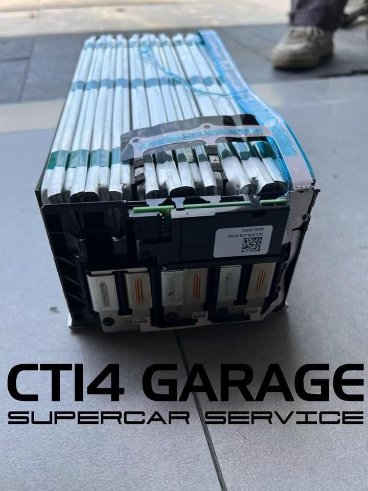

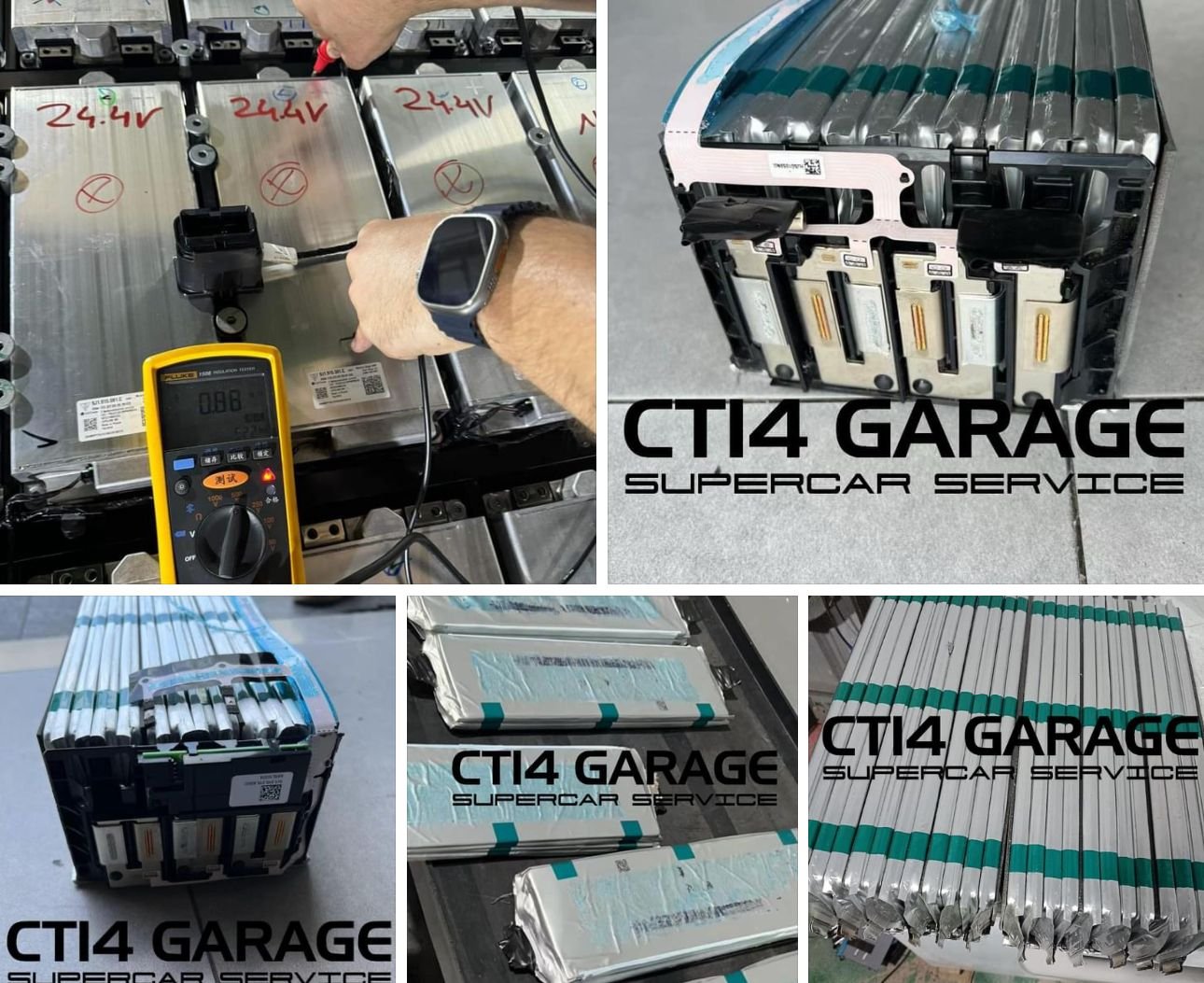

In case anyone was wondering what’s inside any of your Taycan’s battery 33 modules….
It’s 12 pouch cell batteries made by LG!
And they swell too!! Just like your good old Nokia 3310 with a “pregnant” battery.
Except that the only thing to be born from a pregnant Taycan battery cell is a big headache for the owner 🤣🤣
Everytime one of these baddies swells, eventually it will touch the metal casing of the module. Then there will be isolation problems (leaking electricity) and your car won’t go into gear (if the leak is serious enough)
Possible to buy these cells from LG and replace them. As a matter of fact they’re called “LG E66”.
(However replacing individual cells in a module is not easy at all, and in fact it’s extremely dangerous unless you know what you’re doing)
