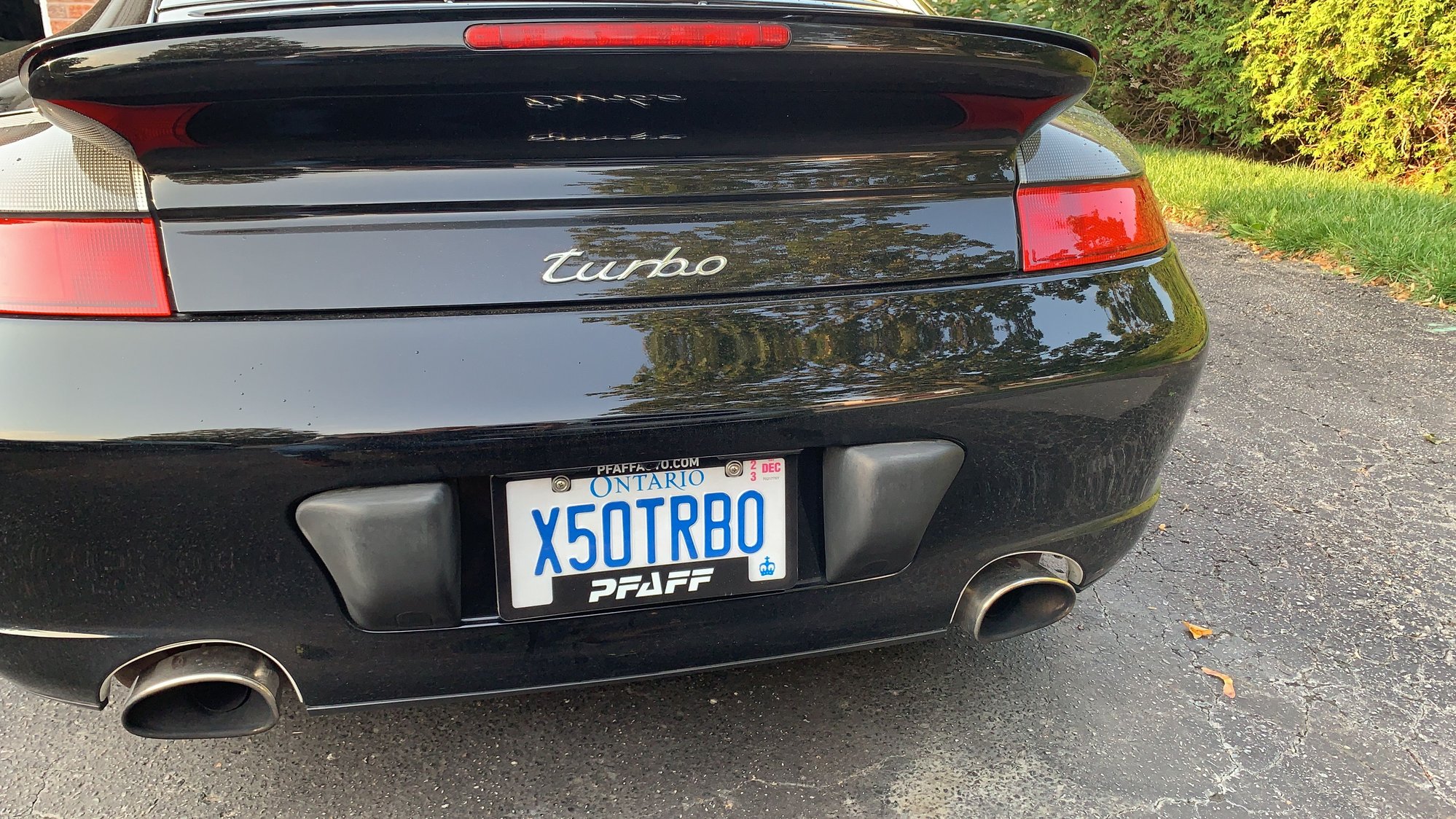

Love your car. I have a 2002 X50 as well. I just got a new plate for the car.
