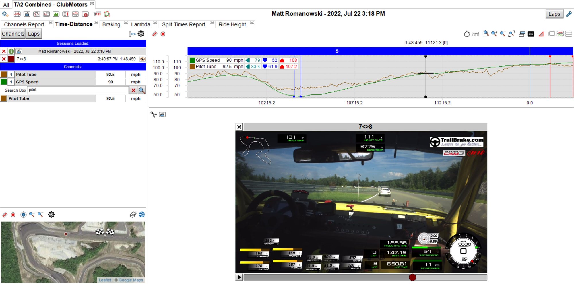

I thought people would find this interesting. I made up an airspeed sensor for my 914 - a pitot tube - and mounted it near the cowl. You can see it center out the windshield.

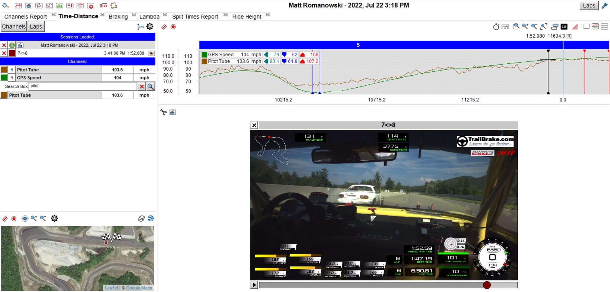

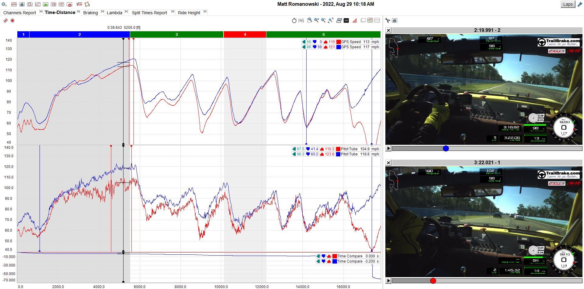

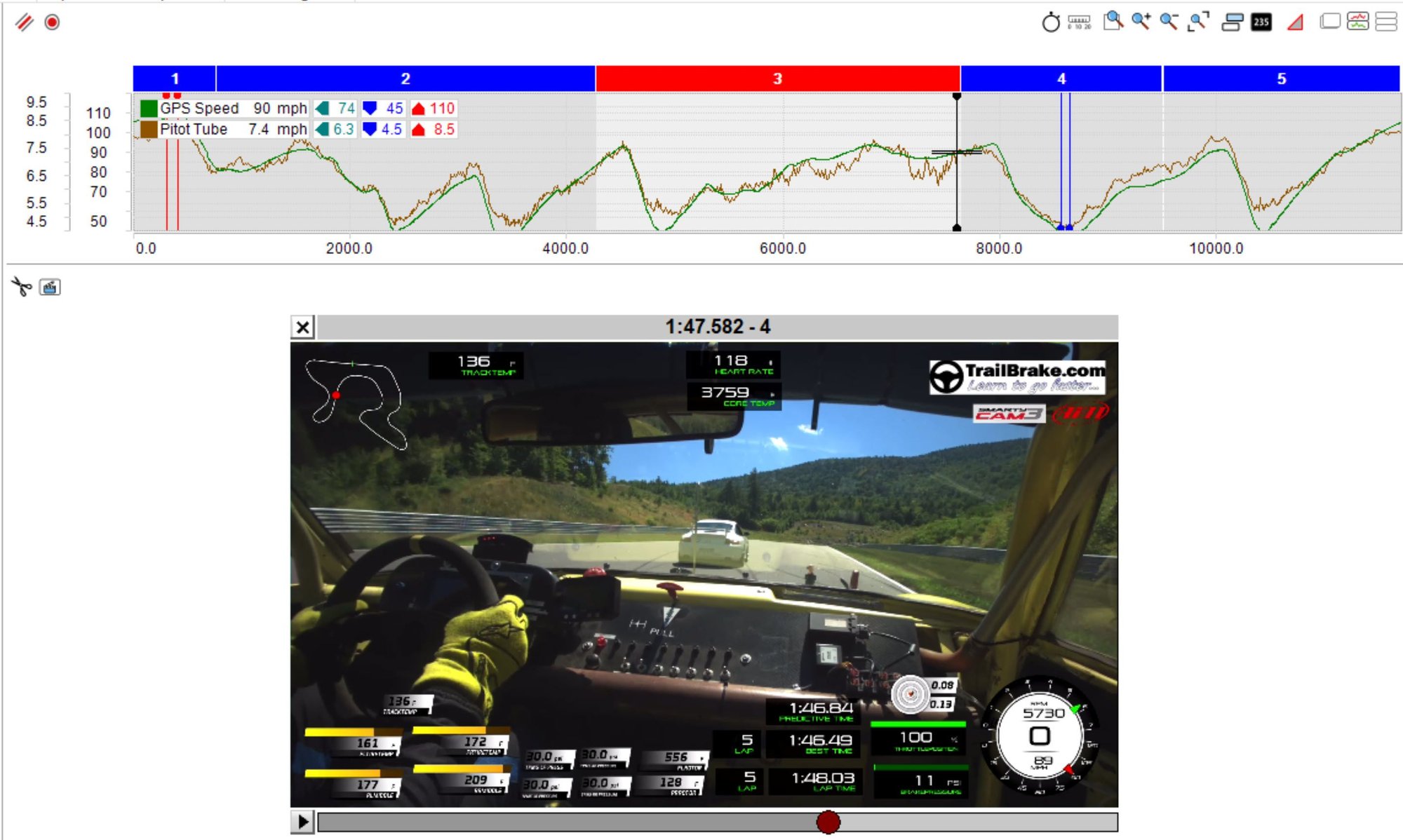

It's been really interesting to see how the airflow changes when you are behind people. You can see the airspeed change - being in the draft. The first photo shows being behind 3 cars down the back straight at Watkins Glen. You can see it shows an airspeed about 7 mph slower than the GPS speed.
The other shots are the start of picking up a draft and when you lose it coming out from behind a car. Sometimes it's surprising how clean or dirty the air is behind some cars. I can look up some data from behind an old racing truck and it creates a giant hole in the air! I guess I should get my son (10 years old) working on the aerodynamics degree he wants....
