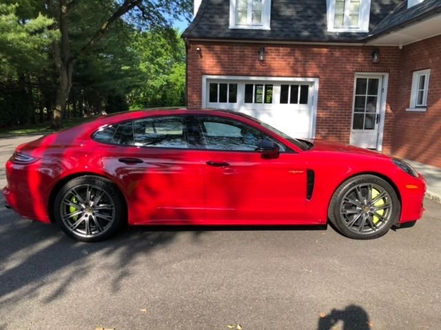

I recently bought a Turbo S, and I have to say that I was really unsure as to whether to get this car or the regular Turbo. I’m so glad I got the hybrid. While the acceleration is bonkers in the car in sport or sport plus, I’ve really enjoyed driving in hybrid and full electric modes. Just with normal driving I’m getting 40 mpg - and that’s with a rip from the green light in hybrid mode! I’m just so pleased with the overall luxury of the car, and the performance even with the extra weight with the battery. You can feel the heaviness, but the car is SO competent even in the bends. I installed a charger with the Porsche dock casing and it looks great and makes it easy to just plug in overnight. Given the current heat wave we are experiencing in the Northeast, my new favorite feature is the pre-cool in the Porsche Connect app. Brilliant!
